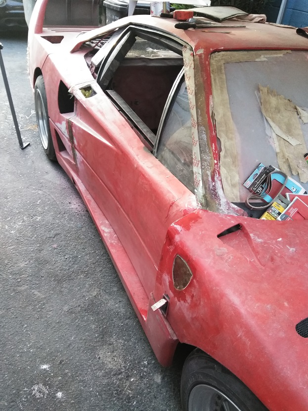

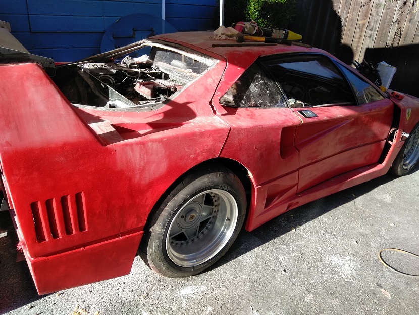

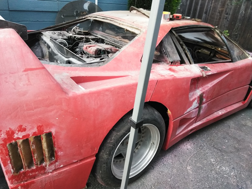

Lookin good folks! Im onto my 10th gallon of fb and 3rd can o bondo! Ill be calling guiness soon! Finished up and painted the window frames, got the ps rear quarter window trimmed, bent and installed. Looks killer. Still fred flinstoning my way around these back scoops, finally got one side pretty damn good.
Bent up the ds side window some more, a lil more and itll slide down the window channels no problemo. Heated n bent the ds front quarter window too. The .25" poly is a real pain to heat up and bend, takes forever w a heat gun n stay too long in one spot it bubbles like crazy. Pulled the driver door n removed the key lock, then fb the center seam I cut when I shortened the doors, filled the handle and key holes
Lil fb left to do on the gaps everywhere, get the windows to roll down, then figure out door/window seals arf arf

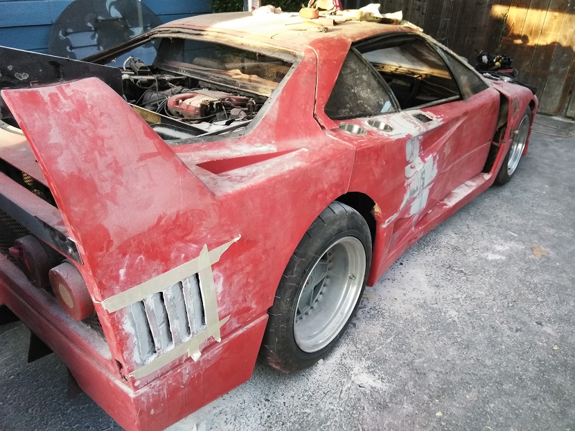

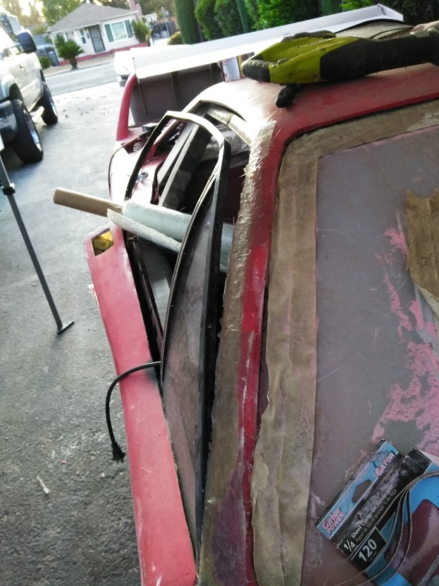

Went to the lake last weekend, havent touched the car till today. Had a lil time to throw some fb at it. The a pillar fb is straight n I have the window frames curved so I had to fill in to match the curve

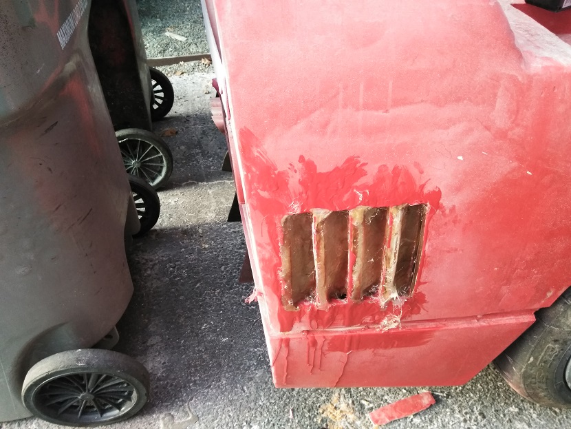

Looking at some pics I found I done did the back vents bass ackwards, so i cut it out n restarted
Still working all the gaps, slow going. Especially when you dont work on it lol
Window bendings giving me hell, that polycarb just doenst spread the heat. Fantasizing about making a makeshift oven
Played w the fiero door seals, I think I can make them work. The bottom half fits great!

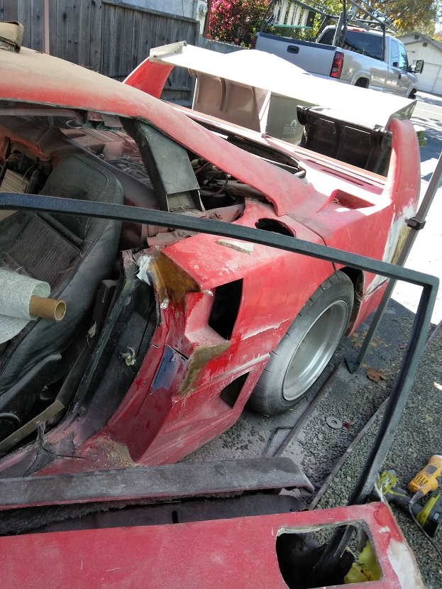

Put another layer on the rear vents and some on the door side to bring it flush w the rear panel. Should have this side wrapped up by the weekend
 Added some fb to the bottom of the a pillar and grooved out the badge area
 Driverside is looking better, should have both wrapped up by the weekend

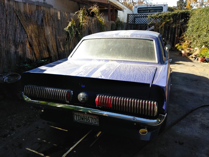

Mustangs paint got some bubbles so its going in for a respray under warranty but I had to take the stripes off. Car looks naked now I really dont like it. Going to have them painted on now

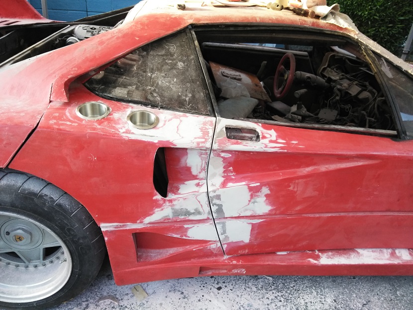

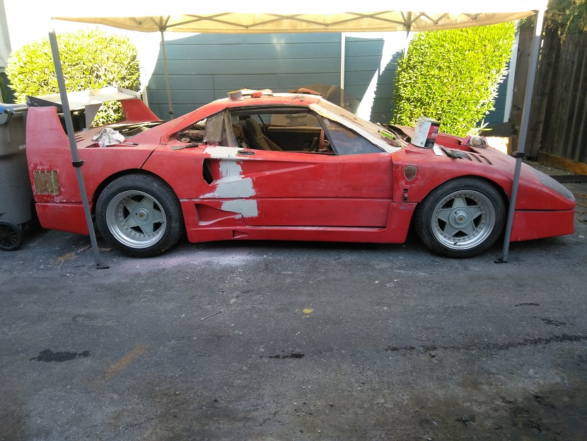

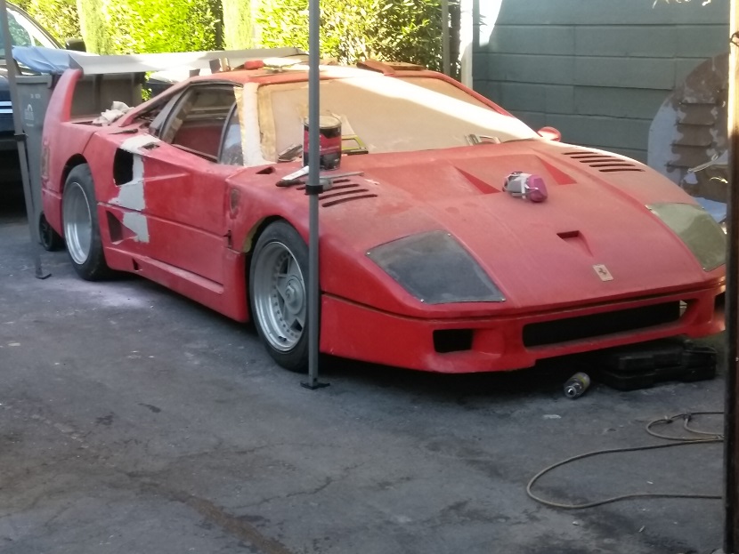

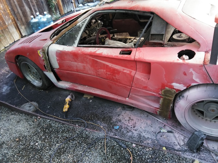

Went to town ta day! Got a lot done snapped some side pics while moving the trailer

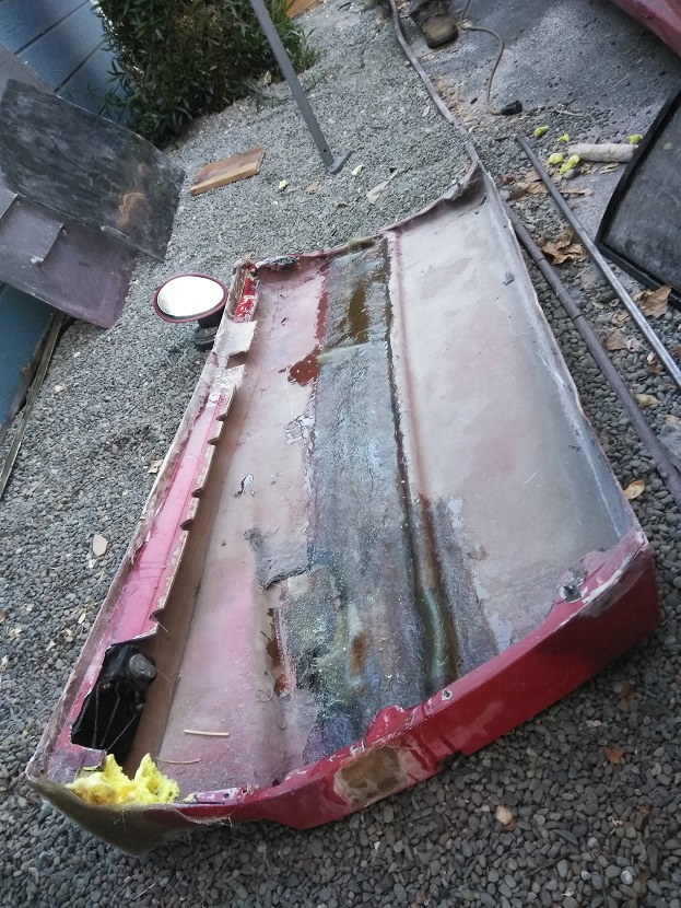

Got the door jambs filled in on both sides, pretty much finished w the ps. heres the in progress shots
The dreaded rear scoops I tied the file I use to hog out the vents to the sawzall blade w some bailing wire. works great
welded 2 old demo blades together for the sawzall to do my door gaps looks good

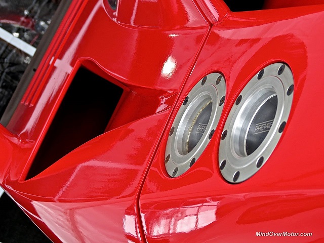

cheese in progress Rickshaw showed up today n brought my cupholders. Installed em they look good supposed to be gas doors or somethin had a pic now its gone
shem

Here it is

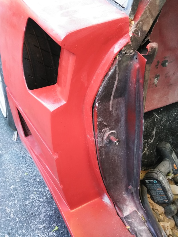

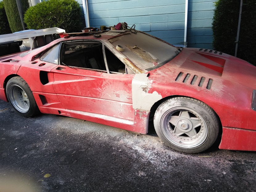

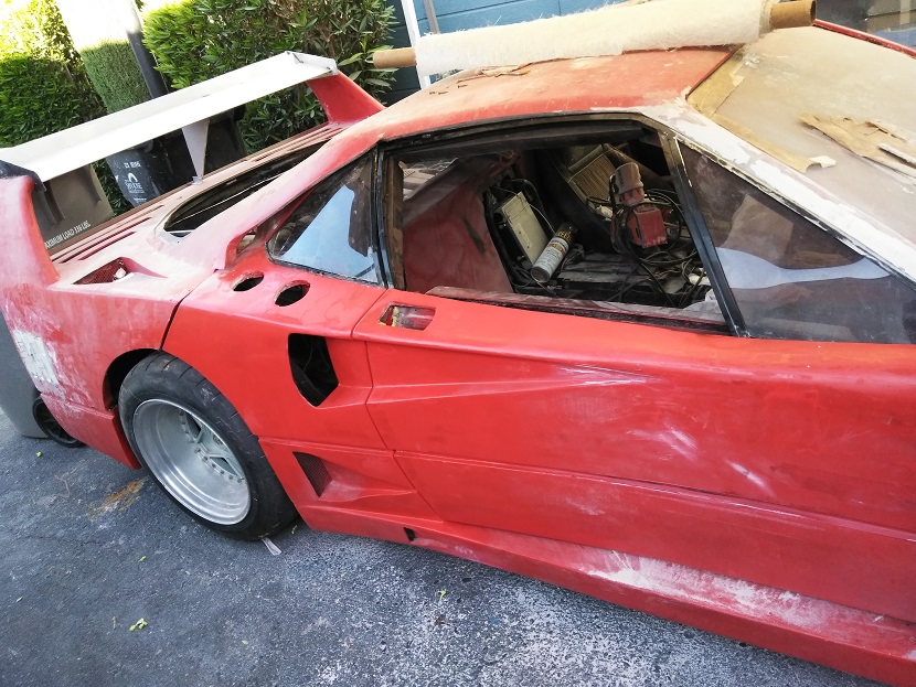

Didnt get any time over the weekend to mess w the car, did a lil tuesday
Jamb on it
Sides almost done, just need a f@#$!%^ window!
almost done w the a pillar, still have to fill the ds a pillar. Ds jambs almost done

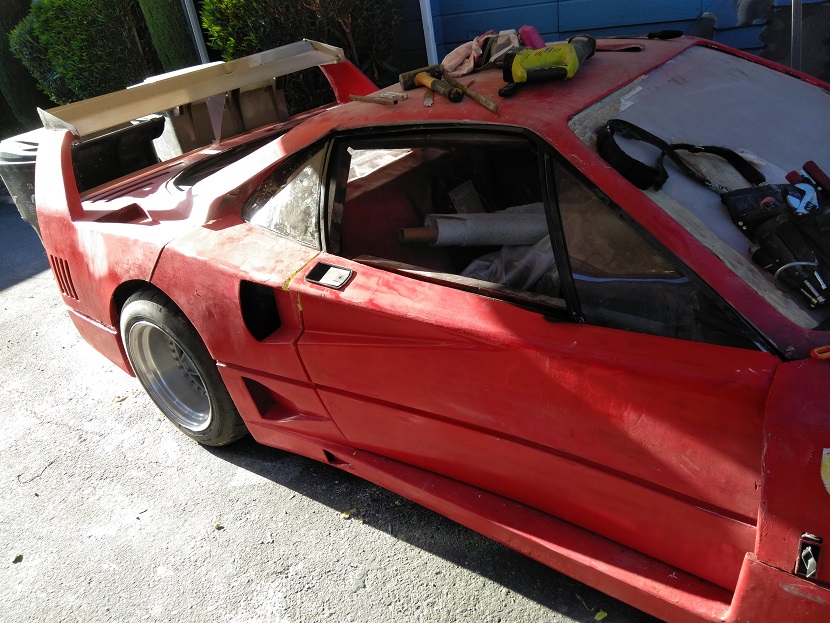

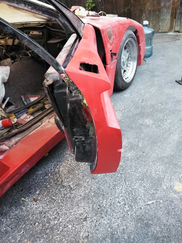

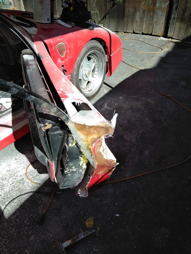

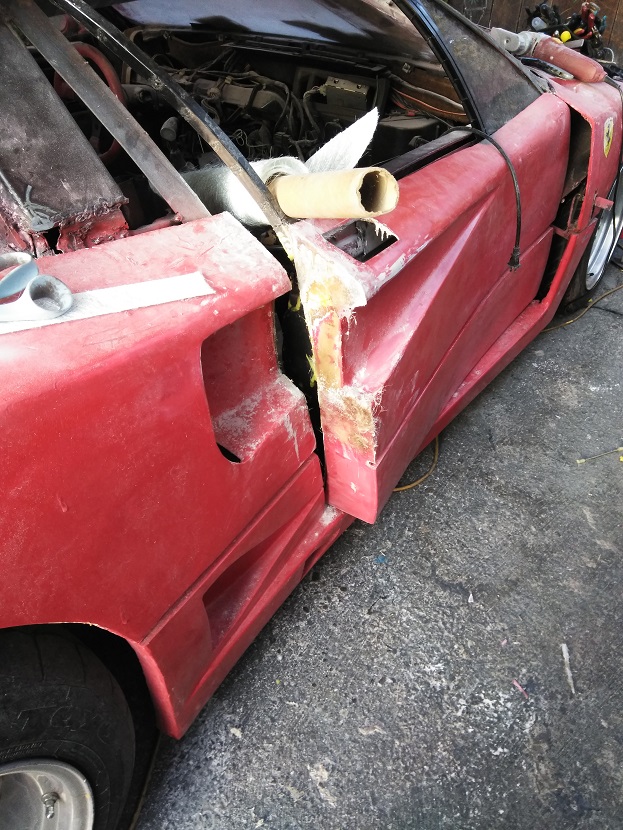

Havent had time to mess w the car, been doing upgrades on the trailer and stripping the mustang for a repaint. The hood likes to sit on the car one way and that way doesnt line up w the rest so I extended the back and trimmed the wheelwell some more
Extended the ds hood also, extended the rear scoop area to be bigger like the other side I did awhile back
almost done w the a-pillars. gearing up for a big welding day to modify the roll bar a smidge lower and fab b-pillars
