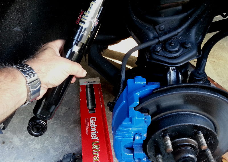

Well I started to tackle the suspension over the weekend, just spent a few hours o n it really. I do plan to do more this upcoming weekend. I have just about everything new for the suspension minus the rear struts.
I changed out the front shocks, and have not even swapped cars around to take it out for a test drive yet! I really want to replace the Tie Rod, the steering stabilizer shock and a couple more things first, so the difference should be quite noticeable. That's the hope anyways!
I have been in older cars before, but man this one just feels terrible. It rattles, the steering is terrible, feeling loose and worn out. Overall, it just feels really old. Looking at the rubber between all the suspension parts shows why. They have all deteriorated, dry rotted and worn out.
I went with Gabriel shocks on the front, and will go with their struts on the rear when I get around to the back of the car.
