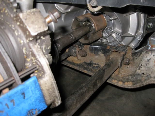

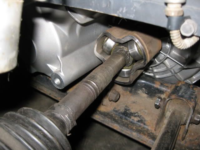

Went ahead and test fitted the DS axle (hybrid tripod housing with 96 corsica axle) and had 7/8" before bottoming out at stock ride height. It should be fine as is, but I may install a 1/8" spacer between the bearing and the CV joint to make it 3/4" so it will match the PS.

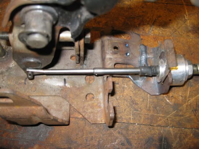

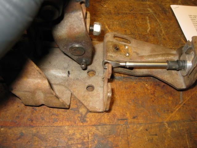

Then it was time to start modifying the shifter. So back to the shelf and pulled off these shifters for parts. Two are 4 speed shifters (with each missing a part from the reverse lockout) and an isuzu.

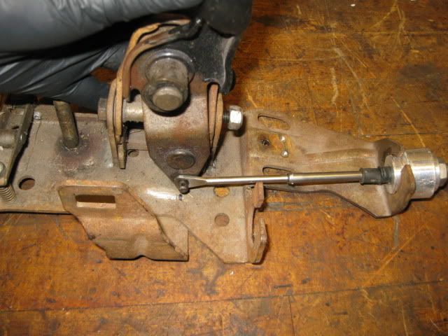

Tore one of the 4 speed shifters down and then installed my isuzu shifter lever and the old getrag select cable. With the cable in the stock 4 speed bracket, the shifter has very limited range. The first picture is with the cable fully extended and the 2nd one is with the shifter at is full range... there is about 1 5/8 gap:
Going the other way with the cable fully collapsed vs. the shifter results in a 1" gap:

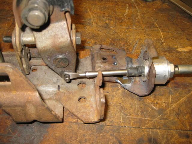

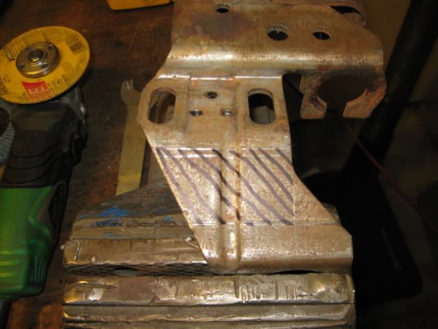

So the cable bracket needs to be moved forward. Anywhere between 1" and 1 5/8" probably would work, but I chose 1 5/16" to keep everything centered - that way I could build up the shifter stops to reduce cable abuse. Here is where I marked the section to remove:

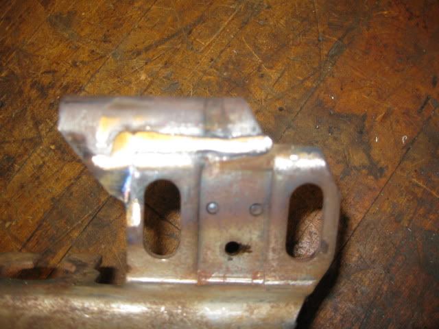

And welded back up with a range of motion checks:

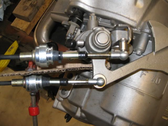

My new Rodney Getrag Select cables showed up yesterday. With a 10 second mod I was able to increase the travel from 1 3/4" to 2"... so no worries about range of motion for the Getrag select cable used as the F40 shift cable. Now I need to work on the select side and work on the cable mounting brackets at the transmission.

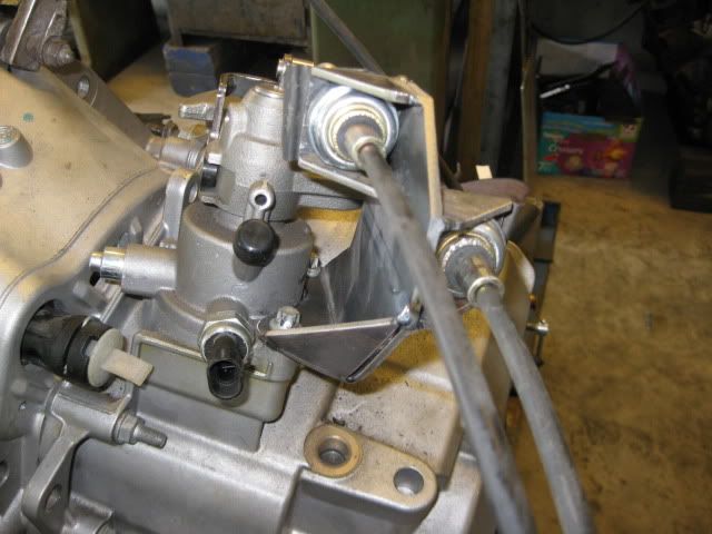

The shifter work is pretty much done. Just need to test fit in the chassis with the cables routed as they will be just to make sure everything is positioned right, then I can do all the finish welding on the bracket.
I started out with two Getrag select cables from Rodney Dickman. The cable that will become the shift cable was modified slightly to increase its stroke. Just took a tubing cutter and removed about 3/8" from the inner sleeve:

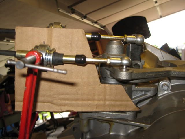

Then a card board mockup to get the general size/shape of the bracket and the approximate cable positions:
Transfer the card board pattern to some 1/8" steel, bent to shape and then use some 1 1/2" square stock, drilled some 1" holes for the cables (need to enlarge slightly more than 1") and then cut then into wedges. The round bodies of the cable ends needed about 1/8" removed (flattened so they would fit within the tubes). Then tack it all together and cut off the excess:
