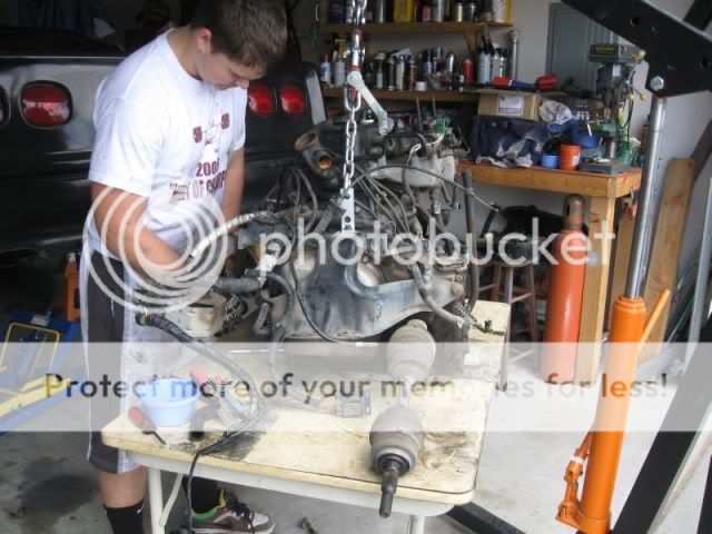

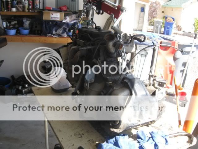

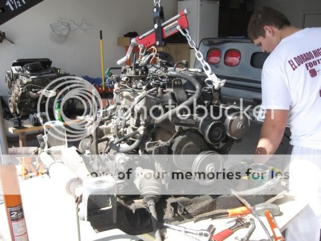

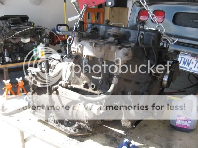

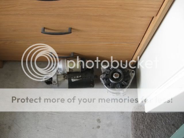

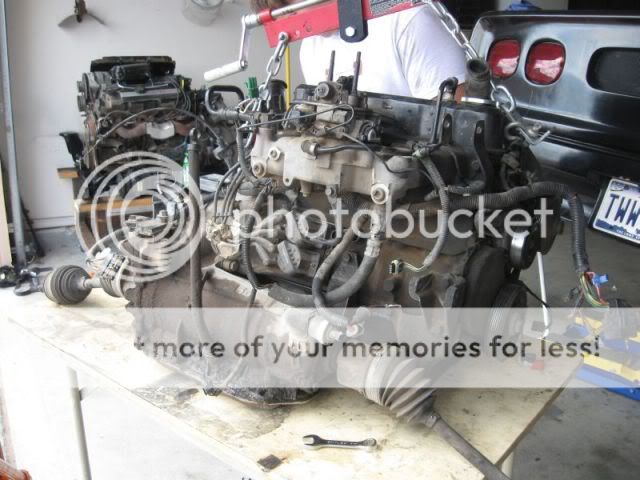

Got a lot done today. We got the Duke drug out and stripped down. I forgot how many new parts I had installed on the old girl. I'll be posting a bunch up in the Mall in a week or so. After we stripped the motor and removed it from the cradle, we tossed it in the trailer and hauled it off to the junkyard - even tossed out an old 2.8 that has been in my way since the "Ol Yeller" days. I just wanted to drop em off but I ended up getting 150.00 in credit at the Mega Pull. That will help with some more odds and ends that we will need to finish the swap.
Stripping off all the goodies:
Engine/trans off the cradle:
I now have a 88 cradle to swap into my V8 Coupe:
Stripped and ready for the junk yard:
I put a breaker bar with socket on the crank bolt and then a long pipe and tried to turn the motor - I ended up rolling over on the bench - she is seized up tight.

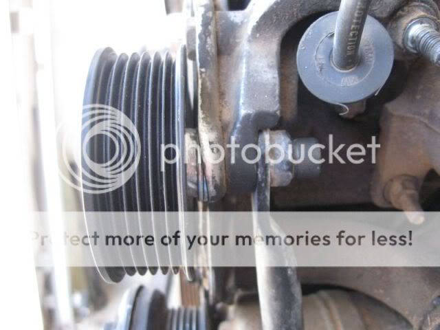

New - rebuilt V5 AC compressor with new Hi and Low pressure switches and the R13 control valve has about 1000k on it:
New - rebuilt AZ lifetime warranty alternator and starter with 1000K on them:

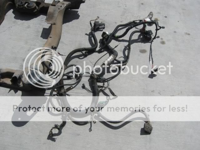

88 2.5 complete wiring harness:
I'll put these up in the mall next weekend. If someone reading this thread want s something, leave me a PM. I'll be out of town all next week. Make me an offer! More next weekend.

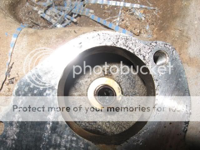

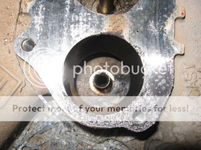

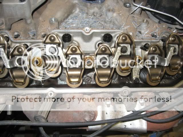

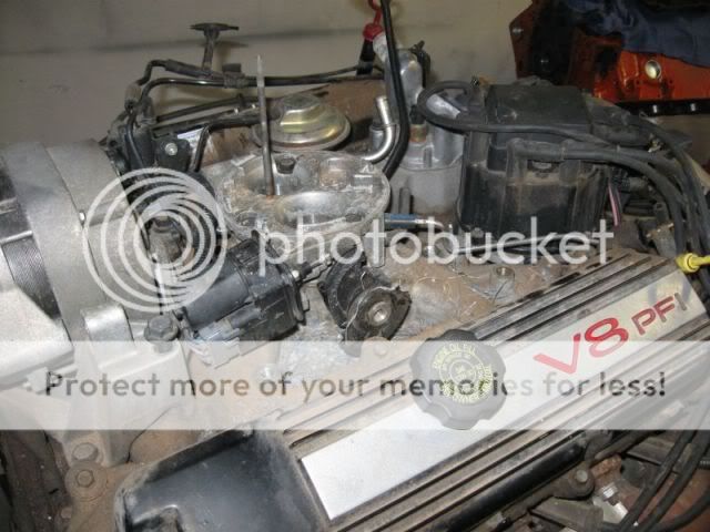

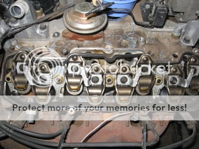

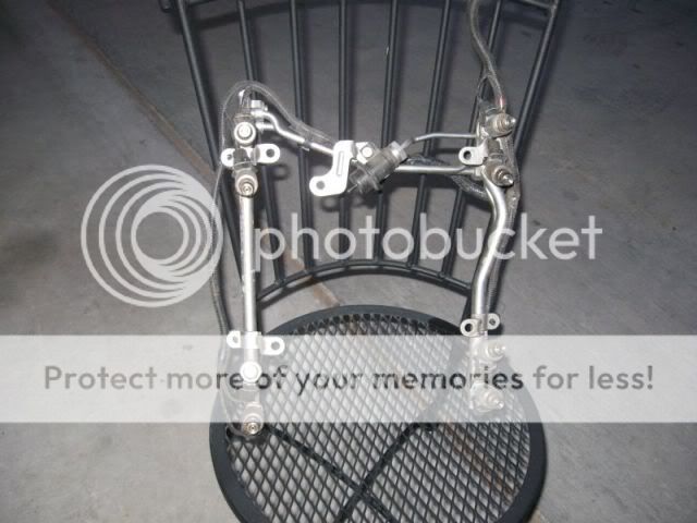

Well after a dreery week in Houston, I made it home around 12:00 noon today and was able to tinker with the 4.9 some. I pulled the injectors so I can send them in for some cleaning and service. I was planning on doing this myslef but I just do not have the time right now - got to get this done. Anyway, I also pulled the TB for some cleaning and removed the valve covers to replace the gaskets and install one with an oil fill on the back side/front side? I was pretty happy with how clean the valve train is. Looks like this motor was well cared for.
I was going to try and adapt the 4 cyl AC pump to the 4.9 but have decided that I will just get a stock Caddy AC pump and be done with it. Again, time is critical now. Tomorrow I have to go to the Mega Pull and get the rear AC pump mounting bracket and we can get the tensioner pully and belt all finished up. I am hoping I can stuff it in the car tomorrow afternoon for a test fit.
When I pulled the TB, I noticed that there is some crud built up inside these "tubes" in the intake - not a clue what they are? Maybe part of the EGR setup - looks like EGR gunk. I'll see if I can clean them out some.
Clean valve train!
Injectors out:
Got to replace this valve cover with one that has an oil fill hole:

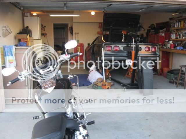

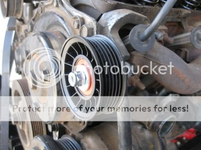

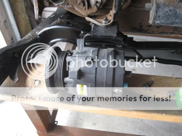

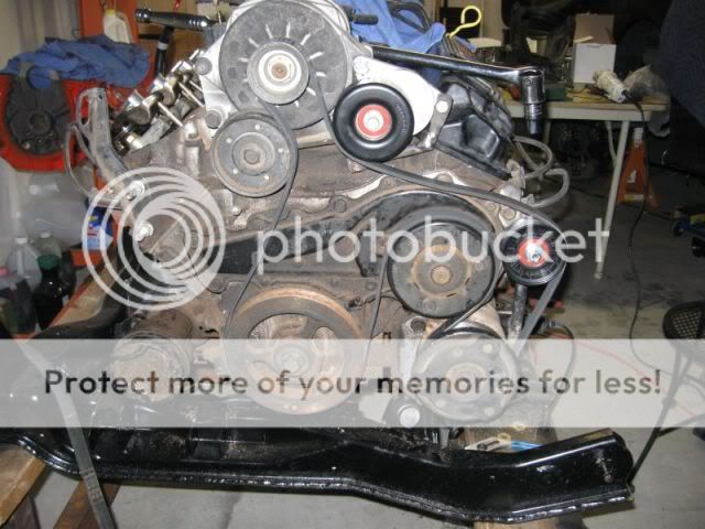

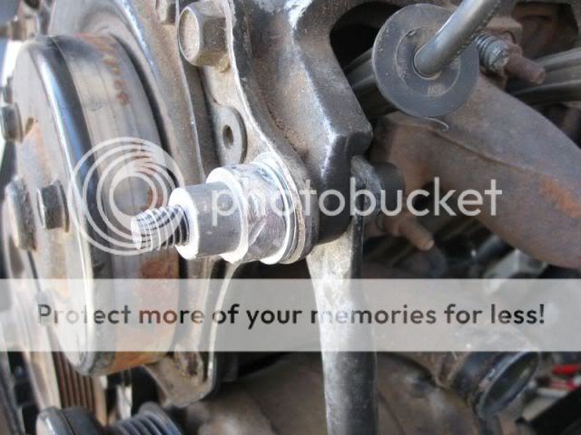

First thing this AM, we went to the mega pull for some Caddy AC pump brackets...... After roaming around, we found a good donor and got what we needed. I will buy a new pump but we picked up one from that yard for now - to get all the pulleys setup and the belt on. We got out of the junk yard for 25.00.
I ran all over town looking for the 3.4 Camaro tensioner and the idler pulley. I had to ride my motorcylce cause it was so nice outside here today. It really was hard on me!
Fun in the junk yard:

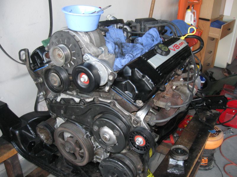

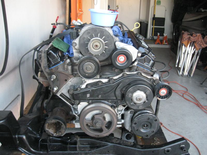

Fabbed up the idler mount:
All the brackets fabbed up and the belt is in place: Only issue is that I have the wrong belt - it's too long. I'll get the right one in the AM.

Sent the injectors off to Mr Injector for cleaning and service yesterday. I picked up another belt - ended up with the AZ 798K6. It was a tight fit but it does fit. I handed the boy a wire brush and instructed hm to clean all the rust off the pulleys. He was still out there in the garage at 11:00 last night. He got a wild hair and went to cleaning the motor. He did a great job of cleaning the motor and making a huge mess in the garage. I do not think the stains will ever come out of the concrete...... Gives me a good excuse to go buy that pressure washer I have been wanting.

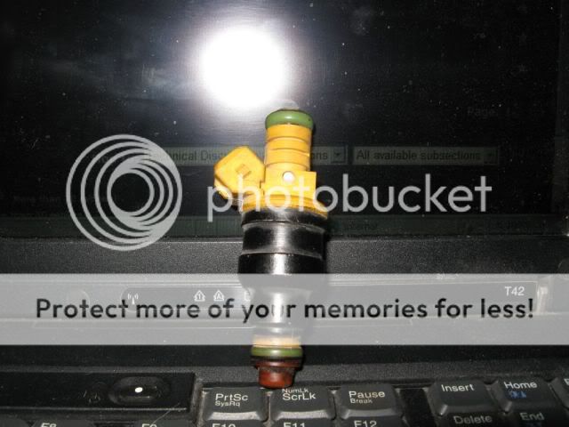

OK so if you have not already read my posts in chat and tech, I sent my injectors to Mr. Injector for cleaning and service on Monday. I got an email today from Bill at MI informing me that he received the box but there were no injectors inside. Looks like the box got crushed, the injectors fell out and someone along the way taped the box back up. I filed a claim with UPS and they had a declared value of 250.00 so hoefully I'll recover some of the costs to replace them.
Bill at MI was very helpful and is a great guy to deal with. He told me that the OEM 4.9 injectors are prone to problems with the windings and he suggested that I replace them with some OEM Ford 4.6, 5.0 and 5.4 injectors. I did some searching and found that this is a common replacement for many GM 19 lb injectors and the Bosch injectors are more efficient. I went to the Mega Pull this afternoon to recon some Ford injectors and found a rather large supply of them for fairly cheap. I alos found refurbished ones on E Bay for 100 plus shipping - this is a pretty good deal as it will cost 130 plus shipping to get the stock ones cleaned and serviced. Just beofre I pushed the "buy it now" button, I checked my email again and had another form Bill at MI. He said that he would sell me a set of the Bosch for 225.00 but he did nothave any at this time. I sent him one back telling him that I had a source for cores and then he sent one back telling me that if I send him 3 sets, he will send me back one set refurbished - I just pay for shipping to and from. Sounds like a good deal to me so tomorrow I will be knee deep in the Ford section at the Mega Pull gathering up injectors.
For future reference, here are some part numbers for the Ford OEM 19lb High Impedence injectors:
OEM Part Nmuber: 028150943. These are made by Bosch for Ford and are the Series type 2. They have a yellow top and if you look closely at the pintle end, you will see 4 small holes. These are the prefered injectors.
Some more info:
Other OEM partnumbers that cross with the above: 028150939, 766 and 788. The Bosch aftermarket replacement part number is: 0280150973
Here's a pic of the injecor I picked today for reference:
