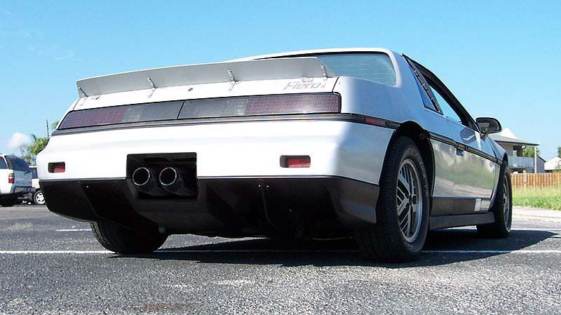

| quote | Originally posted by bmwguru: I just cut the stock exhaust off the Jetta at the cat and bolted it up as a joke.
That's really cool though. Center exhaust ^_^ . Does that mean that the stock exhaust pipe clears easily under the stock trunk?
In that case, with a 90* bend the catalytic converter could be mounted "within the same distance as on the donor car", meaning it could theoretically be California emissions legal.
Could you take a picture from underneath the car to show clearances, when you get a chance? ( with the exhaust pipe installed) - front of cradle (where the stock Fiero cat would be) - and back of cradle near trunk)

I did cut the trunk, but that is for the turbo (phase II of this swap). I did measure and a center exhaust would be cool, but I'd need a custom rear bumper to make it look right. So, if anyone has ideas for that, let me know. I will be running magnaflow mufflers and no cat. I started making the gas pedal mount, but the weather is so nice up here that I had to take a break and enjoy the 70 degree sunny days while they are here. This week, I'll be progressing on the interior wiring and shifter mods...with pics. Dave
I did measure and a center exhaust would be cool, but I'd need a custom rear bumper to make it look right. So, if anyone has ideas for that, let me know. Dave |
bmwguru
MAY 24, 08:46 PM
looks very cool, but I need a license plate.
FieroWannaBe
MAY 24, 09:44 PM
looks very cool, but I need a license plate. |
put it to the side next to the cutout, no biggie.

| quote | Originally posted by FieroWannaBe:
put it to the side next to the cutout, no biggie. |
Put some really strong magnets on the back of the bumper and on your plate, then you could just stick it on and pull it off. Might be a PITA if you plan on driving it around town because of theft, but glue some screw heads onto it and people might think it is attached.------------------ 88 Fiero Formula V6 auto 99 Kawasaki Ninja ZX-6R 99 Nissan Sentra 1.6L 5speed
