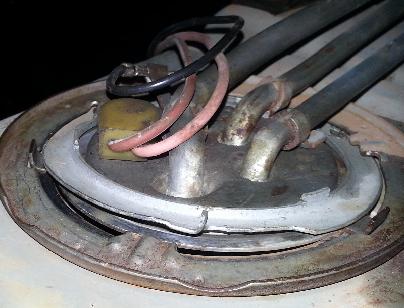

Mean while, I had my mechanic, Frank, , the one that replaced the fuel pump for me a few months back come over. We drained the tank into two 5 gallon containers, and about a gallon into a drain pan. So the tank was indeed full after all. As soon as he dropped the tank, I could see EXACTLY where the fuel leak was when I filled it up:
As you can see, the ring had not been tightened correctly when the fuel pump was put in place. Frank apologized, and said he was very sorry, but was sure that he had tightened that ring. Which makes sense, as how could you not notice it like that when putting the tank back. Who knows, stuff happens.
So that's where the leak was, now how was it "running out of gas" with a full tank?! After looking at the rubber hoses in the tank, one of them was pretty soft and deteriorated. He said it was probably sucking air around the outer core of the hose. A quick trip to the parts store, and all hoses inside and out side the tank were replaced.

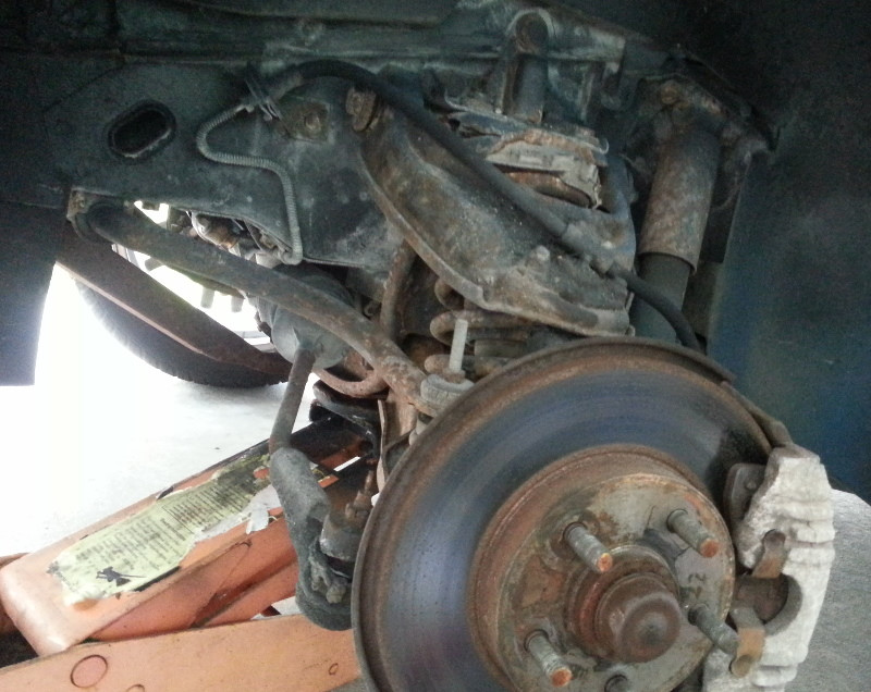

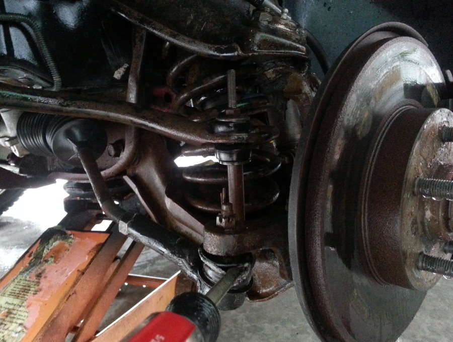

I started to work on the wheel wells today. I figured I would wire brush everything and hit it with Rustoleum, do the wheel well liners with spray on bed liner material, and paint the brake calipers. I started with the front left, and with the wheel off, you can clearly see that the Tie Rod / Control Arm is severely bent. I know NOTHING about suspension, so it was actually pointed out to me when I posted a suspension question in the tech forum. There is more discussion over there has to how to fix, and how it could have gotten bent so badly. Here is what it looks like:

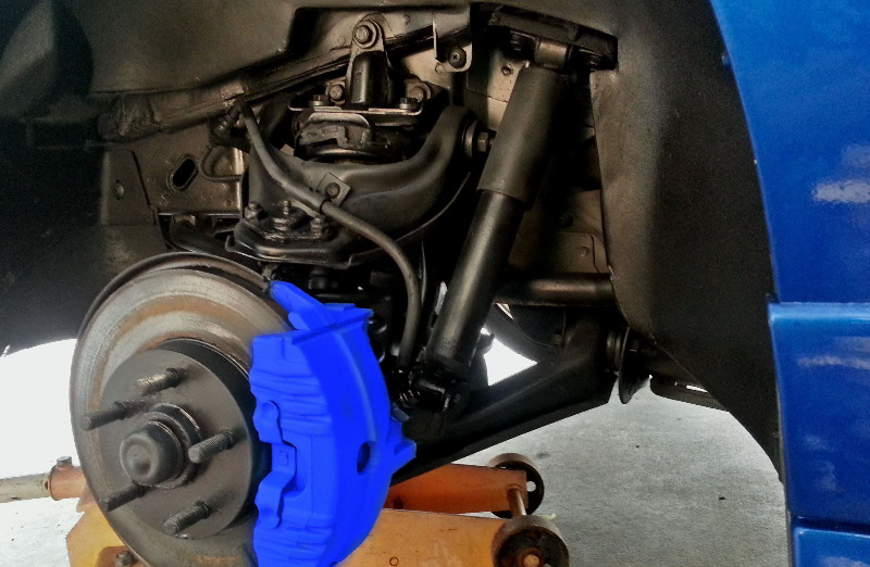

I then let it dry and then painted the area with the high temperature caliper paint, and then the bed liner on the wheel wells. I didn't really have to mask anything off for the black. When it came to the blue, I started to mask things off that I had just painted black. I wasn't about to go to the trouble of removing the brake calipers just to paint them blue
I did not worry about what the shocks look like, as I will be replacing them with new ones very soon. Starting to look pretty good. Not the perfect shade of blue I wanted, but there are not too many choices when it comes to high temperature caliper paint:

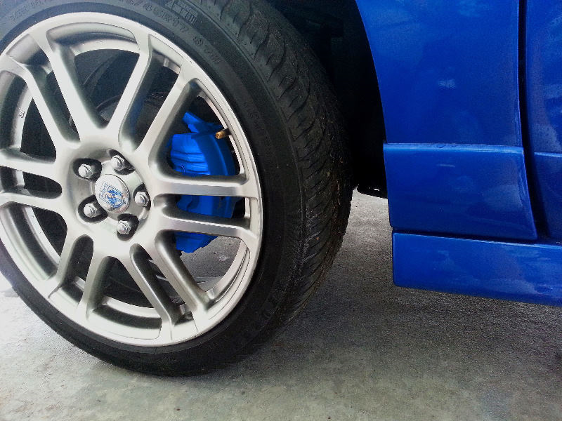

After it dried a bit, I put the wheel back on. One down, 3 to go!
