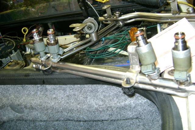

I went outside and checked all 8 of the injectors I was planning on using. One of the two new ones that I had cleaned up yesterday evening would only back flush. It would not work top to bottom. I had to replace that one with a different one. I ran it threw the cleaner for an hour before installing it in the fuel rails. Oh, and I did trest it again before install.
Do not assume the injectors will work. Always test before installing

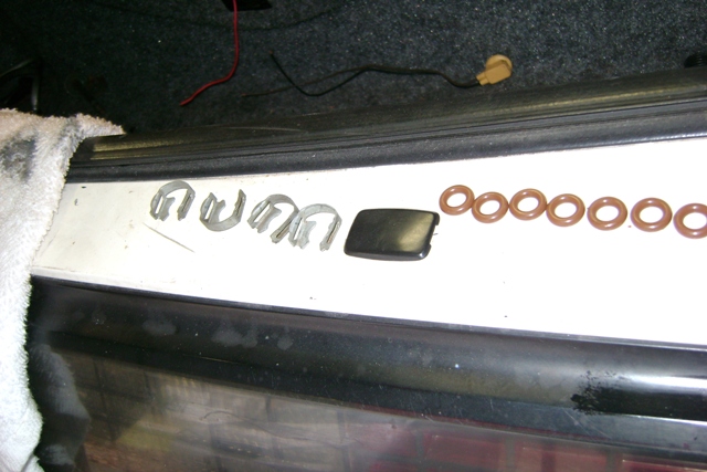

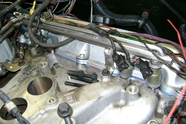

I replaced the injectors and the fuel rails today. Cleaned the clips and lined up the O rings. I used 5W 20 motor oil on the O rings, and in the intake holes where the injectors go.
O rings and clips on the injectors, and on the rails. Index the connectors to where you want them pointing before torquing down the six hold down bolts
And back on the intake. It only took half of the effort to seat the injectors as it did to pull them up. Real easy to do

I added this same information on my 4.9 injector servicing thread.

Fieroseverywhere DEC 07, 05:58 PM
Those look purdy! They sure do shine up nice.
josef644 DEC 07, 06:29 PM
In the center picture, the two injectors on the far left are two that Dean sent me. The metal band was made out of a different metal than the rest of all the injectors I had here. They didn't shine up like the rest did. They did spray real nicely though.
