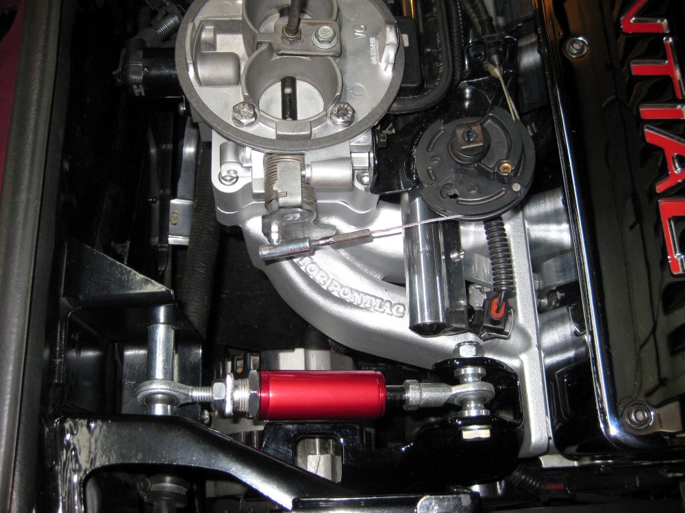

curious to see how you make that last bend with the throttle cable- re-using the bellcrank from previous iteration?
Yes. It will be the easiest solution and I can use the cables I have.
The TB's bracket would bring the cables over the valve cover (ugly).
And the current cables don't fit the Dodge bracket holes.
Pretty close now.
