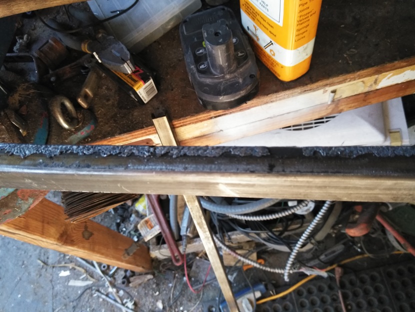

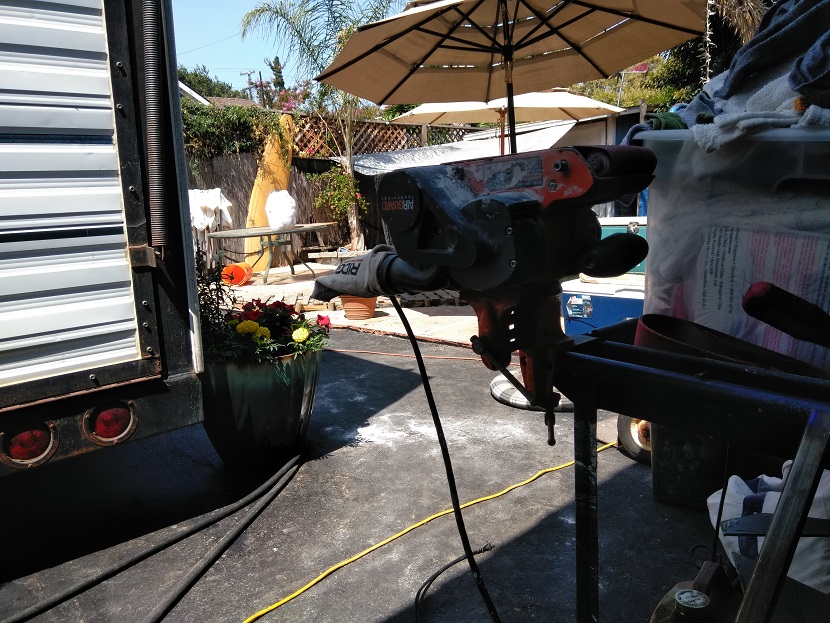

Got my metal cut up for the window frames. Ate a brand new $50 band saw blade in less than 10 mins on 3.5 pieces so the plasma was the only other option than doing it w a cutting disc or 6" ata time on the vertical mill. Came out like **** , uneven, warped, and not smooth, tons o divots on the finished edge, and an assload o slag
took the slag off w a hammer n chisel, rigged a cool way to sand everything tho lol
that works so damn good! Good news is 1/4" windows slide easily in the rubber in the channel

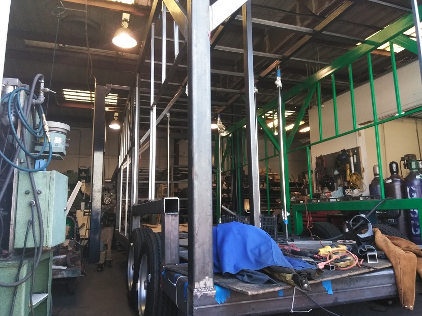

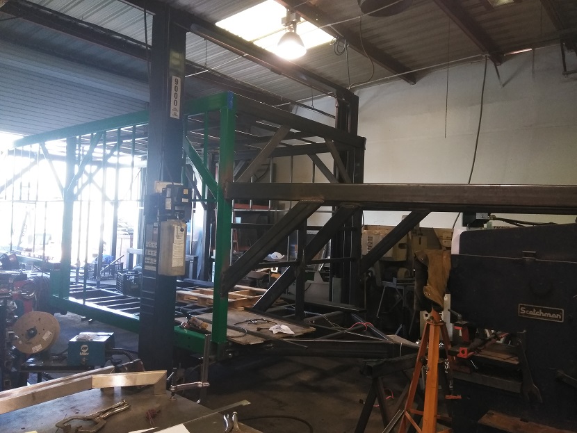

Havent been at the shop for awhile. One o the battlebots guys is making a trailer for burning man. Every year theyre makin some crazy shite. This things going to be a walking gecko with 6 strippers on poles in the middle. Its sad these guys have so much money. that trailers f@cking yuuge.

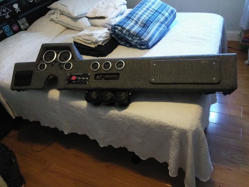

made the binnacle w gauges. looks uber cheese. will work for now

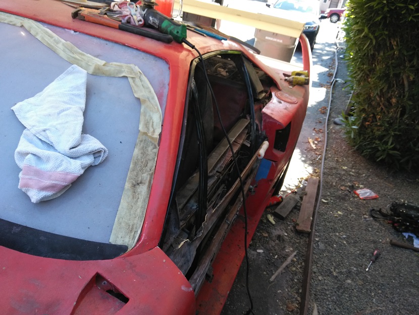

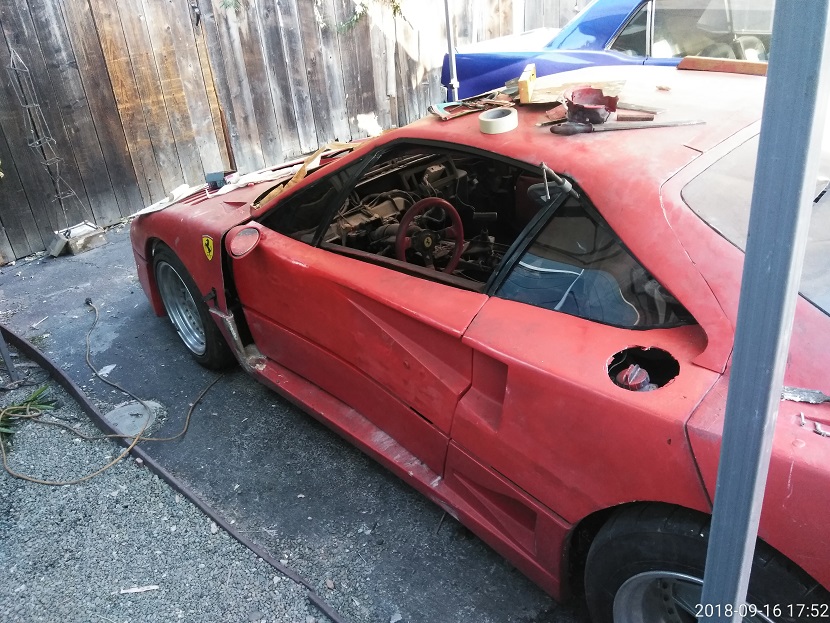

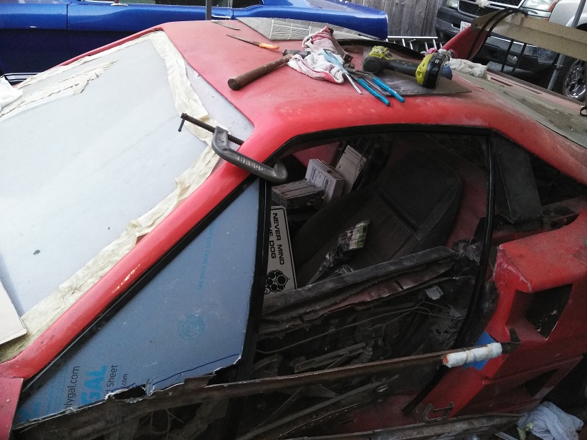

Gave up on waiting for my buddy to get me a gas tank n bought some flux core wire. Cleaned up all the pieces and started welding stuff in place to test. Was outta cutting discs, used some used ones down to the nub. One got buried in my finger. Playing w the sizes of the windows, deciding which looks best on this car. The slope o the fieruh roof is much longer than the real car so the front windows coming out too big. Im finkin o mounting the side mirror there so its not so obviously yuuuge. This was attempt 1
No time to take the car to the shop so i bent up the side frames on my vice w a big ass piece o pipe. Got a nice curve in there and the window should slide good
Heres the back window frame
hit tap today n got winduhs, bent up one back window w the heat gun. Lil bondo on the frame n paint n this winduhs dunn. How ima get it in the frame- i dunno

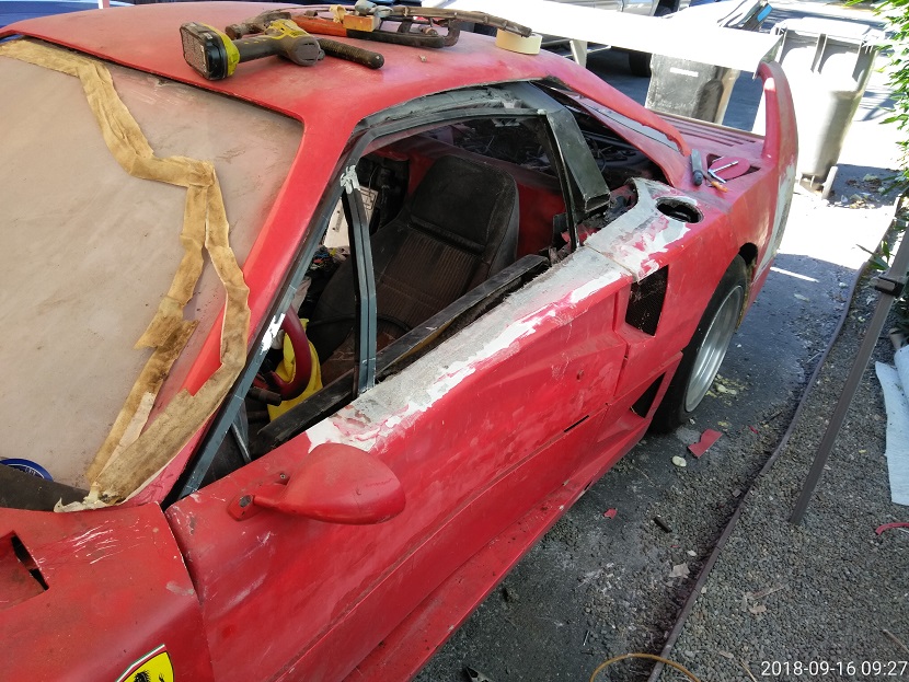

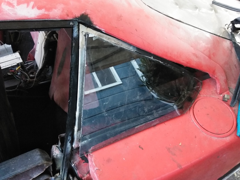

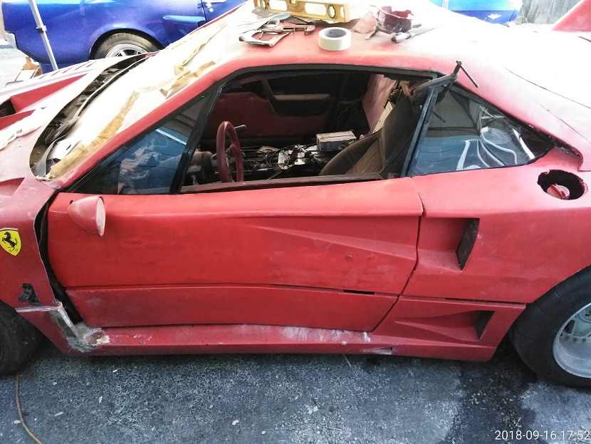

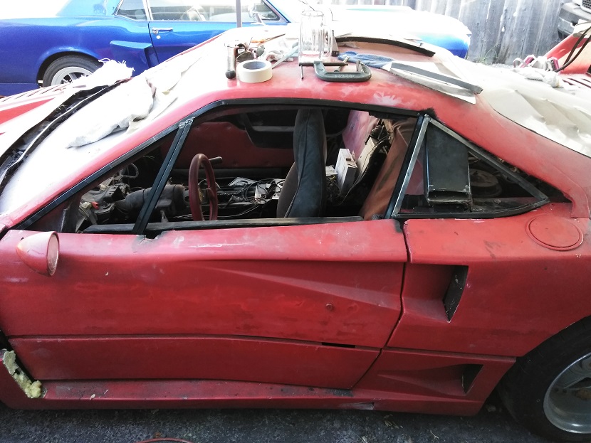

Been poking w the windows some more this weekend, got the rear window size finalized and finished. Laid some more glass on the upper door and the area going towards the back of the car.
its been really nice not doing any sanding for awhile.
Upper door curve got cleaned up, and windows lined up
Extended the rear window area going back and up to the window frame. All window frames welded up

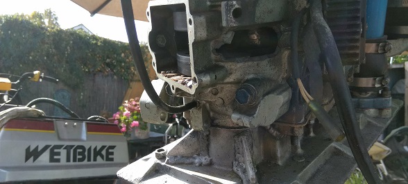

No time for the car but I did get a set of ferrari 308 door handles. Going to the lake and had to swap 2 motors in the bikes. Found my low compression issue lol
