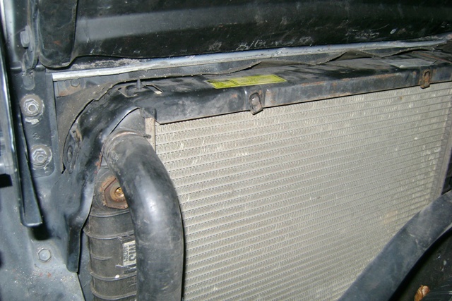

Installed one V6 automatic radiator.

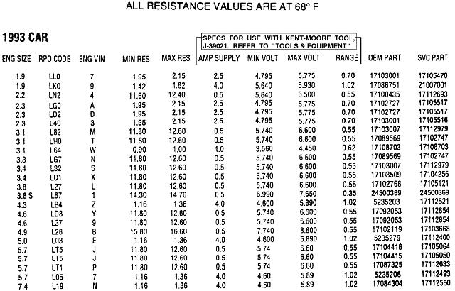

And just for information:

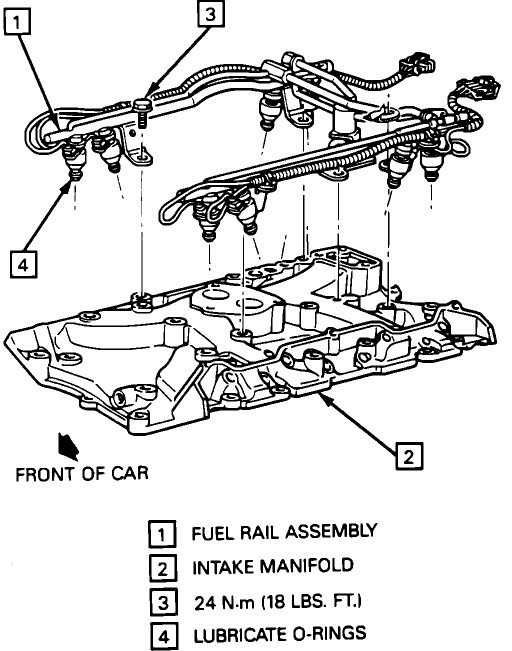

Just for information. This also fits other GM:
and, but the arrow pointing to the front of the car is incorrect

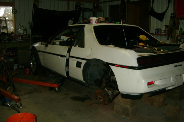

Sure thing, but not much to see that has changed since the last ones I posted:
This shot shows the upper static Fiero storage area:

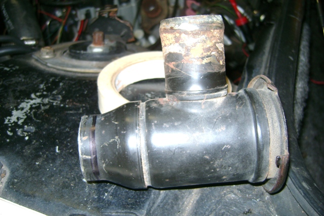

Gen u wine fierocarparts radiator installed two night ago:
Gen u wine fierocarparts 2.5 thermostat neck cut off and prepped for welding on the Caddie thermostat housing:
