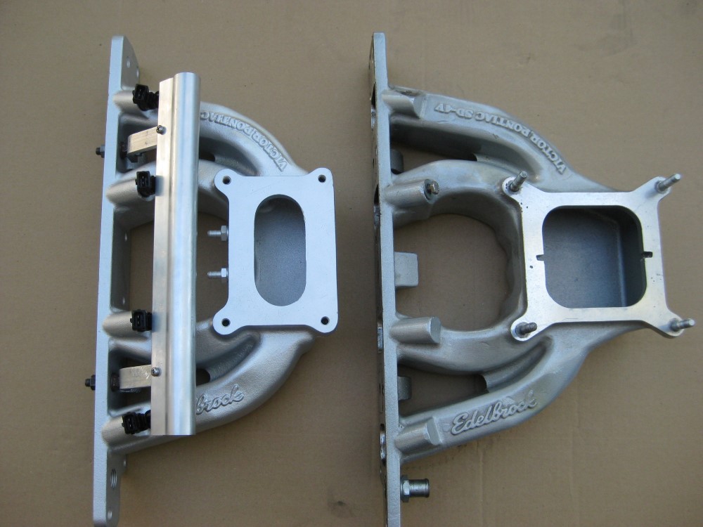

Have to get ends of fuel rail bored/tapped for ORB (O-Ring Boss) fuel fittings.
Then bead blast and powder coat intake, adapter/spacer, alt/dogbone mount and throttle bracket.
The Edelbrock manifold was intended for mechanical fuel injection nozzles of that time.
This arrangement could not possibly fit without the new compact Bosch EV14 EFI injectors available today.

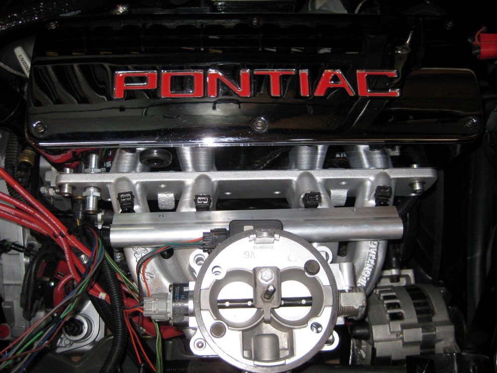

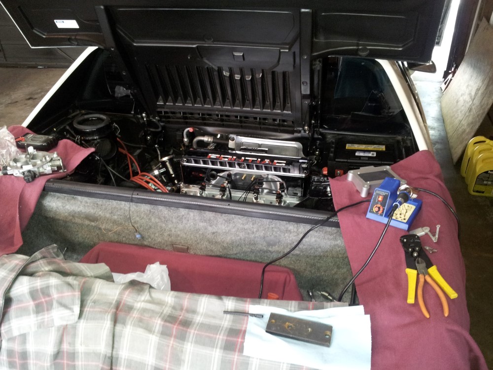

Finally started installation of the Multi-port EFI system I put together.
I have to modify my wiring harness and install new connectors while on the engine.
Here's the 2-bbl and 4-bbl manifolds together to show how huge the open plenum is on the 4-bbl intake.
Just a quick test fit to see how it looks in the engine bay. :-)

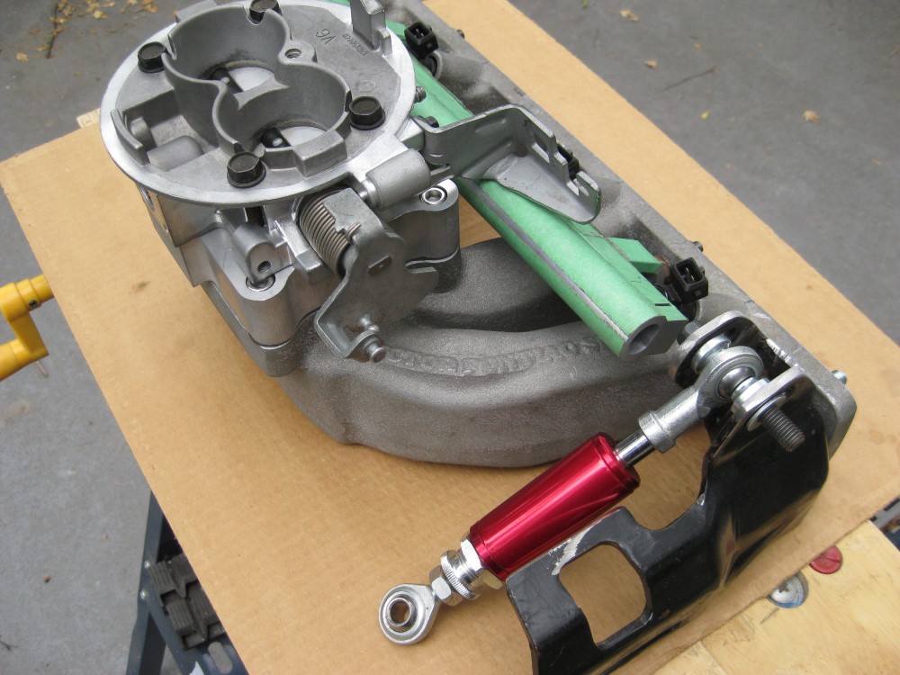

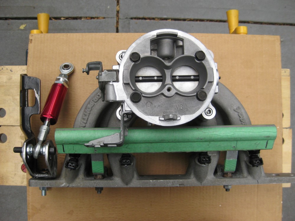

KurtAKX JUL 27, 10:25 PM
curious to see how you make that last bend with the throttle cable- re-using the bellcrank from previous iteration?
