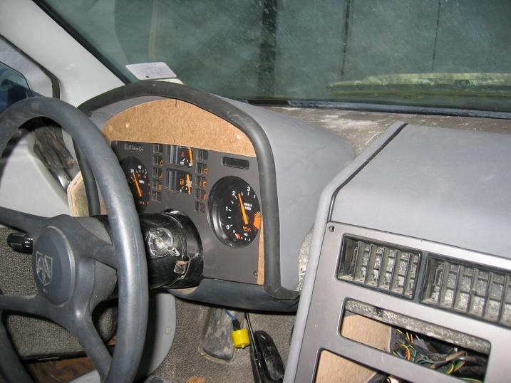

I finally had a chance to work on my dash a little more today.
I got the reworked instrument housing covered.
I was able to adapt the lower part of the stock trim plate to my instrument pod.
The brown colored instrument plate will either be Black or Grey.
Then, I may cut out part of it on the top where it curves and install some black mesh.

I have two extra dash pods with all of the gauges if you need one to cut up or what ever. I can bring it to Round Up this week end in S.A. if you need it. I lost this thread, and am glad to have re located it.
Joe
[This message has been edited by josef644 (edited 05-10-2010).]
TXGOOD MAY 10, 09:59 PM
Joe, I do need the speedo cluster, because mine has gotten torn up from all the fitting etc.
Either a standard or GT whichever you have will be good.
When I see you at the Roundup just let me know how much you want.
Thanks, Mike

Mike do you need the printed circuit on the back side?
TXGOOD MAY 11, 07:22 AM
Yea, I need the whole speedo/tach circuit board assembly.
Mike
josef644 MAY 11, 12:29 PM
I'll put it in the trunk tonight so I don't forget it.
TXGOOD MAY 11, 04:08 PM
Thanks, Joe
See ya there.
Mike
josef644 MAY 11, 07:29 PM
It's in the trunk now.
Later Mike
