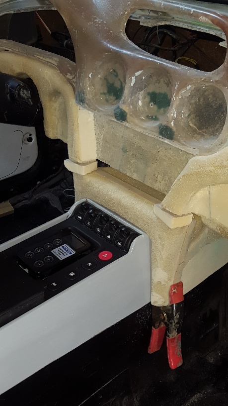

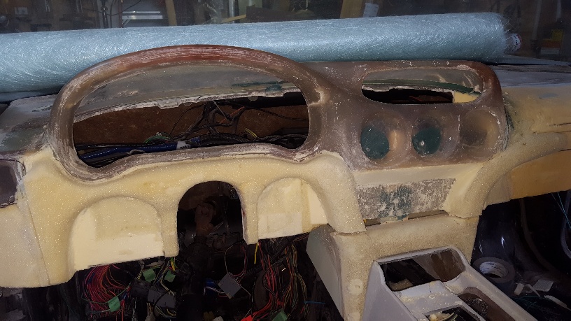

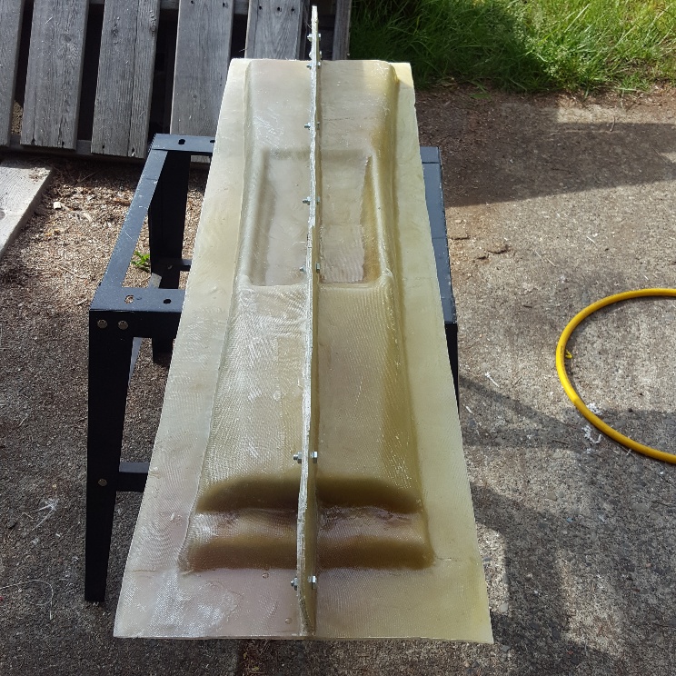

dobie1 MAY 20, 10:26 PM

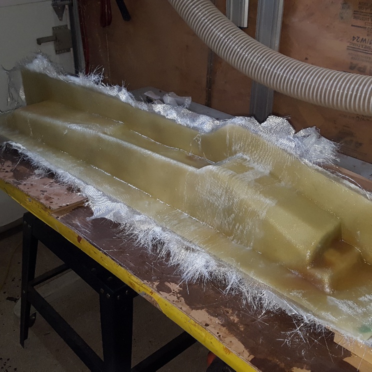

I spent a couple hours today Fibreglassing.
The first picture is with only 1 layer of 1 oz mat. I used the lighter weight glass as there are a couple areas that I needed to ensure the glass was laid and adhered to capture the tight edge. It didn't really lay correctly until the resin started to kick. and having a nice 1/4" roller really helped to keep everything bonding without any voids.
Wayne
The next two pics are with 4 more layers of 1 1/2oz mat, then 1 layer of 6oz E glass, the E Glass will give me a bit more strength and finish. I'll leave it for a day then clean up the edges and also to make sure it is cured before I do the other side.

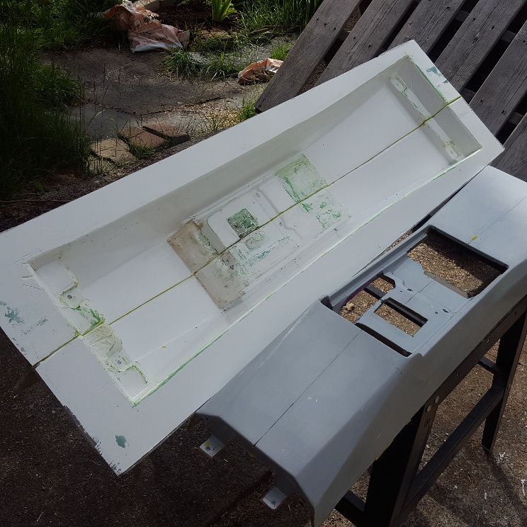

dobie1 MAY 24, 11:30 PM
I have been busy the last few days but was able to finish the mold ,I plan on leaving it to cure for a week before proceeding to do the vacuum bagging of the carbon fibre console .
The mold came out pretty good need to clean it up and prep it . One thing that I want to mention when building a multi part mold is to ensure that before you remove the mold from the buck ensure you drill holes along the the parting wall to ensure alignment of the two halves.

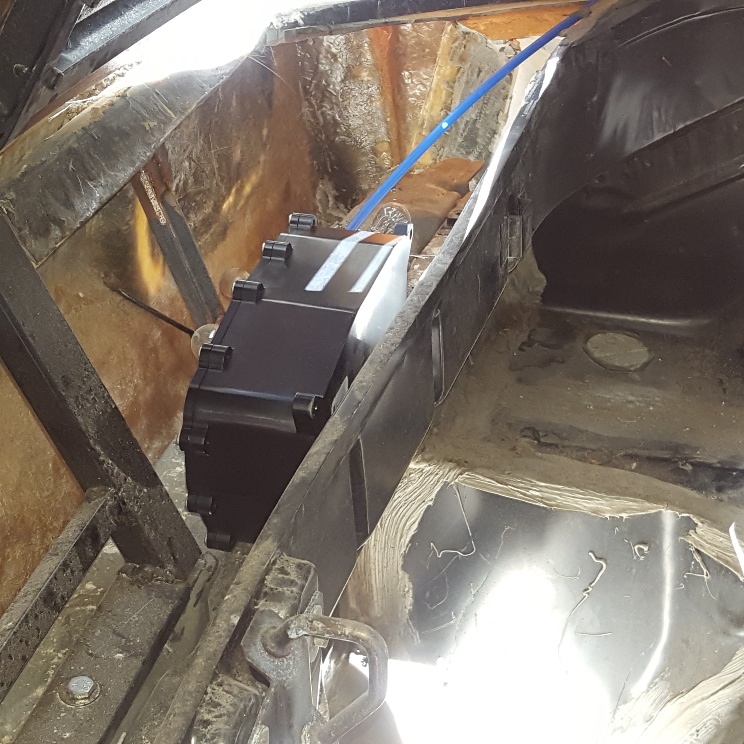

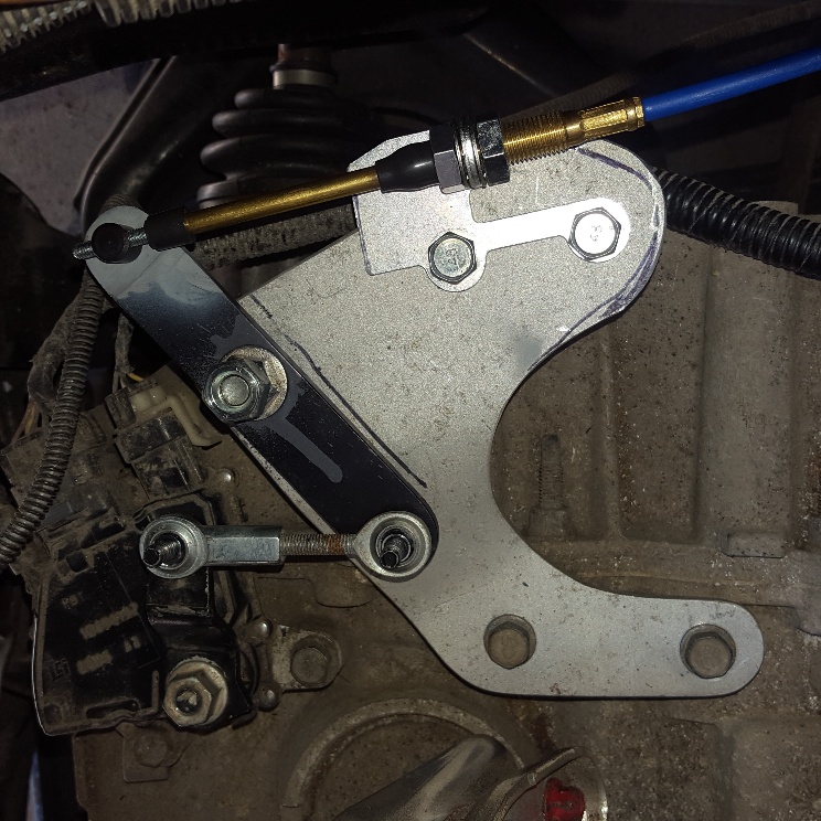

While I was waiting for everything to dry I started to install the new push button shifter, I removed all the OEM automatic shifting cables and shifter.
and modified the shift plate that I had gotten for the 3800 SC with a 4T65E install.
I haven't decided entirely where I"m putting the GSM (Gear Shift Module).

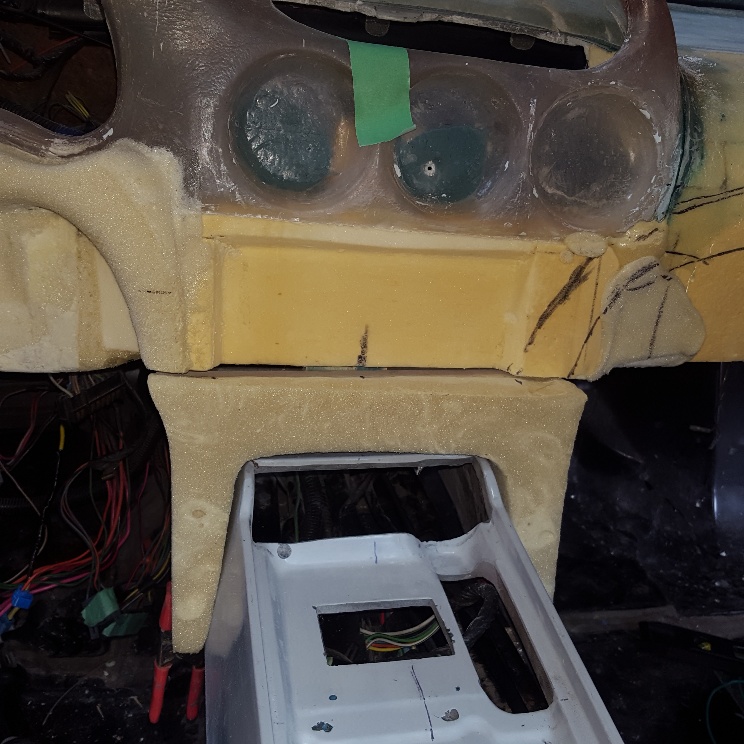

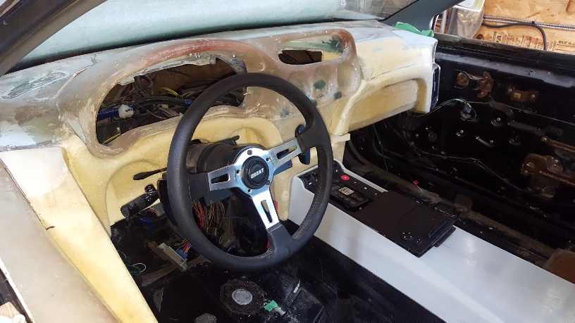

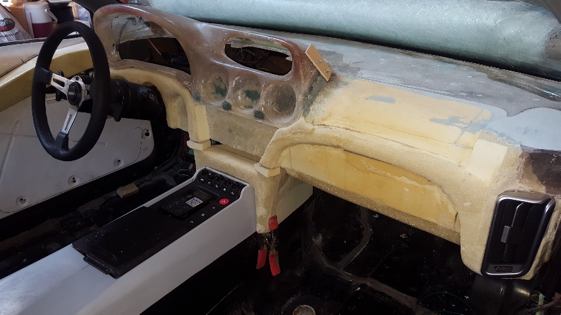

I was playing with the dash today, lots to do but starting to come together. Let me know what you think ?
Always looking for constructive ideas or critiques.

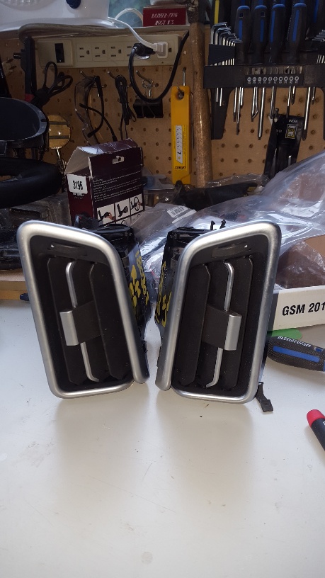

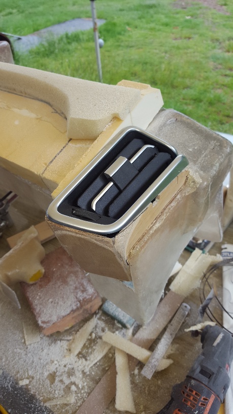

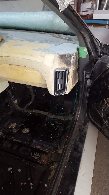

Here is a bit of a update on the dash build.
I've been working on the dash side vents over the last week , i had found a set of Maserati vents that I liked and was able to pick them up a a really good price. I built light ply containment boxes that house the vents , the boxes are buried in the dash foam.
I continued working on the dash design its getting closer to completion ,the glove box i'll cut out after I fibreglass the dash.
I hope to Rondo the foam next week to firm up the surface use some light bondo for final shaping before I fibreglass the whole dash.
Wayne
