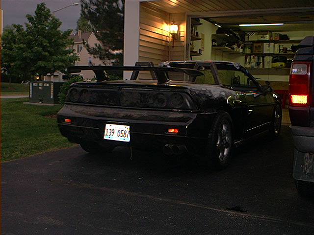

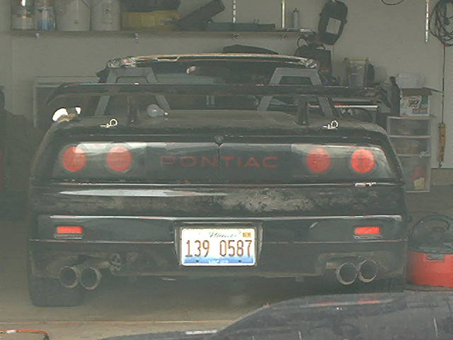

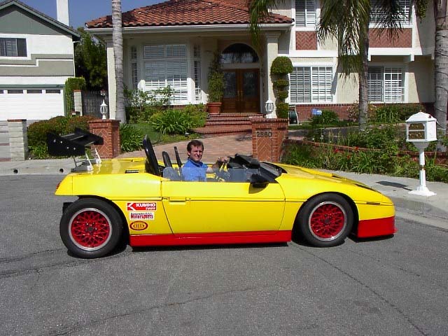

Does anyone have a picture of a Fiero with roll over hoops?
Here is my old Roadster:
Crow's Roadster:
http://www.fiero.nl/forum/F...1/HTML/039369-2.html
Other Random pics:
