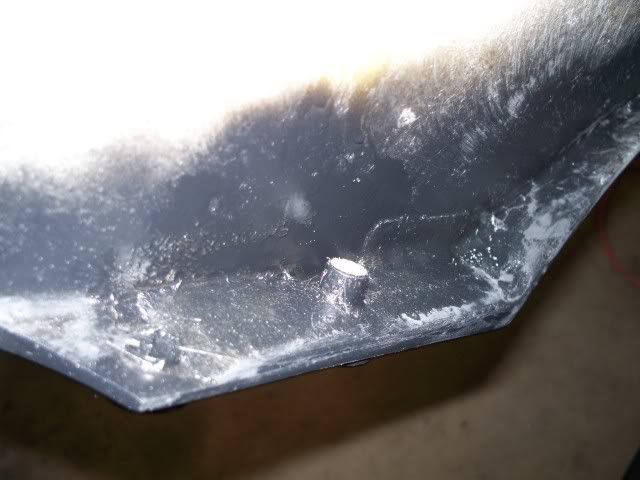

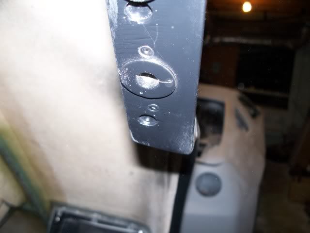

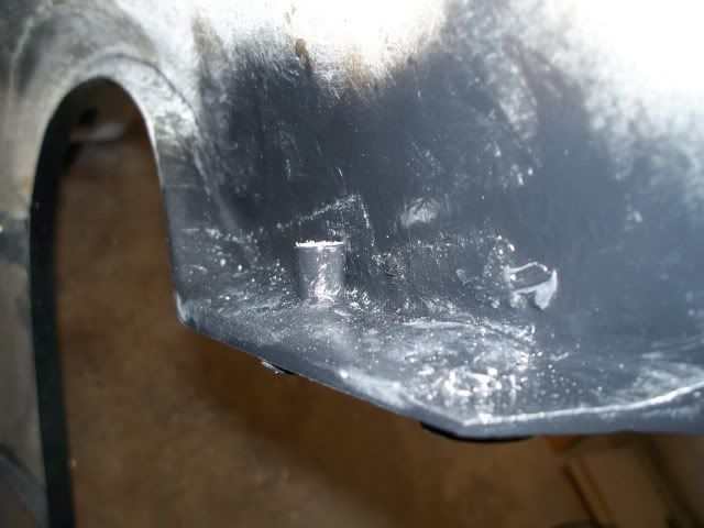

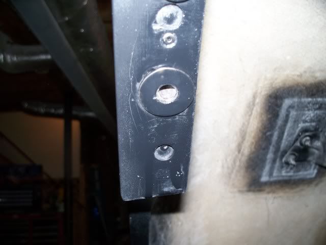

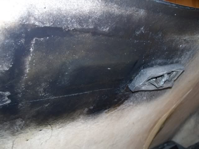

first off the tilt front has a hood spring under it and it was just pushing on the fiberglass hood so it made a dimple so tonight I used a piece of Alu. and glassed on a plate for the spring to push on instead of the glass. also on the hood it has 2 pins one on eather side to keep it in place while closed and the hood just had a hole drilled on it for the pins to go into and with the normal movement of the car it was making the holes biger so I made steal sleves for them to fit into and mounted them in to the hood with pop rivets and fiberglass with a metal plate on the back of the lip of the hood.

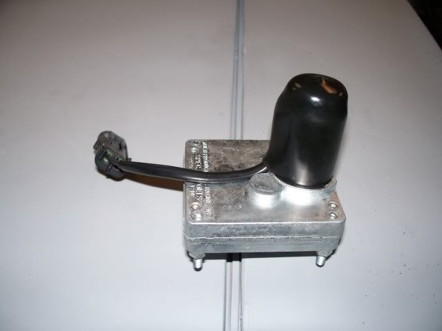

I just got the new motor for the cutout that was broken
and a few pic's of the new hood pin holes I made
I also glassed in a piece of Alu. in the hood for the spring to push on so it would not dimple the fiberglass anymore

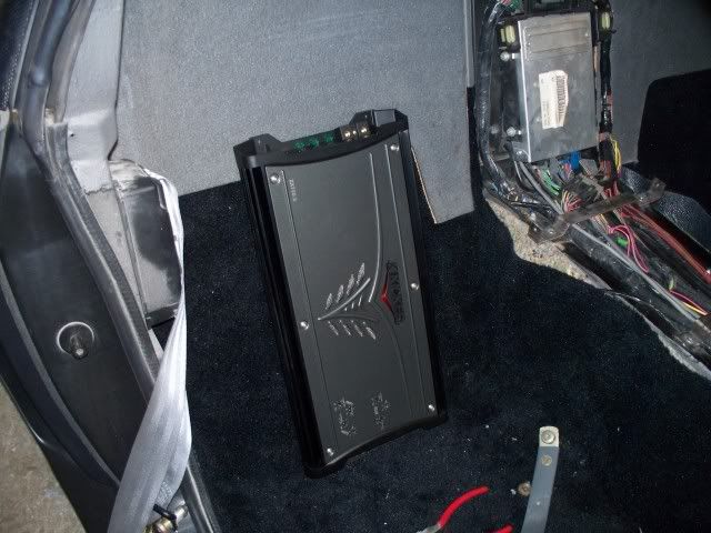

and A pic for Clay of his monster amp that I am installing
last night I was able to get the dash back together and the new carpet fitted. I have not installed it all the way because I need to wire up the sound system first.
once that is done I will have the inside done then the work I need to do on the engine will be next.
(the Amp. is not installed yet it is just setting there for mock up)

...and A pic for Clay of his monster amp that I am installing
After seeing this, I decided the fuzz needs to be covered.

Thanks for the suggestions, guys. Tony, I do have a finished subbox and I just noticed there aren't any pics on the thread of it. Maybe Dean could post some pics when he gets the interior back together.
The Kicker amp is their 5-channel and will be powering four of the Infinty 4x6's and one 8" Kicker SoloBaric L7. Controlled by a Jensen VM9512 w/ SatNav and a 7-band equalizer tuned for SQ.
