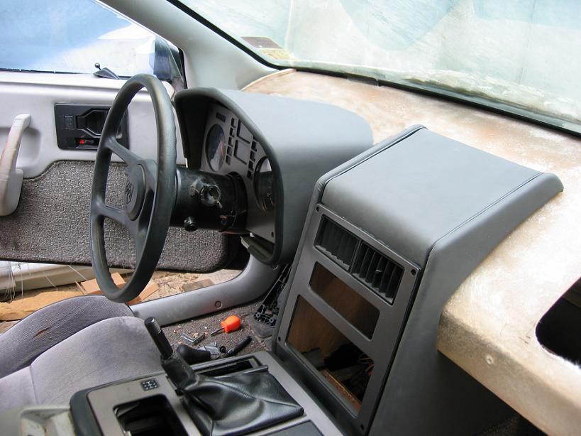

APR 11, 12:19 PM
I got my pod covered today. I need to get some larger trim for the front edge because I changed the way I am going to cover the pod and the groove is not quite wide enough, but you can get an idea of what I`m doing.

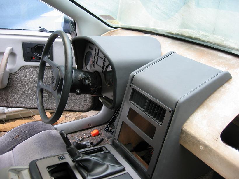

APR 12, 08:31 PM
I started to cut down my instrument pod and although I haven`t covered it yet, I photoshopped what the change will look like. I like it much better.
