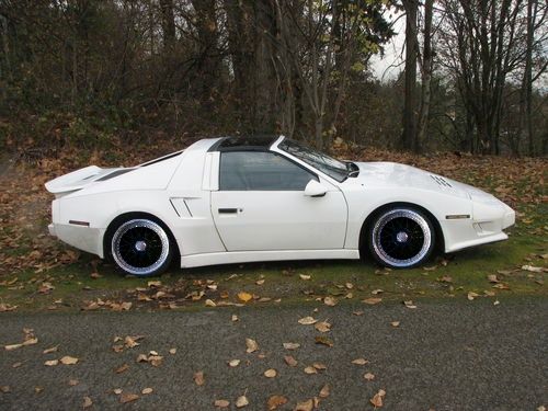

| quote | Originally posted by madcurl:
.jpg)
I'm not feeling the old style door handles. You could use the same type of set-up that JScott used on #014. You can then tweak the already side vent inward near the edge in order to use the GM style electric door poppers.
This what I would do if the car was mine, because it not only modernizes the area with the new Camero side mirrors but also tweaks the side vents too. This tweak IMHO doesn't take away from the original design, but enhances and brings it up to date.
looking to go in this direction using the middle rectangular one and paint it white to match the car
