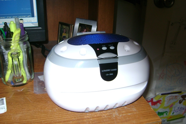

I am at a stand still until I can get all 8 injectors to fire. One is still refusing to squirt. I have an ultrasonic cleaner that is supposed to be here tomorrow. If that doesn't work I will have to wait untill Christmas presents for the grandchildren is finished before I can play with the budget . I am gonna start on the exhaust I think next week, as I have most of that stuff here now. We will have grandchildren here untill Sunday afternoon. No playtime allowed.

Got my Ultrasonice cleaner off of the Fedex truck today. I have the injector in there now. It only runs for three min's at a time, so I have to keep turning it on. I am gonna run it threw a hour and a half befor I try to see if it will squirt tomorrow sometime. I have had some PB Blaster in bithn ends for the past few days.

You can't override the 3 minute timer? You might be able to bypass it. Dont' mind me. I modify everything.

Just a thought before you waste too much time on the injector - check it with an ohm meter. Put the meter across the 2 pins - should be low resistance, if not the coil is bad.

Great idea. Ill do it right now and get back to you.
Set on 200K it measured 00.0 A good one measured 00.0, On scale 200 Bad one 16.3 Good one 16.4 I checked three on the 200 scale from the 'good' pile. They all measure 16.XX

I'll just let it be I think. I have it here in my computer room. When it kicks off I'll just push the on button again.[This message has been edited by josef644 (edited 11-26-2009).]
