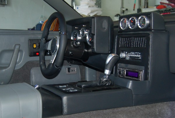

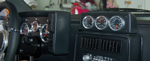

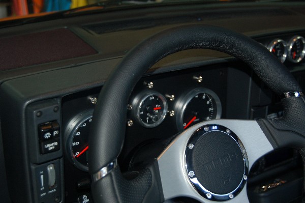

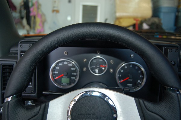

The gage upgrade is FINISHED!
I think the install looks good, especialy since all my gages now match!
Drivers view:
Outside lookin' in:
Everything works like a charm, except that my seatbelt warning LED seems to stay lit just a wee tiny bit, (like a small pinpoint of yellow light).
I might need to add another resistor to that line, but it's barely noticable unless you look for it.
The Tach is already calibrated but I still need to drive the car over a measured 2 miles to accurately calibrate the Speedo.
The fuel gage has to be calibrated at BOTH completely full and completely empty to work accurately.
Not sure how I'm going to do that yet, short of simply running it till empty, calibrating the gage and then filling it up and calibrating at full....
Should work well though with the new Fiero Store sending unit I just put in the tank. It's showing what I assume to be proper Ohms at the dash harness now, so we shall see.
