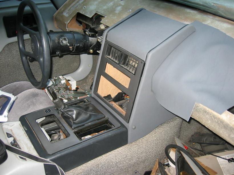

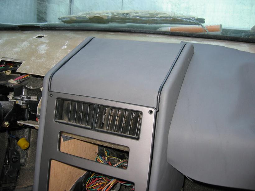

TXGOOD
MAR 27, 06:58 PM
I covered my console today. The charcoal color is darker it just looks lighter with the flash on.
