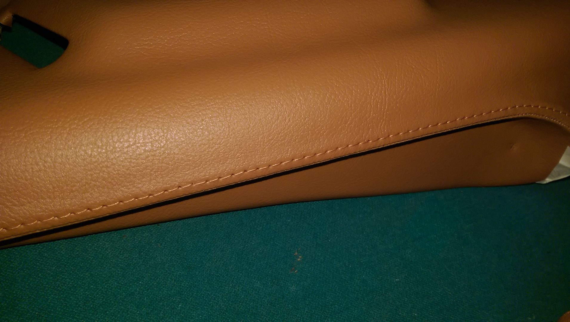

| quote | Originally posted by TXOPIE:
Not painted...upholstered in material...same as my G1 dash above.
Here is a close-up of the stitch line on the rear trim piece:
F-ING AWESOME!! edit to add----X2 page ownage also[This message has been edited by fireboss (edited 06-18-2015).]
