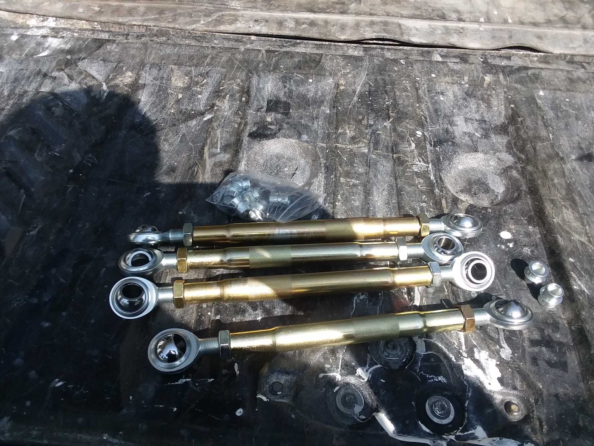

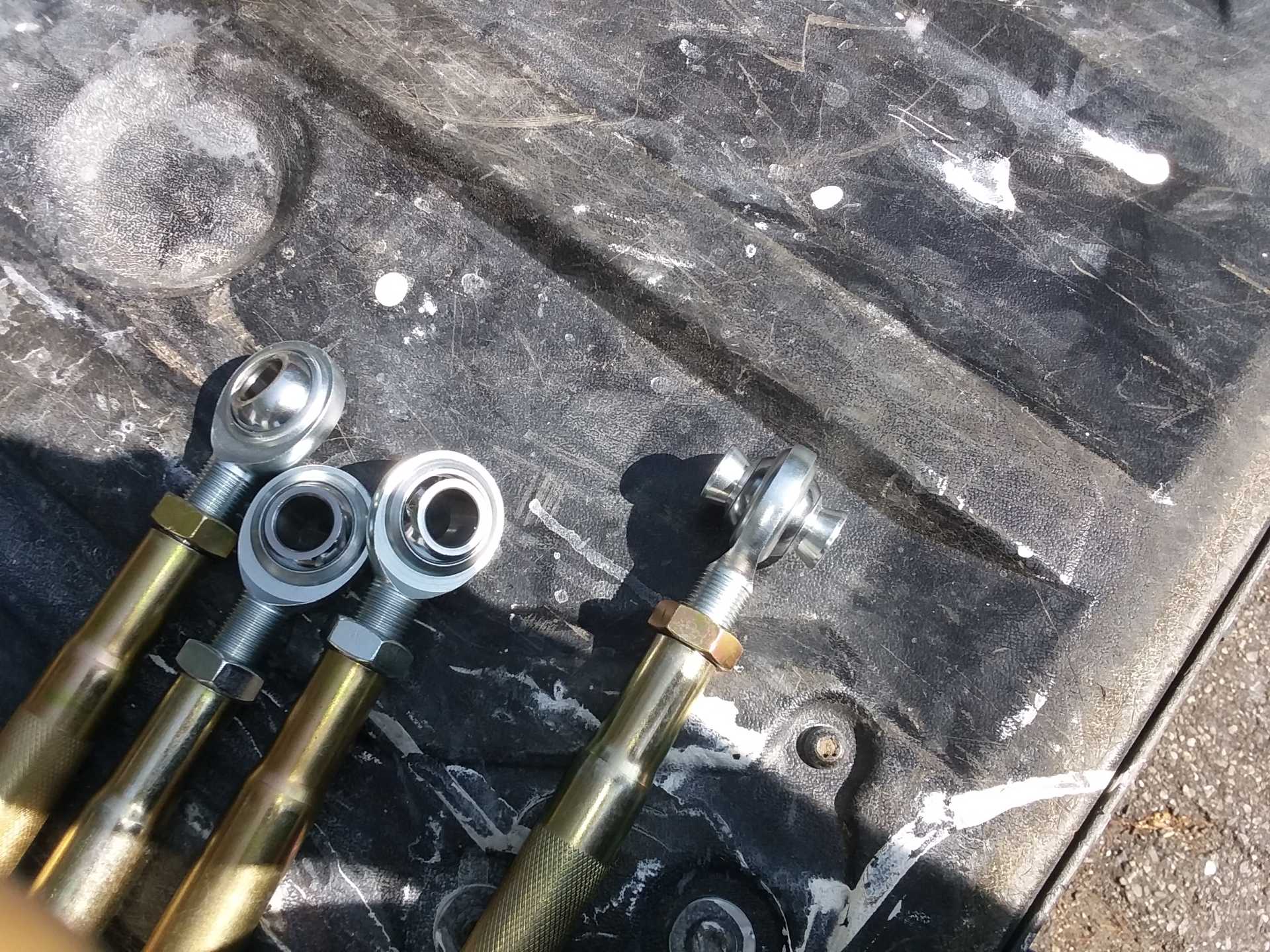

i bought some 5/8 rod ends and rods and some 5/8 to 12mm spacers , i only bought 8 of the spacer to do the inner mounting points but i will drill & tap the knuckle to 5/8 Ok
