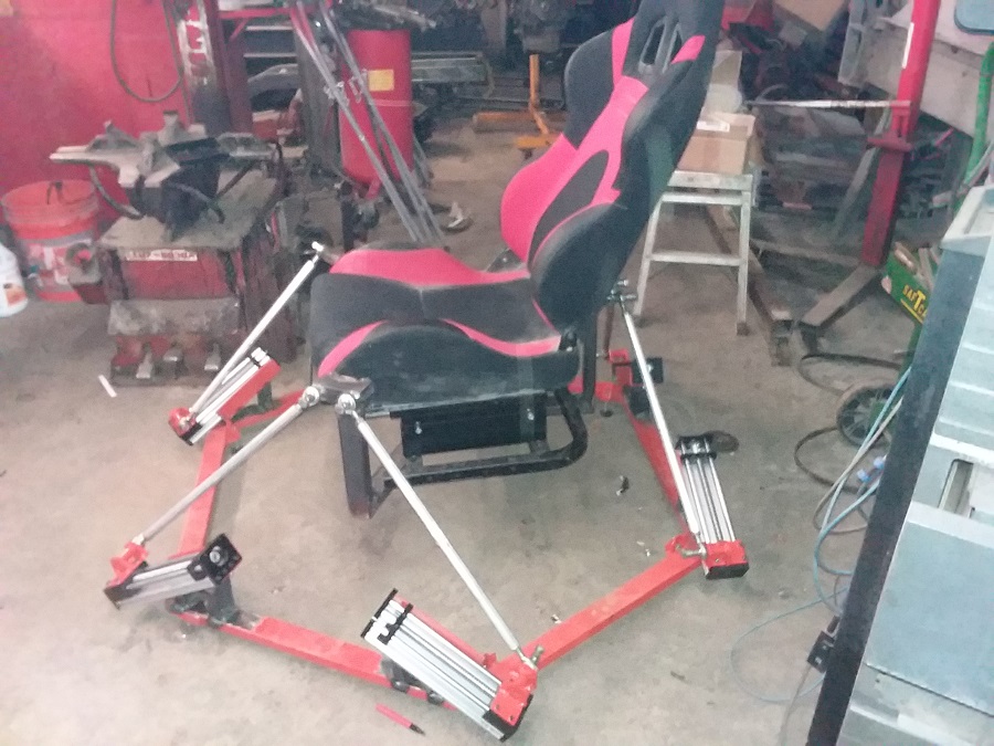

ok i can build those as my buddys speed shop is out front of my shop that i rent off him and he has 1/2 -5/8 rod ends along with radius rod as i built these for my motion simulator and i used the QA1 ends
