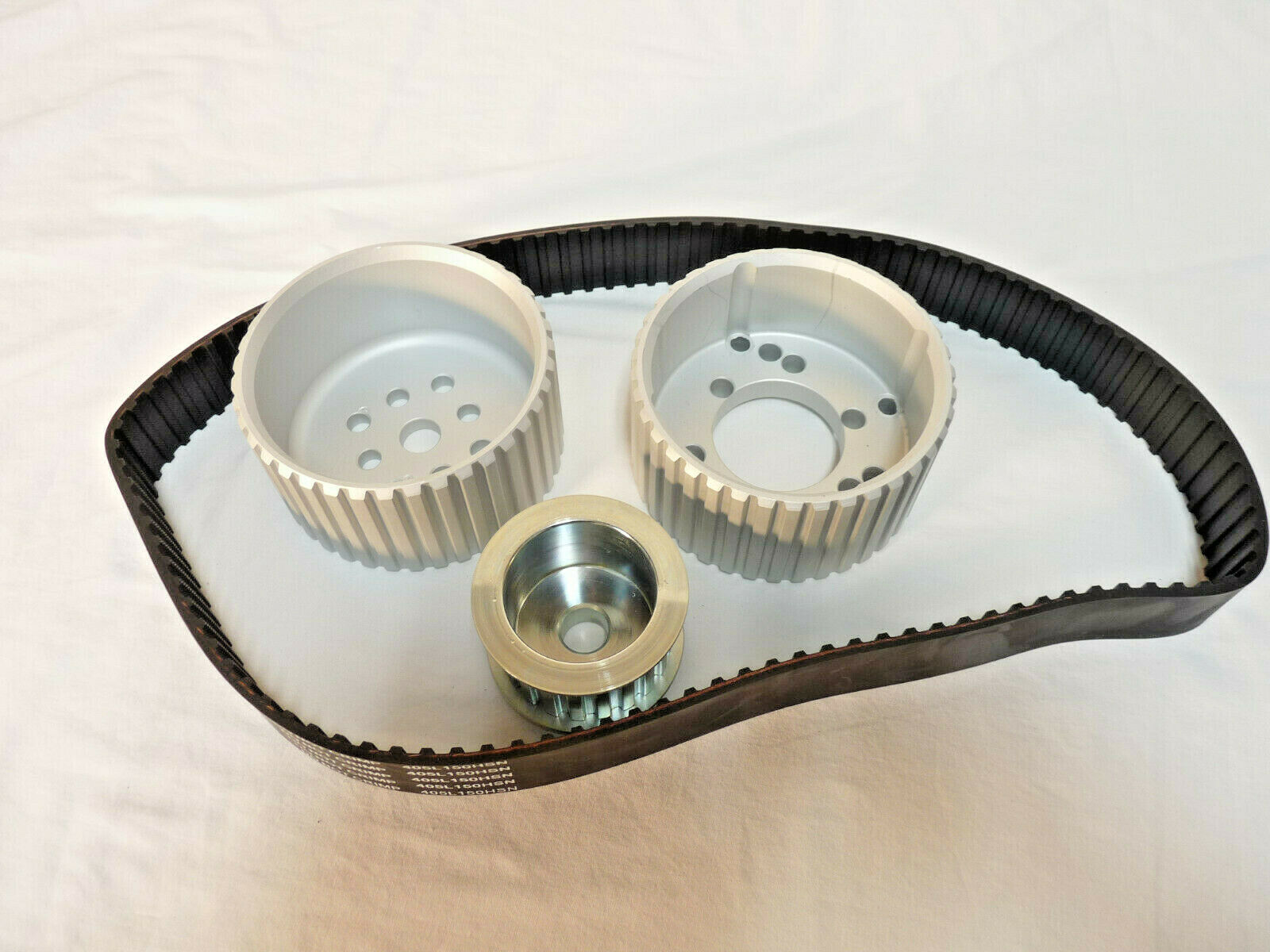

Well it looks like the slipping belt is back so i will try one more thing by going back to a manual belt tensioner on 1 of the belts and if that does not work then i need to either go to a toothed belt or just pull the Supercharger and put a turbo on but i am pretty sure i will end up with the toothed belt as i do really want this to work .
engine man
JUL 27, 03:20 PM
Ok i just ordered this SBC drive kit for water pump and alternator it give me a crank pulley and i think the alternator pulley i will use on the blower as i think it is a 2 to 1 ratio so at 6500 the blower will be turning 13000 rpm but this will get me going to a non slip solution and it cost me $113 to start
