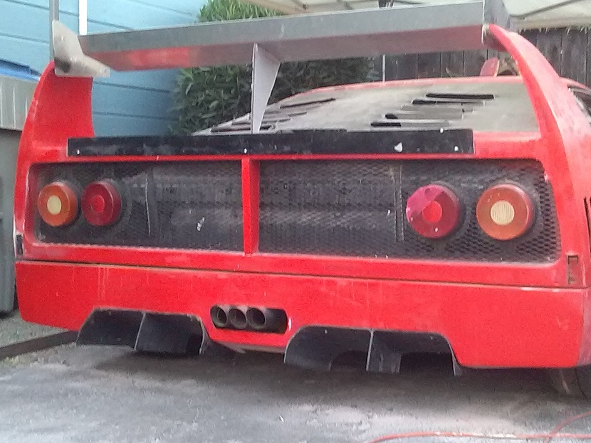

No skills buddy just making it up as I go along. This things all boogered together, every single piece o fb has been cut in half at least one way, once lol. The pieces are pretty damn thick from all the over lap on the inside. Im jonesing to do the interior, hafta finish the fb first- so much damn dust! Will be chopping up the headlight area of the hood this weekend and my metal showed up for door sills, rear roof frame, new spoiler and rear piece o metal that goes across the whole back. went dumpster diving while at the shop and found a 20" piece of 2.5" ss pipe. Free exhaust tips! Then onto air suspension.
I live on a kinda busy 4 way street w poeple walking by often. An older guy sees me working on the car and says Ferrari? Pontiac. gives me a weird look- ferrari? no pontiac! what year? 86 oh, looks like a ferrari from the back
the other day Hey is that a real ferrari? man u know everybodys been asking me that since I got it. Ive never heard of a real ferrari, this is just says ferrari only. I think those are waaay more expensive oh. hmm
Im kinda thinking pontiac emblems all over, I pulled the ferrari stuff off the back. I think itll be more confusing for people if they see pontiac emblems when they walk up. thanks for watching the madness! shem

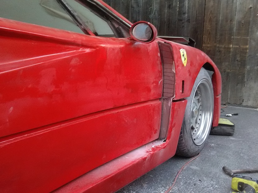

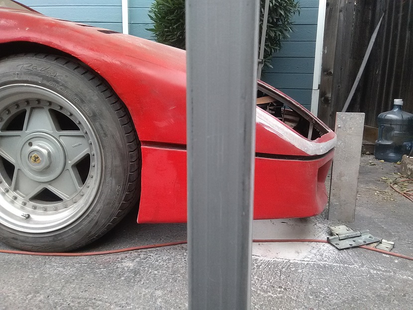

Mkay, heres what I got up to yesterday cut out the fb and made this test piece for the side vents. Its screwed to the door shell so it rotates w the door. Going to see if my buddy can cut these on the laser. If so i can punch out the upper vents to look like the real deal

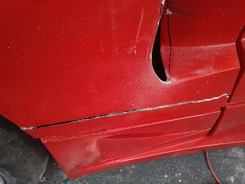

 ripped this panel apart, didnt match too well to the trunk. I didnt have the inside reinforced yet. U can see how little bondo actually stays

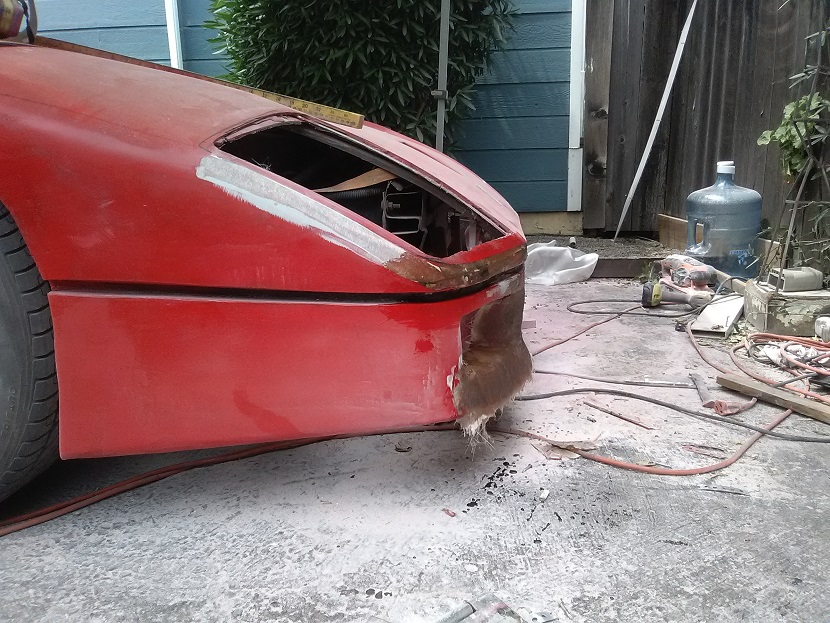

Started chunking up the hood again, the lower area slopes in and shouldnt. Used the belt sander to make some serious roundage at the headlight areas

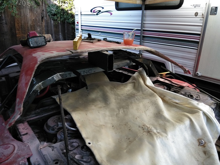

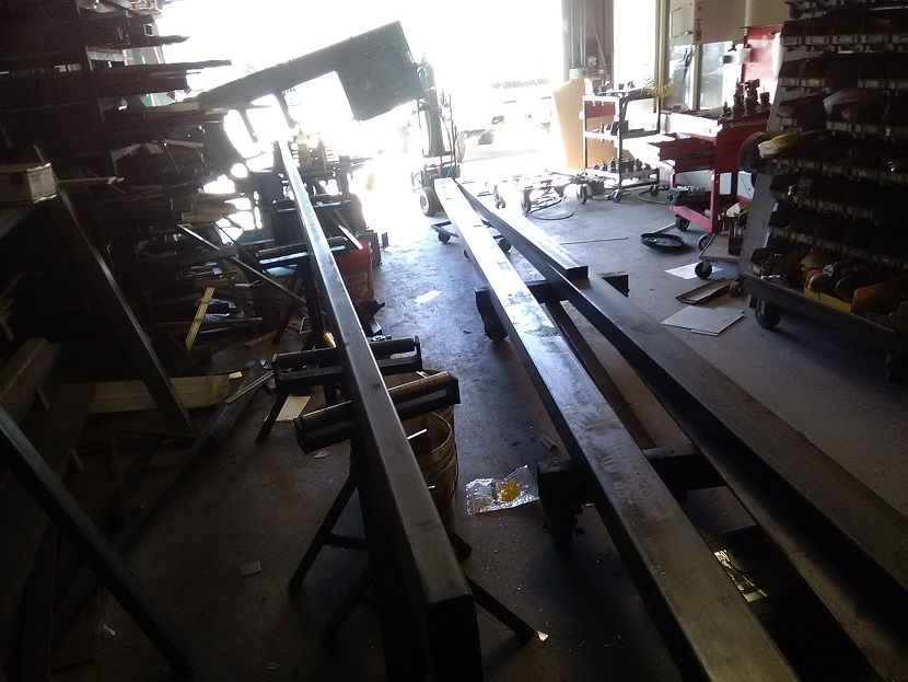

Got some 5x2 .125 wall box for my rear roof support/roll bar. Only needed 6', had to buy a 20'. in the hood picture u can kinda see the super cheese attachment method used to hang the hood on the car. Buncha 1/2" box tubing that bends every time you open the hood so it never sits right again. Going to use some of that 5x2 to make frame/bumper extensions front and back and create a new hood hinge and mounting assy. Heres the 20 footer in the band saw

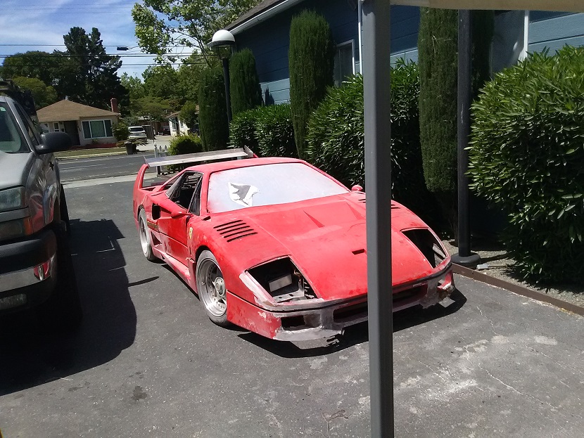

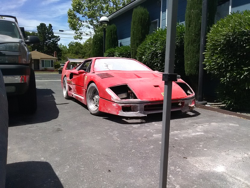

Backed the car out to clean the area. Man I havent looked at the car from far away in a long time, damn it looks pretty f@cking good! The hoods not as bad as I think. Or the work I just did finished the right look. I dunno but I like it i like it hey mikey

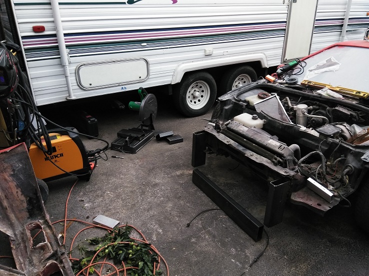

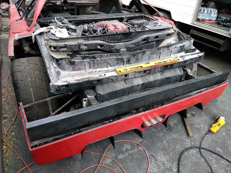

Started diggin into the car again, tone o metal fab n welding to do. Found a use for the rest o that 5x2, welded frame extensions and a back bumper
fabbing a frame for the front clamshell hinges. Found a hitachi cutting saw at lowes for $149, comes w a grinder
Got the rollbar welded in and working on hinges for the trunk lid
Then onto final fiberglassing and air bags
