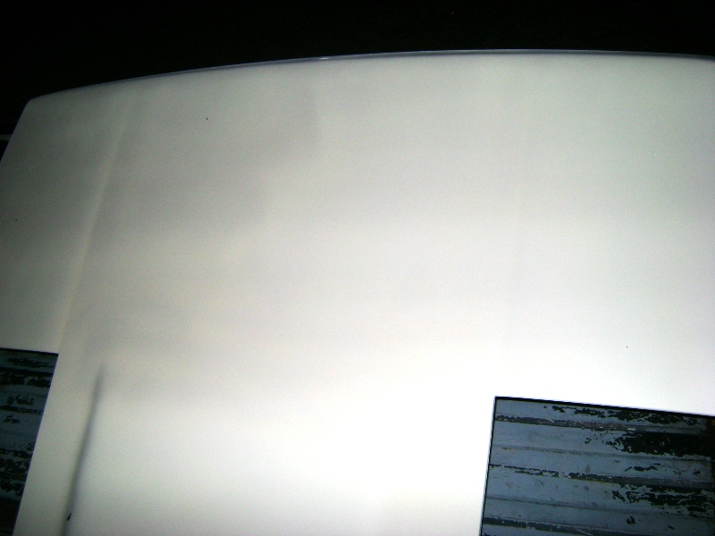

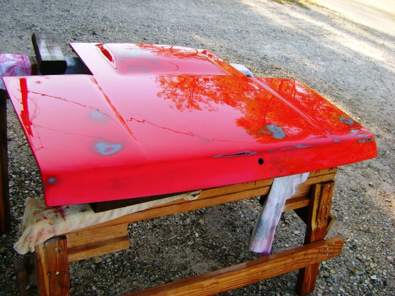

Primered the deck lid this morning. Before the primer was added. My camera will not take a piucture out in the sunlight today for some reason.
Buff Primer:
