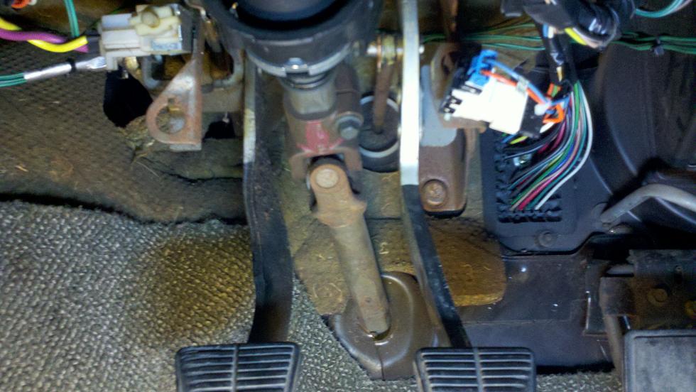

Ok so tried bleeding the new brakes and the lines just ended up exploding. The car has been out of commission for along time.
I was trying to do the CASE learn on the PCM and the Snap On Solus pro kept telling me the brake is not set. I checked the TCC voltage into the PCM (C1-30, C203-P) off of the brake switch and it doesn't go away with the brakes applied. Also my brake lites don't work. The wiring pinouts have been kind of vague on the car wiring required.
My car was manual. So I guess I feel as if im missing something in the manual to auto conversion.

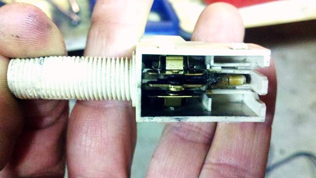

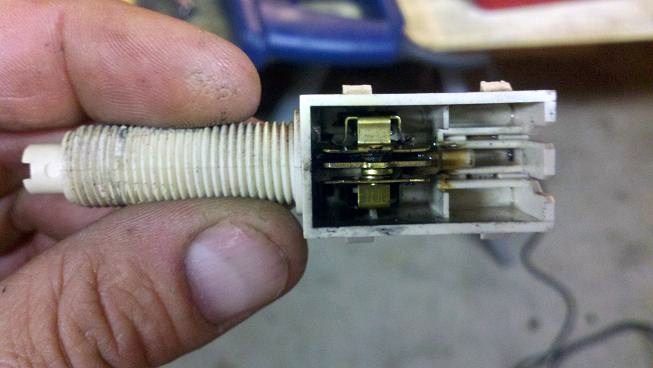

EDIT: The contacts in the brake switch are kind of trashed "erratic contact" so im cleaning them up. The center contact "pin B orange wire" feeds "pin A white wire" and "pin C blue wire" The orange wire is 20A fused and the blue wire feeds the brake lites.
Brake pedal not applied.
Brake pedal applied.

Cleaning the contacts fixed the brake lites.

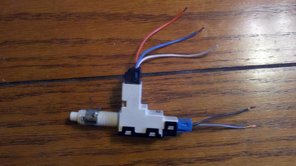

I found this tonight at LKQ.
Brakes and TCC all in one.
Its from a 90 Olds Delta 88.
I just have to splice the upshift lite wire under the dash into the TCC switch, and the other wire to the orange wire of the brake switch.
This will hopefully give the PCM proper indication of the brakes so I can do my CASE learn. Edit; It did.
