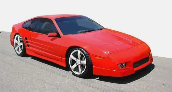

Fie Ro SEP 16, 01:42 PM
I started drawing clear hatch ideas when Ducattiman asked for a F40 type of hatch for his BMW V12 conversion...
So I have been researching the F40 style rearhatch for some time now, but I dont know how to make these shapes in plexiglass only...plus I am looking for a cleaner style for the "stock" fastback and trying to make it relatively easy to build.
The idea is a twin-hatch: stock decklid with the middle piece cutout and an added fiberglass piece (between the sailpanels). The seperate top piece has a fiberglass frame with a piece of "bendable" plexiglass plate that can be screwed or popped in place. It is hinged to the rear roof. Ideally it would be nice to have some linkage between the upper/lower hatch so you could open the decklid the normal way and the top hatch would move up a bit more so they dont hit. A one-piece design would be much more difficult to build because it needs to be hinged at the roofsection which is to weak to bear all that weight without reinforcing.
Ow btw, I will also try to incorporate a row of small vents on both sides (like the newer ferrari's) so the rest can stay smooth and clean.
This is one of the latest ideas. I am not going to do this to mine soon, but maybe in the future...hehe.
I need to update the buildup. I havent done much but there are some new detailing pics and ideas I will post as soon as possible.
Kohburn SEP 16, 01:47 PM
yeah I was planning to have it be a 2 peice also - the idea was to have two struts positioned like Kameo's rear sun deflector ..
i think that last pic of yours chopped but adding some rows of vents at the very top (high suction and it doesn't block any view) and down the very edges would look very very slick
