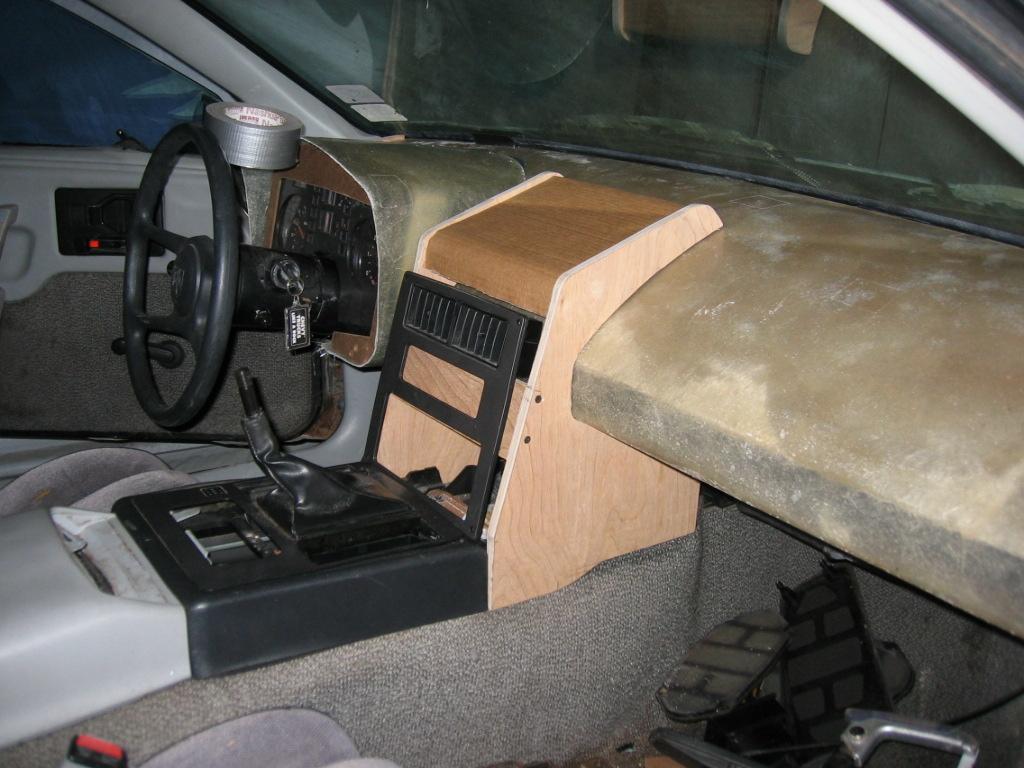

This afternoon I cut out the console sides and just put some cardboard filler to see how it would look. Mike

i have a quick question and by witch i mean no offense! your last dash was very round this one is kind of uhh "lumpy" idk if thats the right word but round some areas and flat others, may i ask why? do you just like this look or is it easier to reproduce if it has that little flat section at the front where your knees would go?

The front is flattened because I have something that will go on there, but I`m not showing that until I upholster the dash.  This project is not really a "one off" because I`m making molds and templates of everything I`m doing in case I want to reproduce this dash. I stuck cardboard in there just to see how it would look filled in. I will probably make a mold for that piece this weekend. I was waiting for the "duct tape" comment. I don`t have any screws on the cluster housing yet, so that`s holding it up. On my first dash, the way the vents were for the ac they pointed up at the windshield and there wasn`t much air flow out toward the cabin, but on this I am going to use some square vents and they will mount on that flat part at both ends on the front of the dash. About the vinyl, on my last dash I used Mr Mikes vinyl, but with this one I`m using Mellohide Allante because it stretches 4 ways and with the color chart I got I have found matches for the dark and light grey and one of the tan colors. Those are the only colors I have samples of from a Fiero. I hope to make it to the Round-up here in Texas this year and I`m going to take my color chart and hopefully catalog all of the colors including the 88 Beechwood.[This message has been edited by TXGOOD (edited 03-10-2010).]

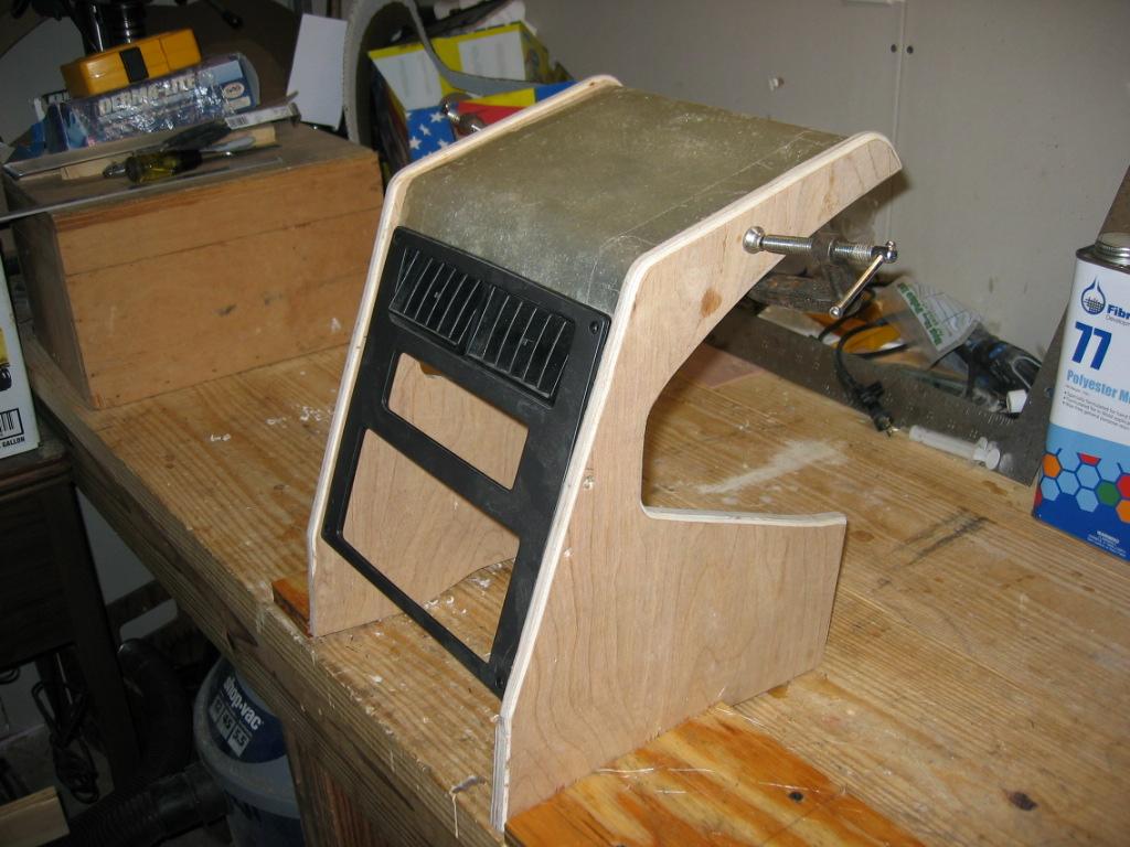

MAR 16, 06:48 PM
I got my mold made for the console top this weekend and I pulled one out today and clamped it together. Fits pretty well. Mike

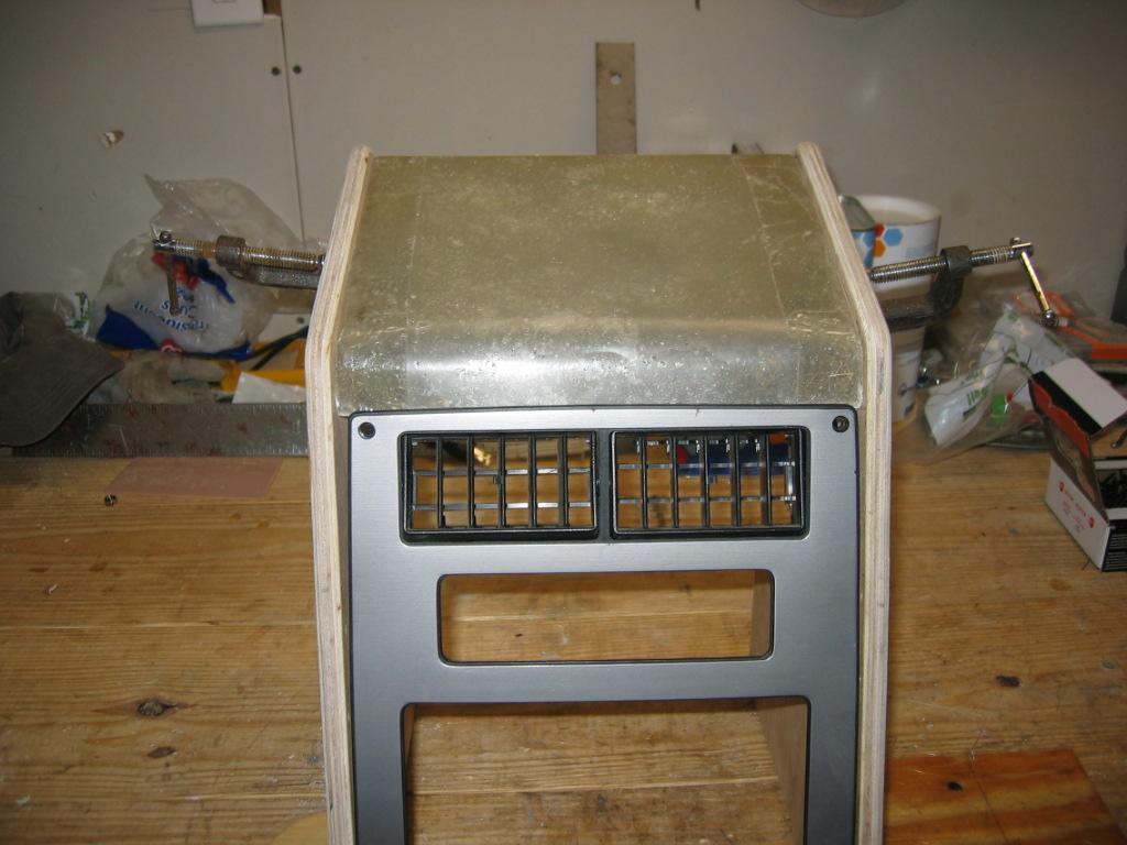

TXGOOD
MAR 22, 11:44 AM
I think I`m going to have to shorten the arched middle section because as you can see from the above picture the plate for the radio surround is not the same across the top as it is across the bottom, so the console will be narrower across the top, but just by 1/4" or so. Not much done this weekend. I did get a template made for cutting out the glove box opening. I ordered more fiberglass materials and some vinyl, so I will be laying up another dash, as the one I have is basically been for mock up and I pretty much know what I need to cut and what I don`t. Next will be the mould made for the AC ductwork. For that I`m going to do as much solid as I can before switching to flexible hose.
