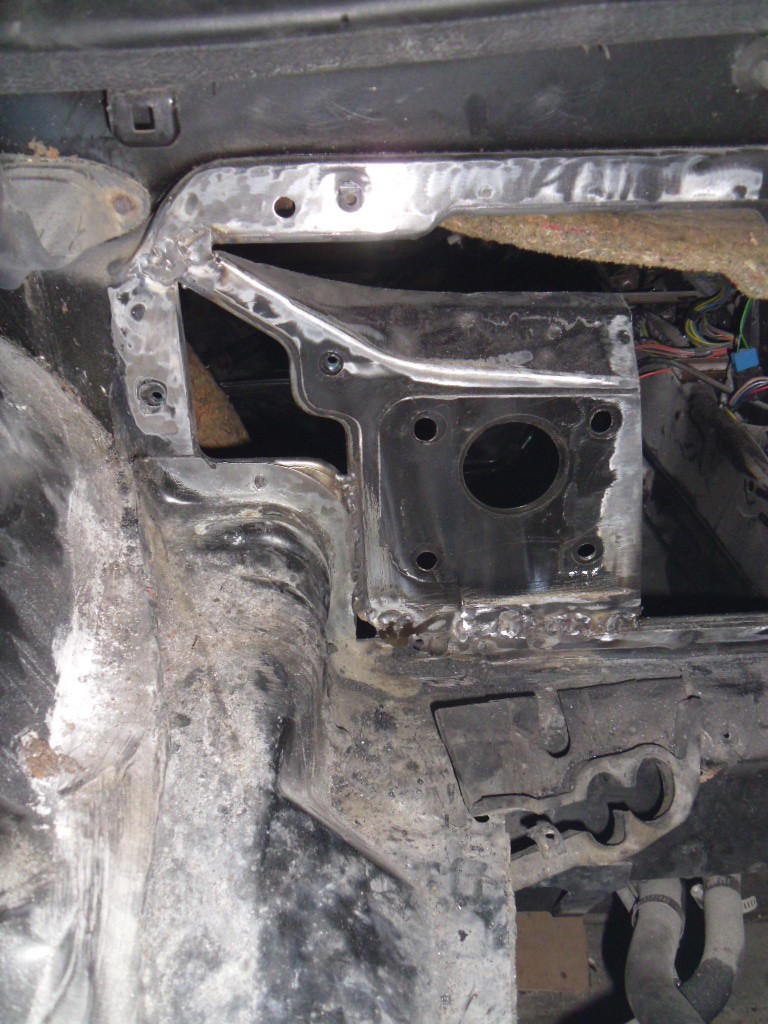

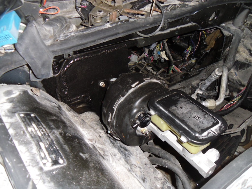

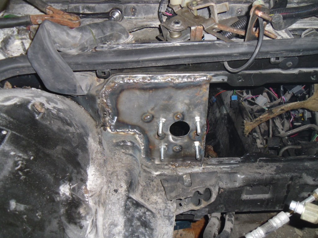

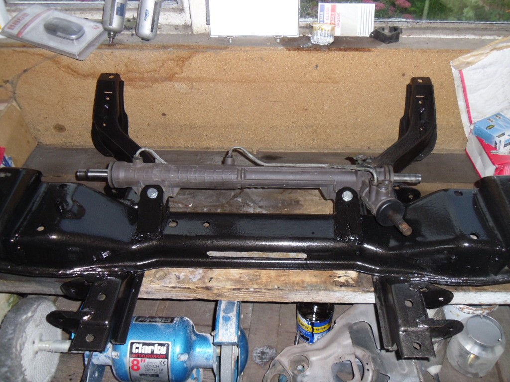

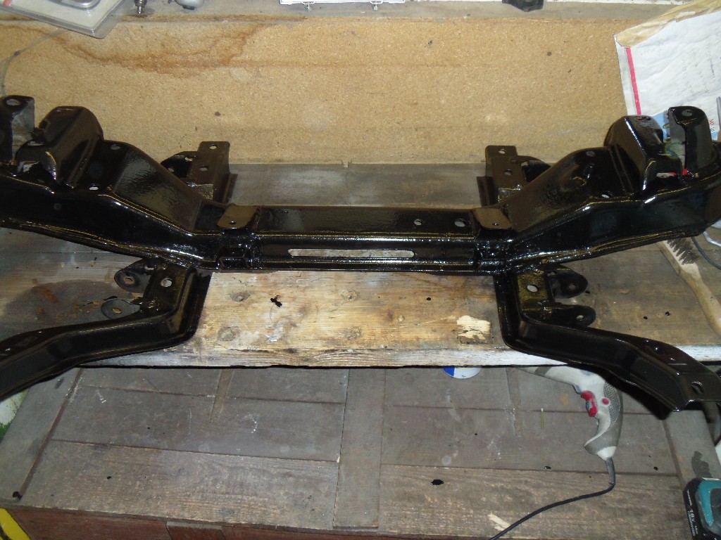

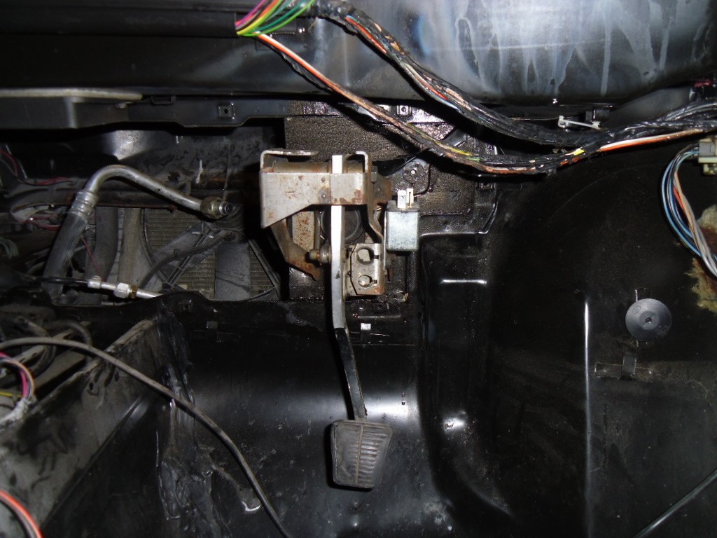

northeastfiero
APR 12, 07:39 PM

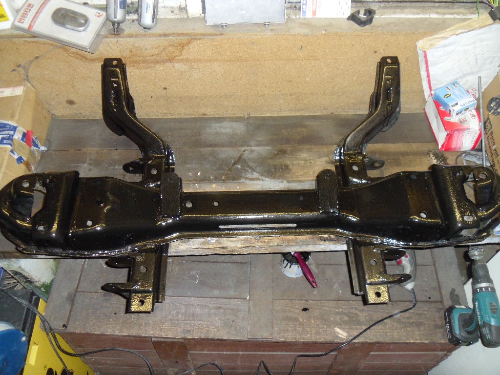

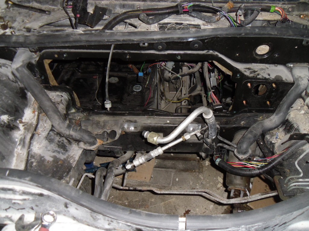

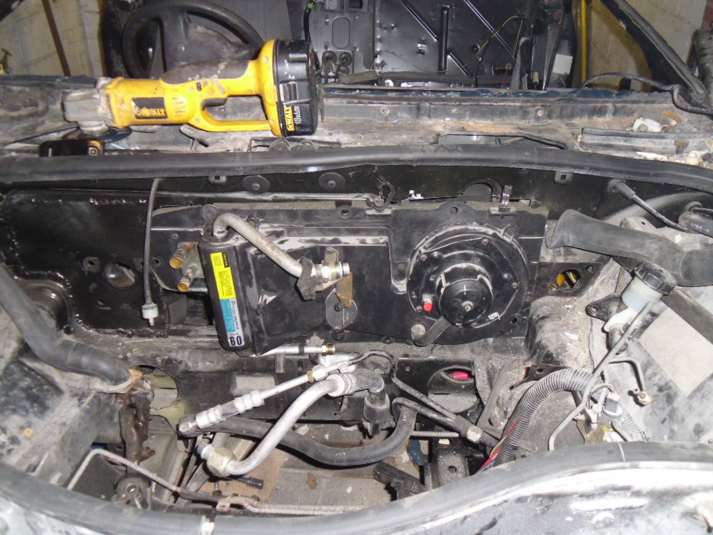

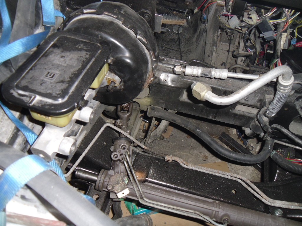

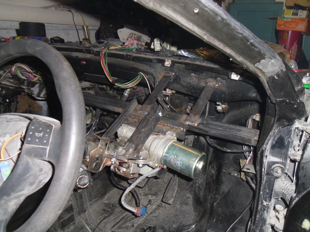

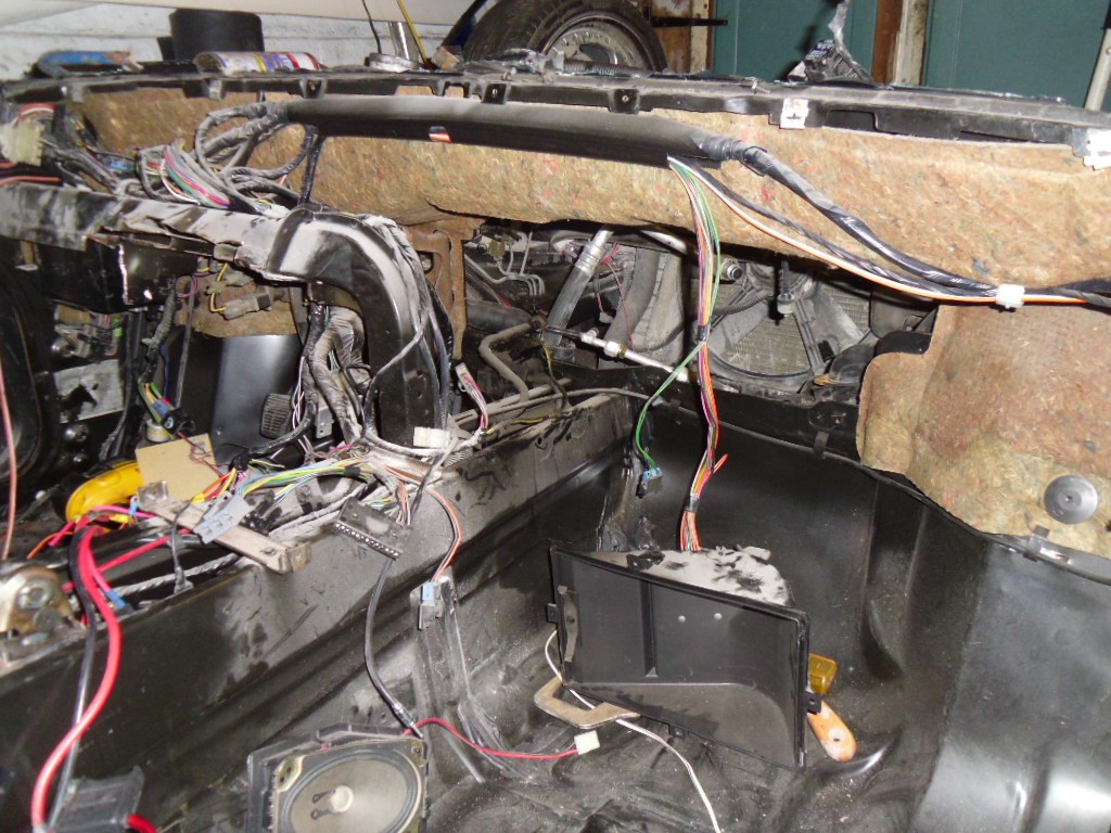

You could also do it the way I did still got a few bits to finish off.
