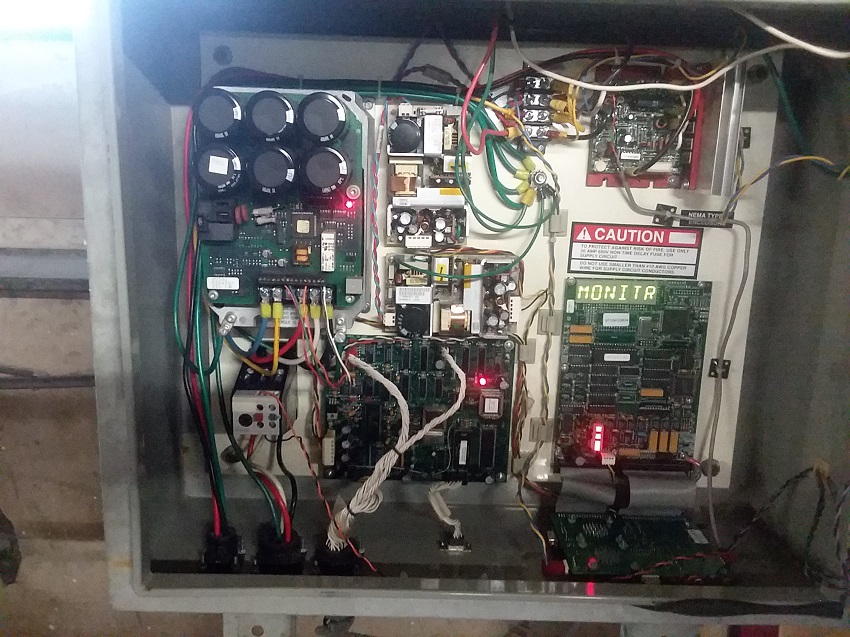

| quote | Originally posted by engine man:
i bought this Mustang dyno it was used for emission testing but i will convert it to what i want not sure if it will need just software or hardware or both . sime videos of it |
Cool project. I work for a dyno manufacturer (not Mustang). I think the biggest hurdles you will encounter are: these dynos have low inertia, so measuring power through inertial testing alone is tricky. And the small rolls will make traction under power difficult, but nothing that cant be overcome to some degree.

I agree the small rollers have a traction problem and the eddy brake on it is good for about 500 whp one guy told me as he has the exact same model dyno and i can control the load manually with a potentiometer as t just needs a 0-5v signal but i would like the computer to do it all. what do you do design ,assemble or write software for them ?

The only tag could see said mustang dyno eddy brake 72Vdc and 40 amps and i am not sure how they are figuring torque arm length as i would think it would be from the center out to the load cell and that is like 8 inches bt the dyno tag said 24 inches so that is a bit confusing to me but i was thinking it might be due to drive belt gearing and inertia weight ? and is a mustang dynamometer md a-sm-97. Wow i am sure happy to have someone like you tell me what you can and understand that it maybe not that much due to you build and sell dynamometers and can not give info away [This message has been edited by engine man (edited 10-19-2019).]

I would assume 24" would be the length they use for a calibration arm? But to determine the torque acting on the load cell from the eddy, it is center line of the pivot (usually the eddy axis, although not always) and the load point on the load cell, but if they use any drive ratio, it would require a correction factor. Inertia load is usually accounted for during acceleration and other dynamic events. I am not very familiar with the construction of the Mustang emissions dynos. They are a bit outdated in the US, so I haven't come across any functioning units.

Thank you for the info that you could tell me and i know the computer to it works but it is so old windows 98 and it will only do emission check and not do any other testing i have not yet tried the big control box that has the power supply to the brake but am told buy the guy that has the same dyno i can control the power absorber by using a variable resistor am assuming he is talking about a potentiometer but i would like to control it with a automatic computer control

Eddy brakes are pretty easy to control, depending on the wiring. If it's wired for 72V DC, I would find a DC motor power supply capable of its rated amps. A variac will no provide a DC signal.

thanks i know there are 3 wires that control the eddy brake module I-con, I-sig & I-pow ground, power & signal , then i need to just get data from the load cell and from the engine rpm and roller , 02 and a few more [This message has been edited by engine man (edited 10-20-2019).]

i have power to the dyno control box
