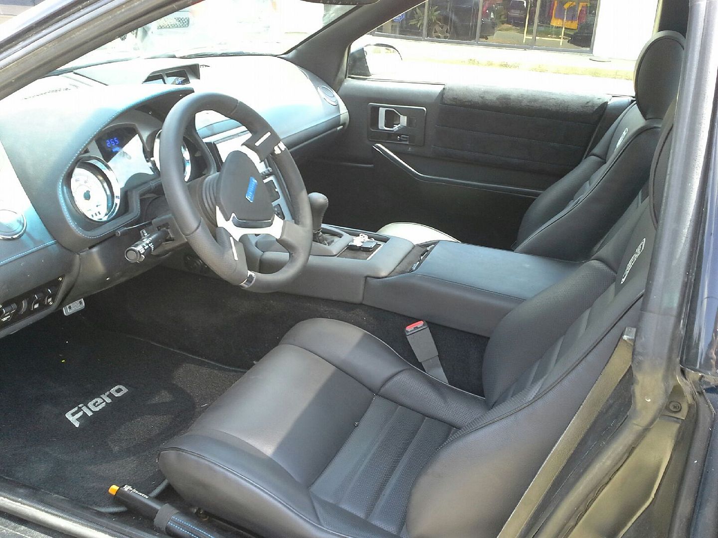

G1 dash in black/grey leather nearly completed.
