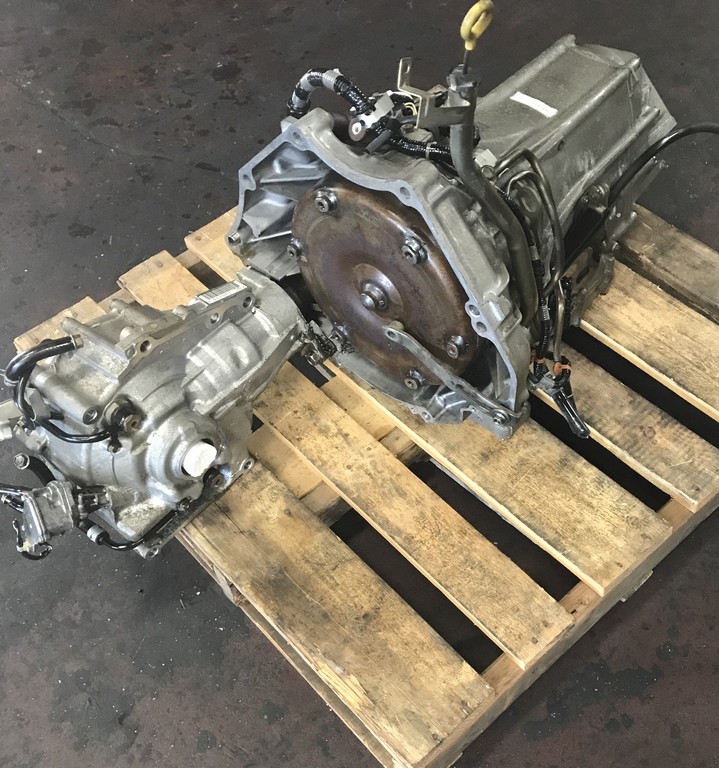

i am thinking of doing a longitudinal Ls engine with manual transmission no stretch by using a 1990 Acura Legend 5 speed the picture is a automatic but as you can see the differential is way forward

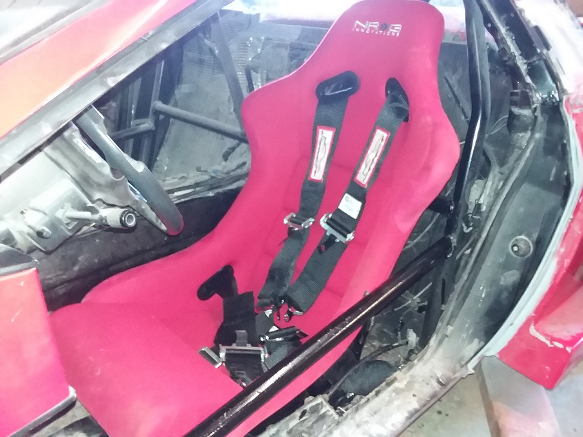

Well today i got up off my @ss and finished the drivers floor and seat mounting now i just need to put down seam sealer and blt the seat belts and seat in that should happen tomorrow

Thanks guys today i did get the seat and belts in the car and seam sealed it on the inside

Looking good buddy! I like what you did w the seat, was anything underneath the pan that needed to be moved? Im thinking aabout doing the same to my project. I was thinkin about the kennedy trans too but I think the ls motor will be too far back and mess w the weight of the car. Keep up the killer work!

engine man
AUG 15, 05:14 PM
thanks and i did not move anything on the bottom side but i did cut the stock seat mounts out
shemdogg
AUG 15, 08:45 PM
Sweet thatl make more headroom for sure. Its now on the list o things to do, thanks man!
