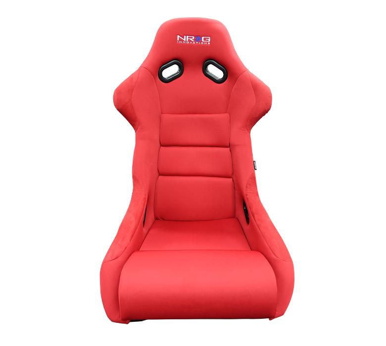

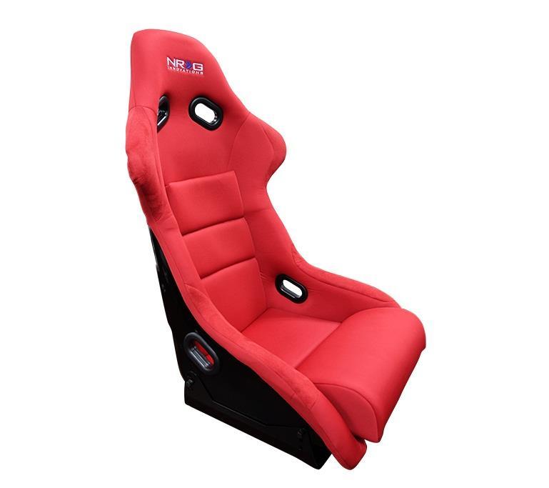

JUL 21, 12:40 PM
i did not play with the windows today but i did with the new seat and it looks like i am going to need to drop the floor 2 inches at the back and just take the front down the same . here are pictures of the seat i bought i it fits me nice and is comfortable to sit in

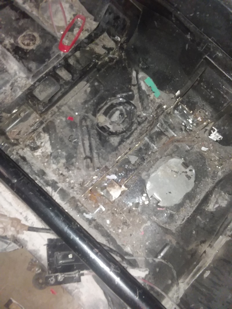

JUL 22, 07:02 PM
today i cut the floor and welded some angle iron and dropped the rear of the floor 1 1/2 inches about and the front 1 inch by cutting it sides and rear of the floor now the seat sits in there the way i want and at the hight i want i just need to finish the tin work
