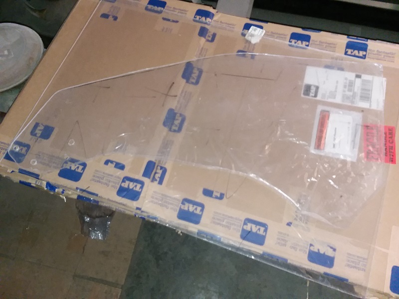

today in my spare time i started to make my windows as i have one cut out close to the shape but still needs some work then i can copy it to the other piece of plexiglass and cut that out then i need to heat them and bend them
engine man
JUL 16, 12:28 PM
Ok i have one window cut out now to just copy it then i need to figure out how i am going to put the curve in them what i am thinking is lay them on a old side window and heat them this will get the really close then install them and put heat to them right at the top door edge and bend the just a little more i just don't know yet what i want to use for the heat source as a heat gun will work but take a long time
shemdogg
JUL 16, 04:48 PM
That stuff looks familiar, Just bought more poly last weekend to do my windows(again). If its 1/8" the heat gun will work, if its 1/4" u need a heat gun on both sides or itll bubble one side before it gets hot enuf to bend. Spray w water to hold the shape after. good luck

JUL 20, 08:36 PM
it is 3/16 thick so tomorrow i will use the old side windows to get them close by laying the plexi on them and heating it all up . i bought a seat that i am pretty sure is going to work for me and i am trying to get my steering wheel so it has a quick disconnect but they are sending me the wrong part or they are not even sending them at all i never had problems like this buying from ebay as i must send back a steering wheel as it is not what i ordered and before that the guy didn't send it so i asked what was going on he said they were defective i think i am going to amazon to get the steering wheel i want as i am sick of these people on ebay
