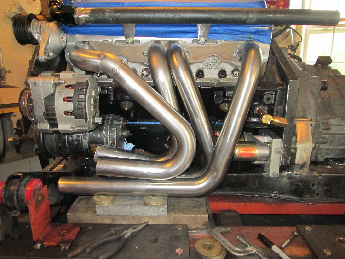

The front header is all tacked together:
The front header is rough mocked up, still need to finish trim/form the primaries to the flange and then work on the collector. Notice I did have to mod the #1 primary for alternator (used a bend from some other 1 3/4" tubing I had on the shelf).

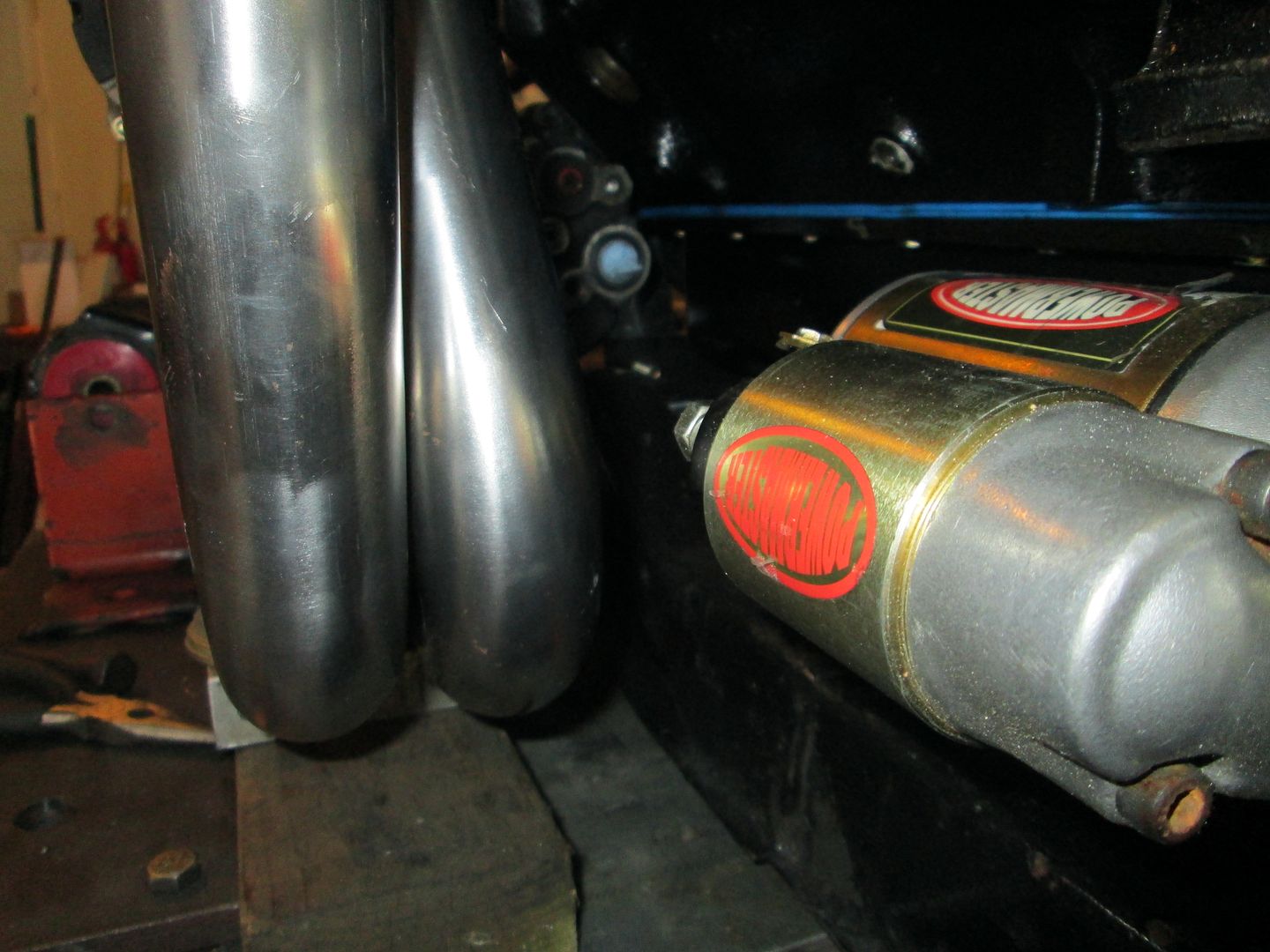

Clearance to the starter (there will be a heat shield to keep the starter cool):

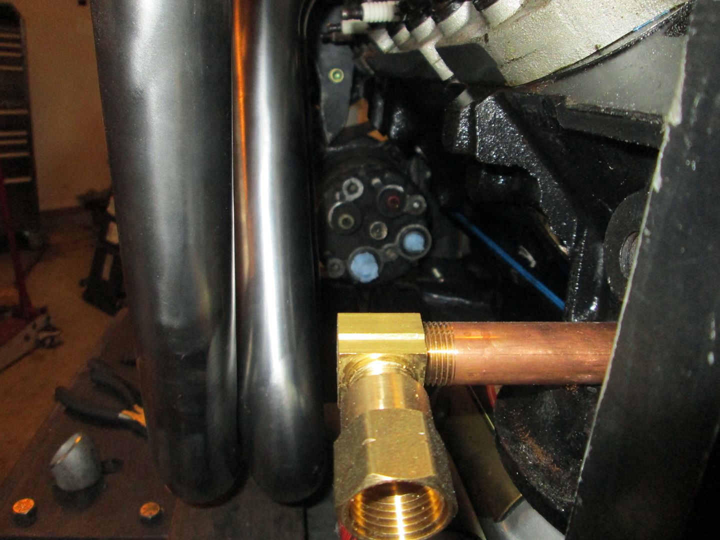

Nice open path for the AC lines to go:
