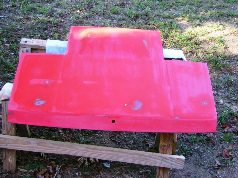

Removed all the deck lid lock hardware and the rubber piece off of the rear window area. Used a a razor blade to take the decals off of the inside of the deck lid.
I was able to hand sand the deck lid with some 220 dry paper. I will get me some 200 Wet or Dry tomorrow so I can get this piece worked down for primer. Seems like w/d cuts a bit faster, and does not clog up the paper as bad, compared to using dry sand paper.

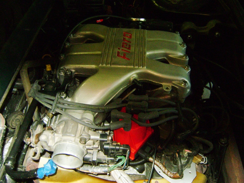

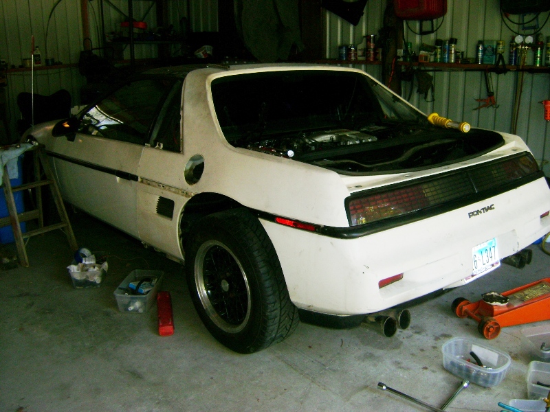

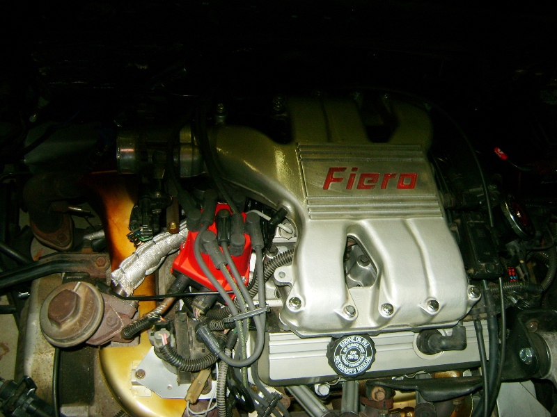

I was able to get the air filter pieces back on the car this morning. I also replaced the temperature sending unit for the gauge. The gauge reads as the one in my 86 'Duke' powered car did. The first quarter 'TIC' is about 190*. Added the driver side quarter panel for the air intake. I set a code 32 while on my little ride. I had forgotten to add the vacuum hose back to the EGR valve. You can see the EGR nipple without the vacuum line attached in the first picture of the engine. I took it for a short 6 mile ride. Added the rear side marker lights back to the body. It will now pass inspection tomorrow after work.
Deck lid sanding in progress:
3.4 in the engine bay:
and
Before I added the quarter panel:
As she sits now:

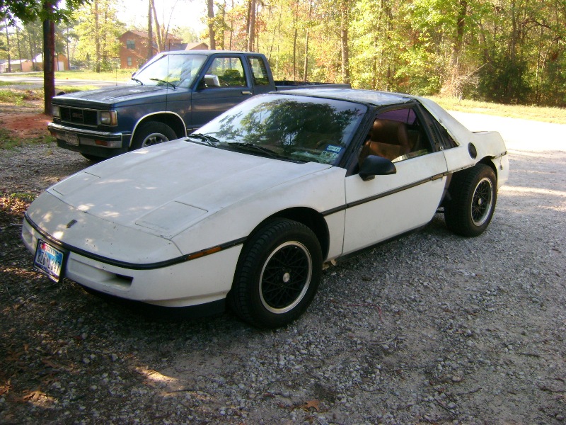

I raised the car after work and remarked my harmonic balancer to 4.600 " before the 3.4 timing mark. I was able to set the base timing to 10 *. Went for a ride. As I was pulling off of the property, the idle jumped back up again like it was when the EGR tube was cracked. Took the car on a 30 mile run. It ran better than it ever has since I got it back on the road. Great power, and smooth as glass.
I jumped ALDL pins A and B. The engine started right up. Ain't supposed to unless the EGR tube is cracked .I am gonna remove the silver insulation covering on the EGR tube tomorrow after work and see if the tube is cracked again.
