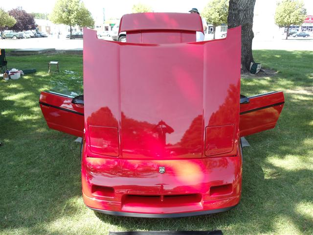

hypo327 NOV 07, 03:51 PM
Originally posted by JSzpotek:
Amazing build, a definite favorite of mine.
Wondering where you got your front lip from?
There is my nest in the back ground...lol ;-) My car was right next to Nolan's, so got to know him a little...cool guy... and really cool, beautiful, gorgeous GT!
