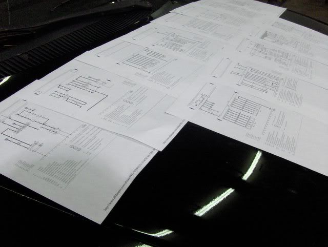

Here is the wiring diagram for the powertrain management. Now there is more wiring in the power and grounds and then the body systems. Trying to incorporate this to work in the Fiero is fun. 39 pages in all....and that doesn't include the Fiero wiring I have to go through. The VW uses track style wiring. Meaning that each page is a continuation of the previous page.

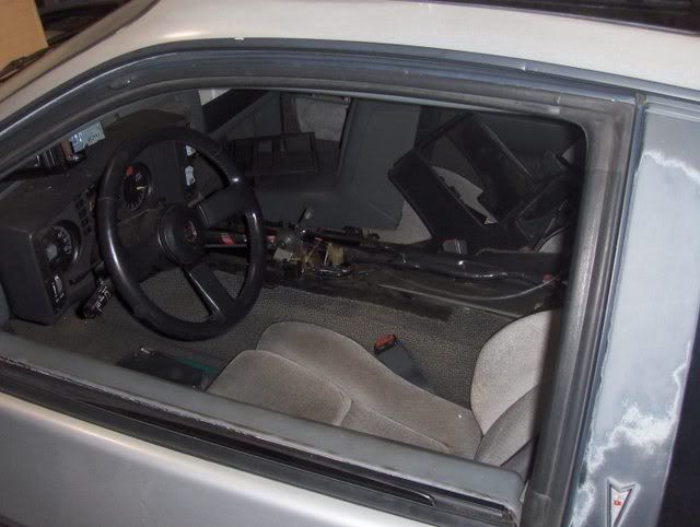

My poor interior. Hopefully, I'll have it back together soon, but it will have to come apart much further than this before that happens. Maybe time for some Mr. Mike's seats. mmmm

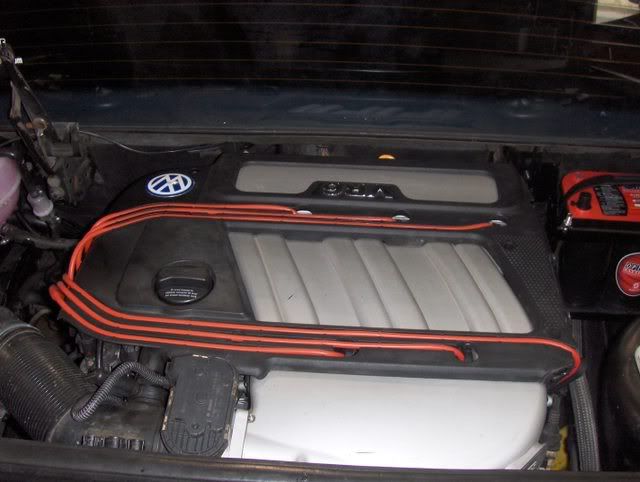

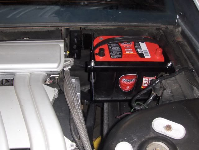

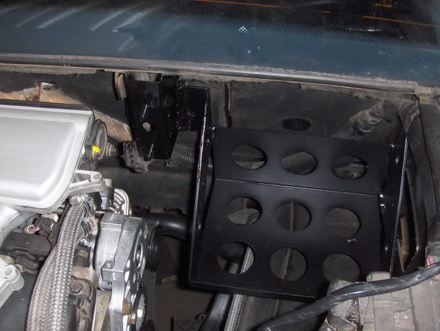

I took a few days to clear my head and I had some progress on the Fiero swap today. I decided to mount the battery in the stock location, but I wasn't happy with the way GM had set it up...plus I am not a fan of side mount batteries. I went with the Optima battery, which had a greater CCA than the factory Jetta battery at a smaller size.

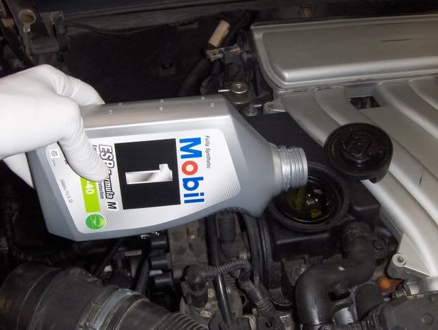

Added 5w40 Mobil 1 and Redline M/T fluid.
I spent hours getting the wiring harness pinned out. VW does not have a pin out chart for the VR6. So, I had to make one and figure out how to incorporate it to work with the GM fusebox and relays. I have about 90 pages of wiring diagrams from both cars and eight hand written pages on how to make the stuff work. I kept the CAN lines in the car and I may be using the VW cluster (not sure yet, but I left the wiring there in case if I do.)
Added the engine covers again and installed the spark plug wires....how's that for an easy tune up???
