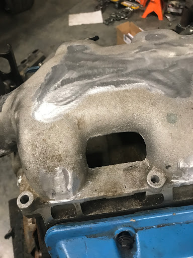

Since we are now working with a 2.8 with 3400 intake and I will be controlling all of this with a Microsquirt stand alone computer, which sadly can’t handle SFI, nor does the engine have the cam sensor needed for SFI, I decided to remove the casting marks. I also removed the EGR valve, extra vacuum fittings and a couple mounting bosses that were no longer needed:
Vacuum fitting removed:
EGR flanges removed:
Mounting bosses and such removed:
Now that I knew it all fit it was a matter of seeing if gaskets lined up. While they do line up, i wouldn’t say they line up well enough to recommend this, and honestly it might all crash and burn due to this The ports on the gen 2 head are a little lower into the valley than the gen 3 intake, its fairly close, but could be better. Since this is a quick build to get the car on the road, and I didn’t want to swap to the 3400 heads I had on the shelf I added a little silicon and we will see the results before too long:
You can also see in the last picture that the ends of the stamped rockers need clearance for the larger intake manifold.
