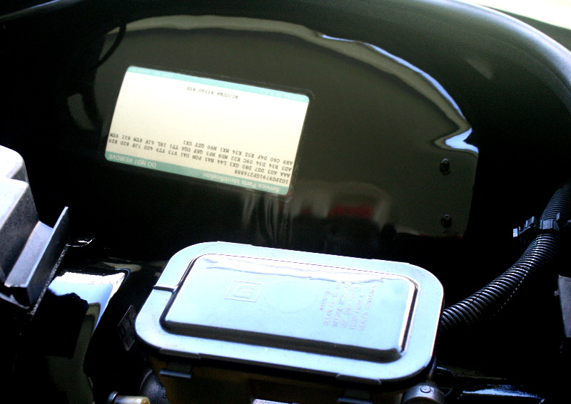

Nothing more rewarding than taking a dirty ugly thing and make it pretty. Did you use gloss black on the front compartment? Looks nice
JohnWPB DEC 03, 09:39 AM
I used Rusteolum Laquer paint from Home Depot. It's about $5 a can.
I have learned a lot from rattle canning parts on the car. I found the hardest part, is to use just the right amount of paint. Too little, and it will not come out smooth. Too much and it will run. I found that I had to put it on pretty heavy, but stop just before it seems like it could run. I didn't think I could get such a nice smooth finish with a rattle can, but it came out pretty good I think. I used it on the brake booster and entire front trunk area.
