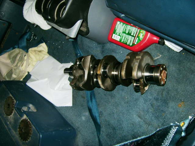

I went to the machine shop to get my block and crankshaft. They both looked new. I do not know how they clean these parts, but they did a great job. Once home I used the Rodney Dickman 3.4 starter jig to drill the two new holes on the opposite side of the block. His jig works great, and I highly recommend using one of these to get it right the first time around. The jig comes with two drill bits. A 8.5mm and a 10.1mm I broke the smaller one as the bit came threw the lower part of the boss cast into the block. I wasn't able to get it up fast enough , hence the bit got bent and broke as the motor was still turning. My fault, not RD's parts fault. I couldn't find a 8.5mm bit around here and purchased a 21/64" bit that is about the thickness of a piece of printing paper smaller. I used it for the second hole, and all is well. New funds spent are posted and updated in the first post.
I am gonna lube and bag the crankshaft until such time as I am ready to put it into the block:

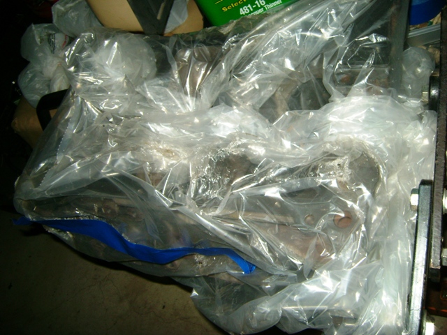

Block sprayed down and bagged while waiting for the rest of my needed parts:
