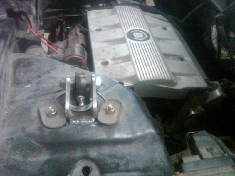

MAR 26, 08:59 AM
 This is the fabricated upper motor mount - its the original Fiero mount cut apart with a new bar in between and a fabricated plate on the back of the motor.[This message has been edited by artworks (edited 07-14-2017).]

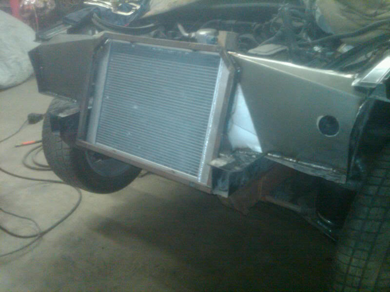

MAR 26, 09:02 AM
a couple of views of the radiator support and front bulkhead fabricated onto the original Fiero sheet metal. It doesn't look much like the original does it?

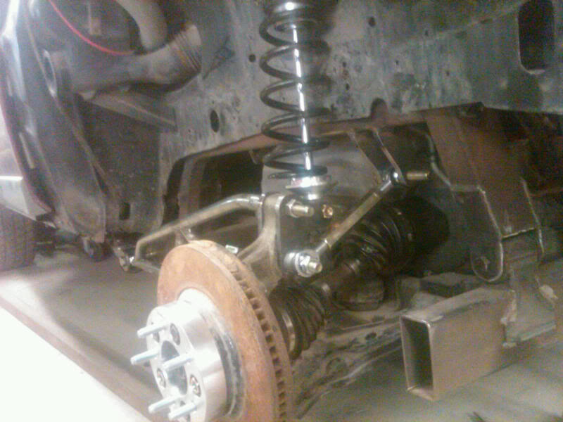

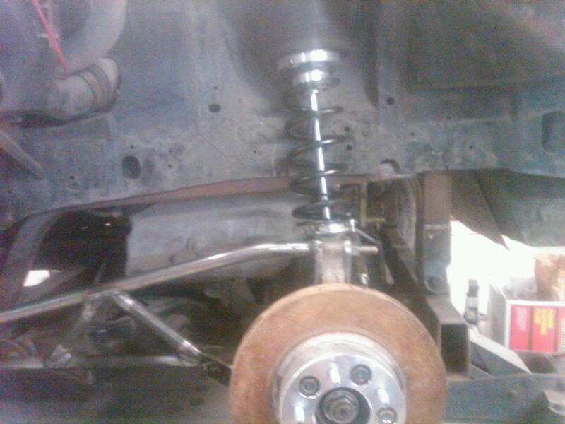

MAR 26, 09:03 AM
 Front shocks mounted! Notice the S10 brake calipers on the custom brackets, connected to the early Pinto spindles. The lower A arms started out as a part from HT motorsports and got tweaked from there. The upper A-arm is hot rod stock for chevy.[This message has been edited by artworks (edited 07-14-2017).]
