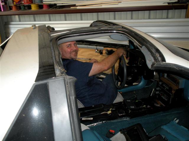

.JPG) Gianina took one of me taking out the interior.

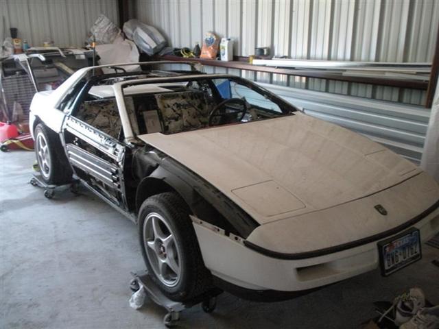

 A couple after the chop fitting the body back

Thanks, I have a few pictures of the T-Tops in and the driver side window test fit. All the welding is done on the top. I have the body cut down in the back. I did not cut any on the T-Top frame it is as it was just a few inches lower. The Glass shop I got the Sebring windshield from said they will cut my back window for me. I hope to get them a wood template made this weekend. I have to be at work both Saturday and Sunday this weekend so I will not be able to do much. The pictures I post tonight will get the build up to date as it is.
