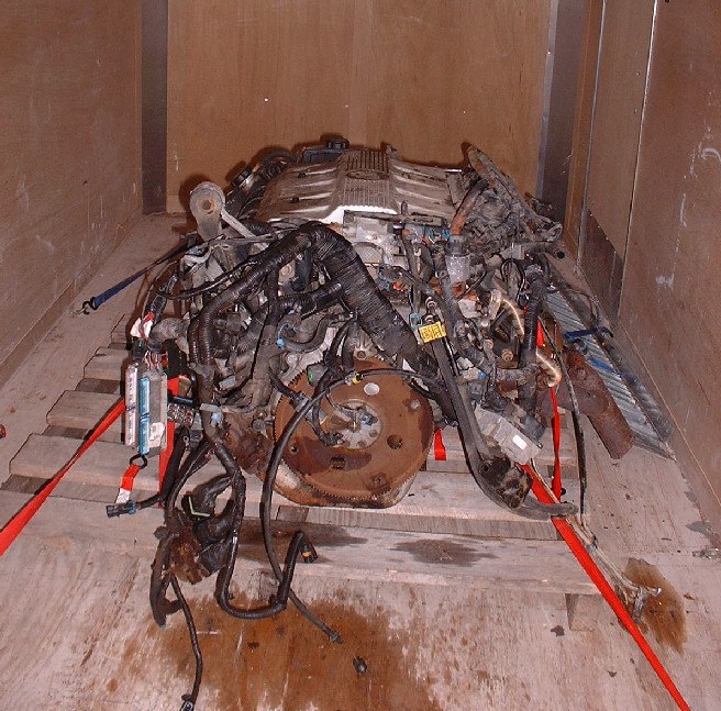

In the end, I bought two '97 VIN Y's, one from a car in a local yard with 250K kms on it, and one on eBay from Ontario that had 100K kms on it (yeah right!). I bought two because the first one came with anything and everything I wanted for $450 and the eBay one which was supposed to be better was more or less just a long block... no beauty cover, accessories, wiring harness, PCM, MAF, etc for about the same price. In Canada we call it a "two-fer" (two for the price of one). I know that the VIN 9's are the more desireable engines because of the 300 HP output, but I'm OK with 275 HP. Besides, this leaves growth potential!

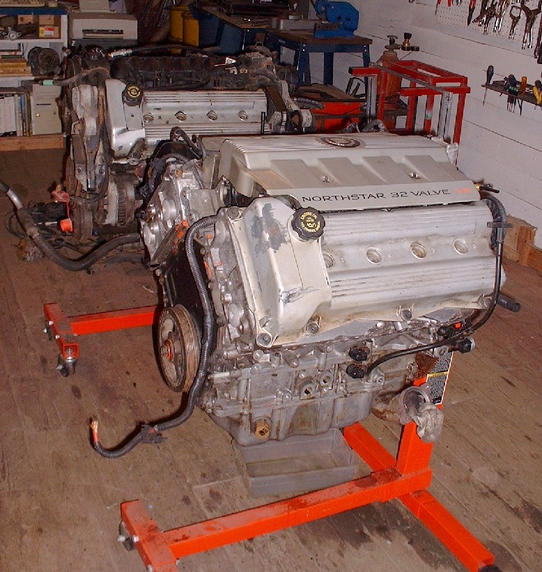

So enough background, here's what they looked like when I picked them up in our trusty-dusty utility trailer and unloaded them in the shop. From the crustiness of both engines, I don't think either Caddy-owner ever cleaned anything except maybe windshield every now and then with the wipers.

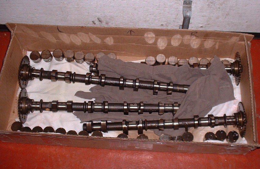

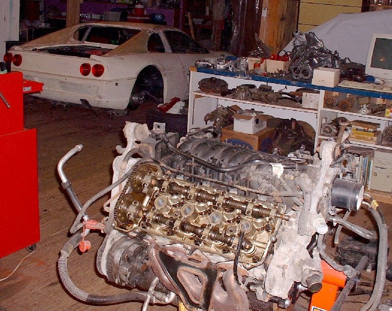

It wasn’t very long after I got my engines that I could hear the lower mileage one calling out “Pick me! Pick me!”. But like any engine builder knows, it’s a good idea to run a few tests to make sure a used engine has the potential to be anything more than an anchor. I like to turn the engine over with a breaker bar at least two full crank revolutions to be sure there aren’t any bent or broken valvetrain parts. If there’s no obvious grinding, seizing, or blockages, then a compression test is in order to get an idea how well the valve and pistons are sealing. At first I was hopeful, it spun the needed 720* and I got 170 psi plus or minus 5 psi on all eight cylinders. That’s right in the range for good static compression for a Northstar. So far so good. Maybe I would avoid the nightmares of some of the other PFF members.
Next up, I cleaned the outside of the engine off so that I wouldn’t contaminate the insides with the crud from the outside. Then I took the valve covers off, and apart from the valvetrain being a little discolored from hot oil, there was no sludge which indicated that the engine probably saw at least semi-regular oil changes. Another thing I learned from AJxtcman was to look for a fine metallic deposit built up on the inside of the valve covers in the area of the sprockets. I forget what the source of it is, but in any case it’s not a good sign if you have it. Mine didn’t… whew!
What it did have though was worn out exhaust cams. This was my first clue that I’d been “had” by the eBay seller. 100K kms doesn’t make flat spots on the nose of your cam lobes. (I could’ve sworn I took close-up pictures of those so I’ll post them later when I find them). Closer inspection of the cam followers also revealed that some of them had the tell-tale wear circles in the middle where the case-hardening had worn through to the softer underlying metal. Cha-ching!… I could hear the cash register at my local machine shop ringing already.

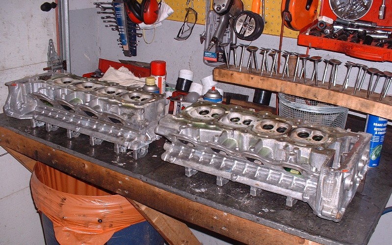

I had decided from the get-go that I was going to do the Timesert repair whether it needed it or not, so I went ahead, removed the heads and dropped them off at my favorite cylinder head shop (that’s all he does) for an in depth inspection and rebuild estimate... keeping my fingers crossed.
