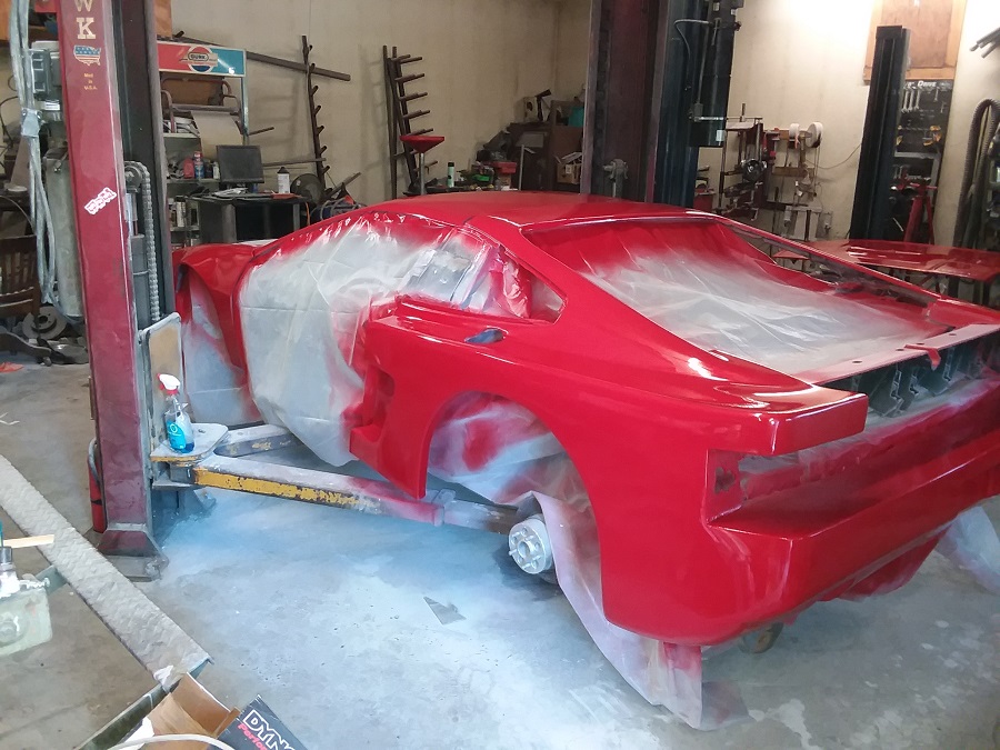

ok i made myself work on it and i am just about done sanding just the roof is giving me a bit of trouble but i think i have it i just need to let it all dry good then i can finish off the roof and sand the lower rear bumper and a few places on the front bumper
engine man
JUN 08, 07:31 PM
I went back for a hour to finish sanding and i have picked it over enough so i will shoot some paint on tomorrow
engine man
JUN 09, 02:30 PM

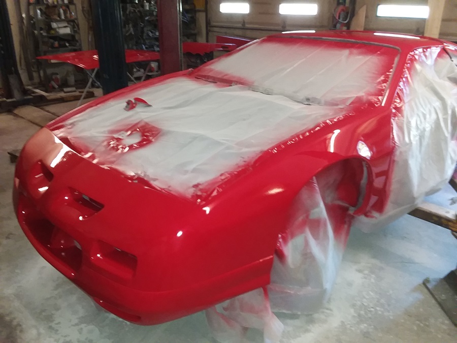

ok today i painted it and i can see some things but oh well it is painted now and i have found out the value of a good spray gun as the Devilbiss copy i bought on ebay sprayed great compared to the other guns i have and use the spray pattern is even and unified
engine man
JUN 10, 03:10 PM

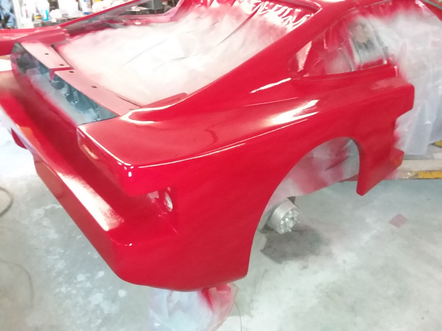

well sanded a spot with some 1500 grit to get rid of the small overspray and orange peel then buffed it shines nice but i think i need 1 to 2 more coats of clear so i am going to wet sand it all then clear again then wet sand and buff for a liquid like shine [This message has been edited by engine man (edited 06-10-2019).]

Damn that looks good! Its totally an obsession! I knew id burn out on mine after I kept finding millions of tiny little defects to fix on the body, and I went on to other stuff. Take a break and get your other stuff done, cars pretty much done man!

yup shemdogg i am obsessed as i woke up at 3:30 am and was thinking about the car and how i have the spray gun adjusted and just can't stand it and will drive me crazy until i get it right

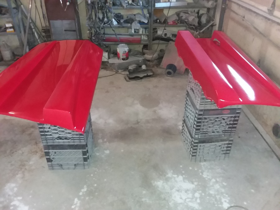

i have the trunk lid ,hood & door skins all sanded i did sand through a few edges so i need to do some painting on them but no big deal and i picked up some work lights on a tripod as i was having a hard time seeing how wet i was laing the clear on or should i say how dry
engine man
JUN 13, 07:57 PM
ok today i cleared the trunk lid , hood & door skins and am learning the spray gun and have it adjusted better but i need to move faster or slow the flow down as i did get a run in the door skin but i did get a great shine so now i must sand the rest of the car and spray more clear [This message has been edited by engine man (edited 06-13-2019).]
