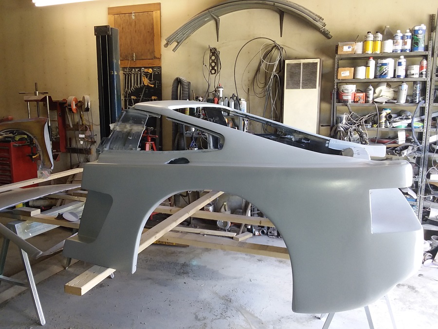

ok today pulled the body off and i still need just a few small things to do then spay it with the primer it is not perfect but i want to get it back together as i need to move on to other projects like my house

ok today i went back over and did a bit of block sanding on the tops of the rear quarter panels and i used some guide coat then i broke the top off the can drooped it on the ground but any way after sanding it is flat just gotta get some more guide coat [This message has been edited by engine man (edited 05-19-2019).]

i have decided i am going to drape a plastic sheet over the chassis then put the body back on minus door skins hood and trunk and do the rest of the bodywork and paint because i think that will work better for me because the body is moving around when i try to sand and it will be easier to do this instead of putting the body on and sand it then take it off to paint it and all i have to do in the end is pull the plastic sheet off and bolt the body on [This message has been edited by engine man (edited 05-19-2019).]

today on my spare time i got the deck lid block sanded now it is nice and flat now to get the rest of it that nice

every time i work on the body i seem to find more that i need to repair or make look right thank god it is only small stuff now so i am gaining we will see what it looks like tomorrow after sanding if i think it looks like i can spray the last coats of primer i will then monday i will wet sand with 600 grit and maybe spray it with color

i went back over to the shop and spent 2 hours on the car it just amazes me how i can sand it and find little nicks and divots i have to fill so i will be back at it tomorrow and get it closer as i know someday i will get to really paint it

well i went over today and i lust have a few spots of spot putty to sand then i will put more primer on so it is all the same color wetsand it all then lay paint on it it is looking straight and flat now i need to do a good job laying the paint on
