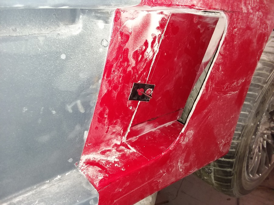

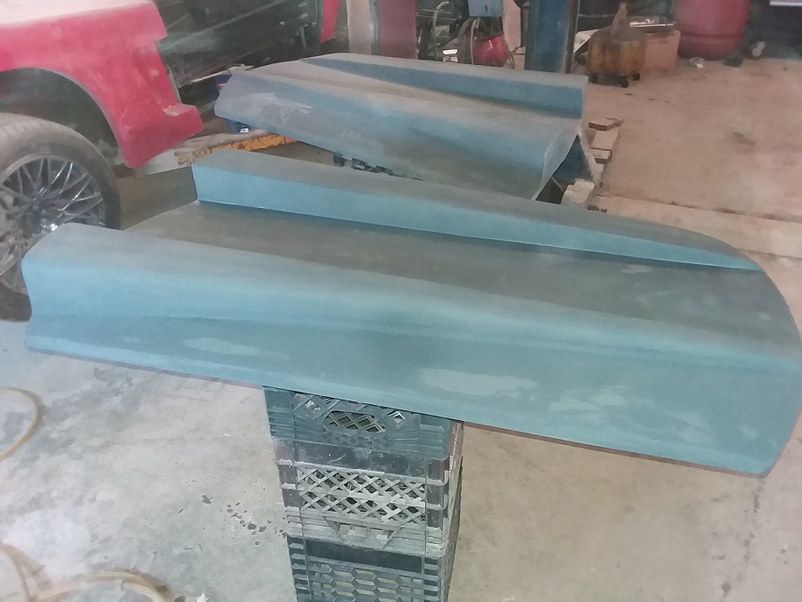

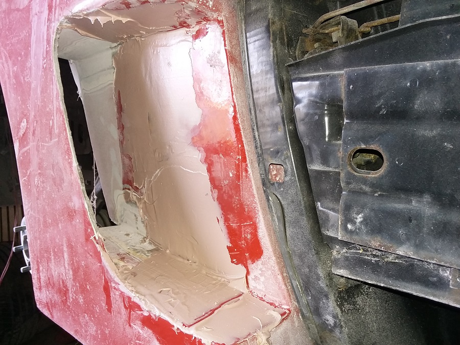

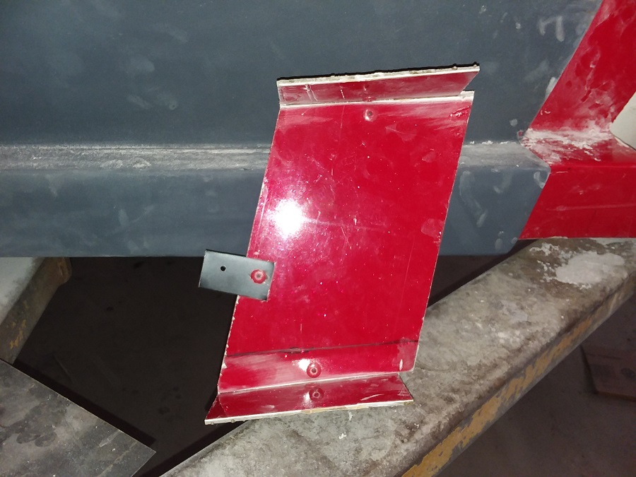

Today i started to work on the quarter scoop area and it is coming along good as i am making some scoop pieces out of some flat fiberglass from the old trunk lid
engine man APR 07, 11:45 AM

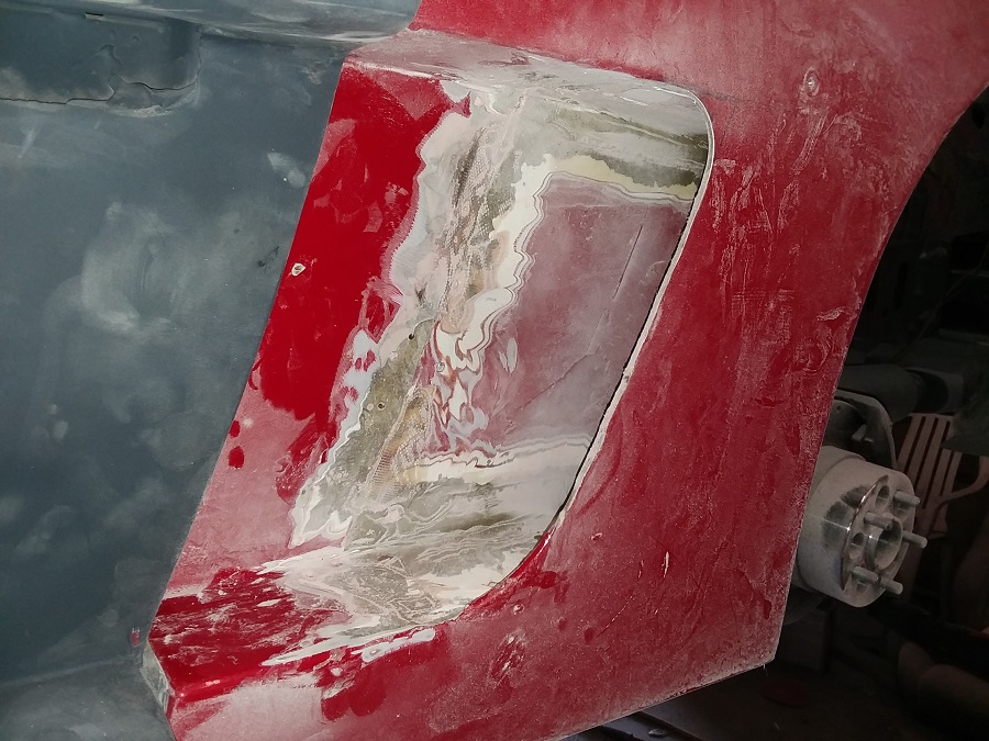

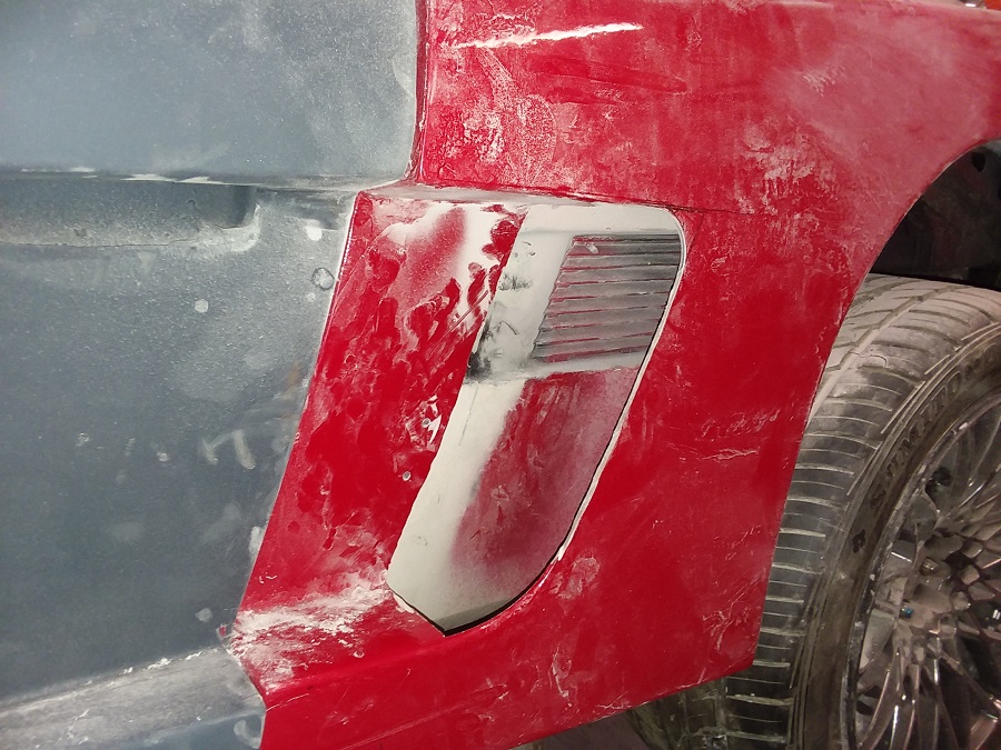

i took a few pictures of what i am doing in the scoop area as i need to do all the fiberglass / body work to make them look like this is the way it came . the pictures show what i made and the scoop without it and with it .
shemdogg APR 08, 01:00 AM
Thats definitely looking way better, maybe too deep tho? Are you going to put a grille back there, or do the fins start way back there? I know its a real pain in the arse but the time spent now on the little things makes a yuuge difference. Your cars looking awesome

engine man APR 08, 11:40 AM
yes i will be putting a grill in it

engine man APR 13, 04:46 PM

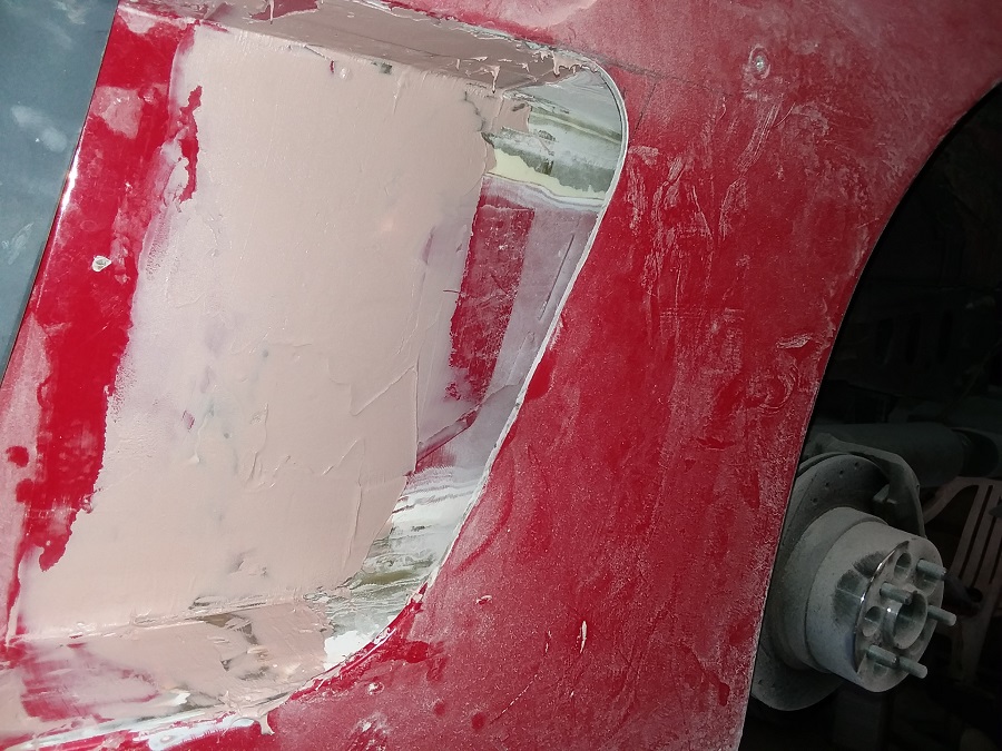

worked on the scoop area today i fiberglassed it and put the body filler first coat i will sand it and repeat the filler and sanding

engine man APR 15, 11:16 AM
when you have to hand sand in tight areas it makes you better at applying body filler so you don't have to do as much sanding
