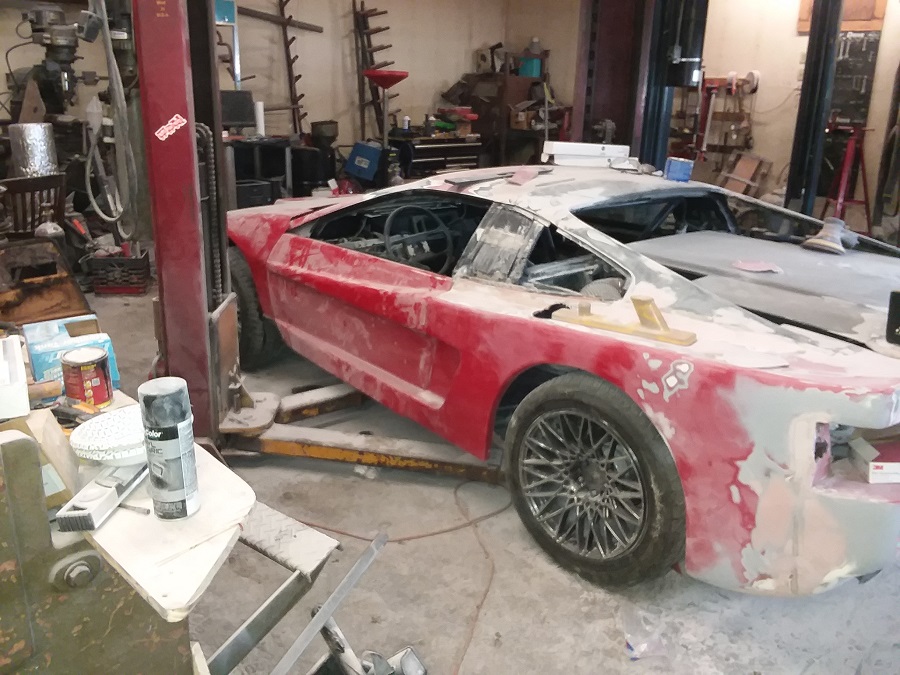

things are coming along fine just taking my time trying to do the best i can i am not sure if it will be a few weeks or a month before it gets sprayed with primer so i will just keep working hard on it and the rear deck lid is ready for primer . the rear body section is the part that i see taking the most time due to so much was done there the hood is repaired so that is just sand and spot prime the repair spot the front end and fenders need a small amount of work and then sand it all the front roof section just needs sanding door skins need bonding to fiero door skins and grinding , filling & blending edges so as you can see there are some things that will go quickly and some that will take time

tomorrow i will get the doors all prepped so i can bond the fiero door skins to the kit car door skins as you can see they are fit and just need bonding they are riveted on right now

Roof , Hood , Trunk lid & complete front end just need to be da with 220 then 320 primed and wet sanded and that's fine in my dusty shop but color and clear i am not sure what i am going to do because i do not want the dust and dirt in the final paint job
