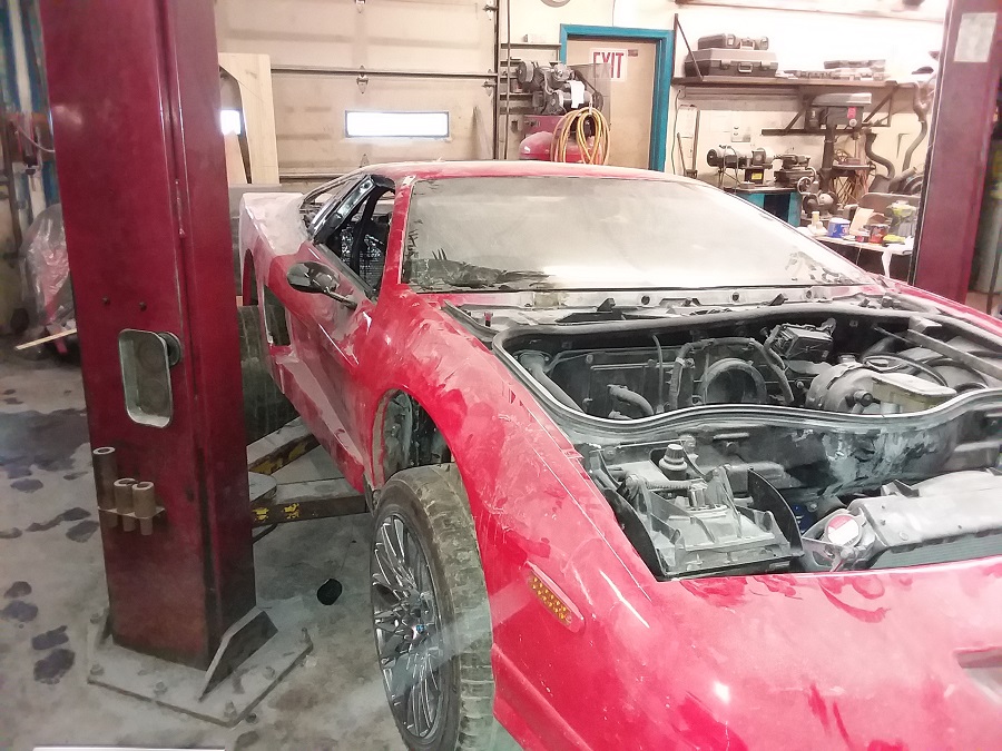

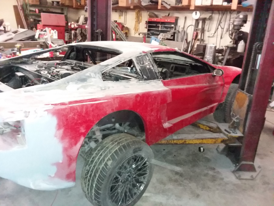

Sometimes you just need to mock it up so you can get motivated and it worked for me as in my opinion this is gonna be a sick looking car if i can do a good job at finishing it up
engine man
FEB 23, 04:39 PM

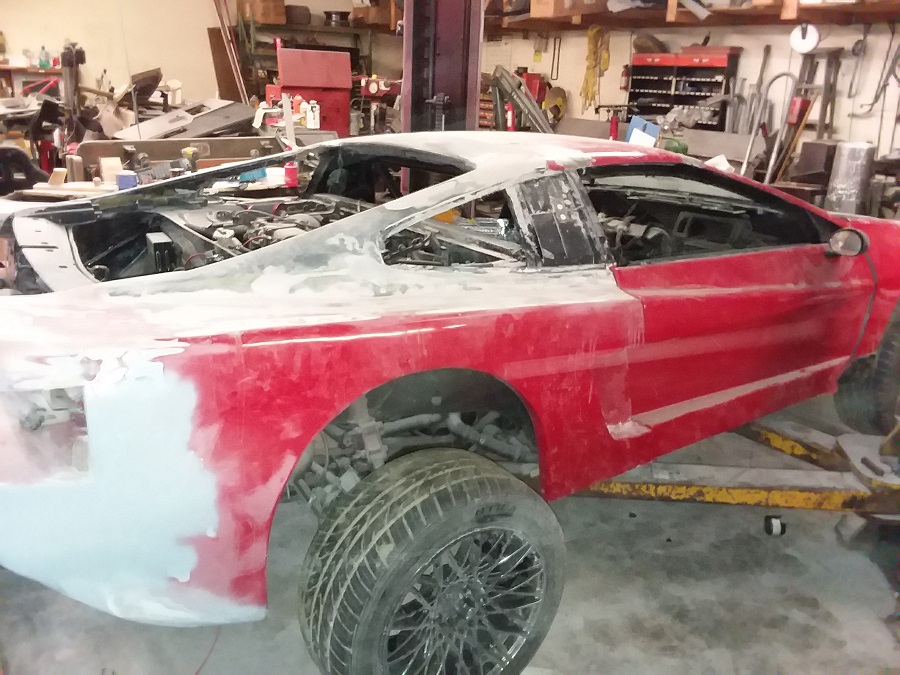

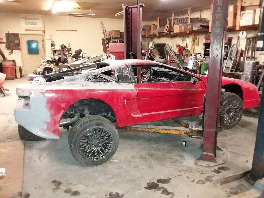

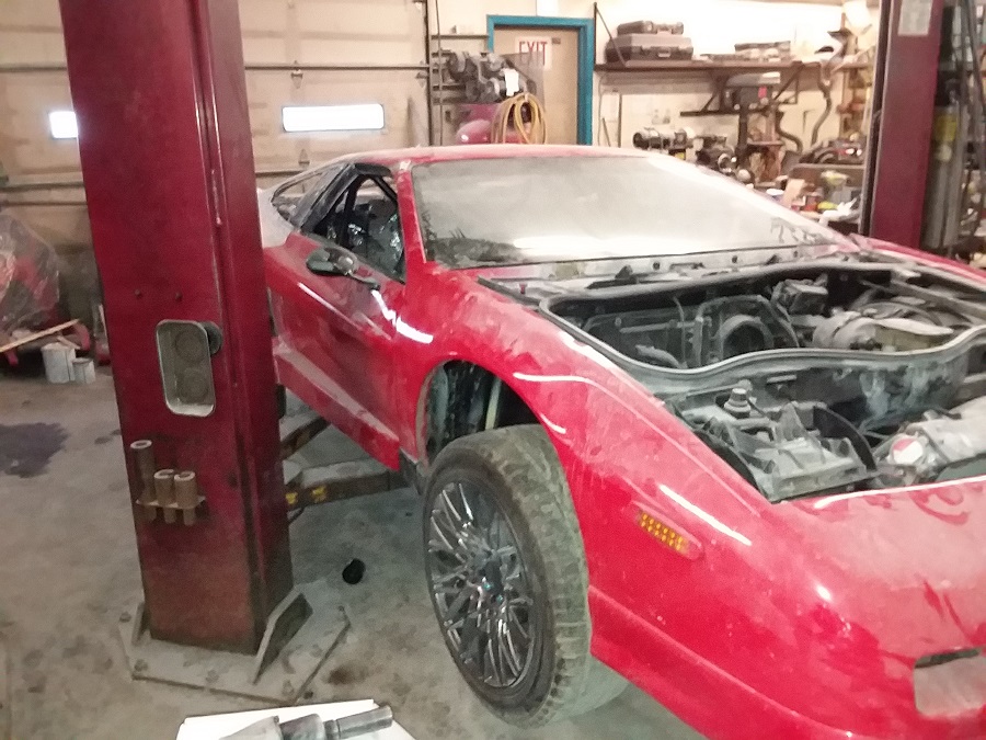

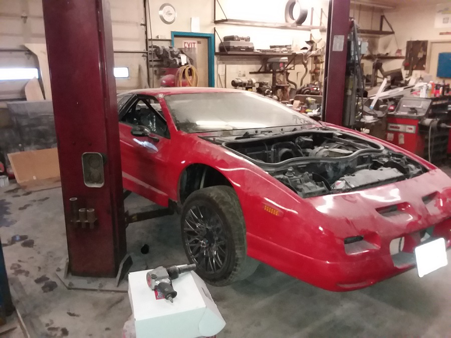

where the car started last october before i decided to chop the top and where I am trying to go and where it is right now
Spadesluck
FEB 24, 03:08 AM
Out of curiosity what type of bondo are you using ?
engine man
FEB 24, 08:54 AM
bondo brand is the filler but everything is attached with fiberglass epoxy resin and fiberglass cloth you just need to make sure you get the paint off and a good 80 grit rough surface for the filler to grip it and in the end you can go over it with a coat of a premium bondo it is gold and higher quality and i think it is SMC compatible [This message has been edited by engine man (edited 02-24-2019).]

Damn thats looking good youre almost there. Def digging the fastback sail panels that looks schweet!
shem
engine man
FEB 24, 01:43 PM
Thanks shem i to think that using the GT fastback was a good move and looks better than what the kit car body had and doing the choptop made it better in my opinion
